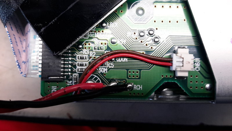

    You can try removing some of the green film material covering the conductive path of the L and R connection. Just trace the line back to a convenient spot and scratch off the green film then solder directly to that.

    Ok Ill give it a go. I ordered a single din dash kit anyway cause if this doesn't work ill be getting a aftermarket stereo. I just like the stock look. Thanks

    Gave up and just did this. My First TACO mod!!

    I took a chance and did this on my 06 Sequoia JBL 6 disk player with some really rusty sub par soldering skills... in case anyone's wondering it works exactly the same as the OP... just find those output joints on the CD part of the assemble and tap in. Very cool solution to an overrated design. Thanks to everyone who posted! IMG_0529.jpgIMG_0530.jpg

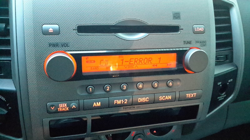

    I did this mod yesterday and have zero sound coming out of it.... not even any static,
    followed this 100% and used the same jack listed above. I tried multiple grounding locations as well.
    When i put a disc in i get error1 flashing. It wont play the disc either.
    What could cause this?

    Got it working. Opened the top and the cd loaded correctly and no more error1 message. Finally a aux source!
