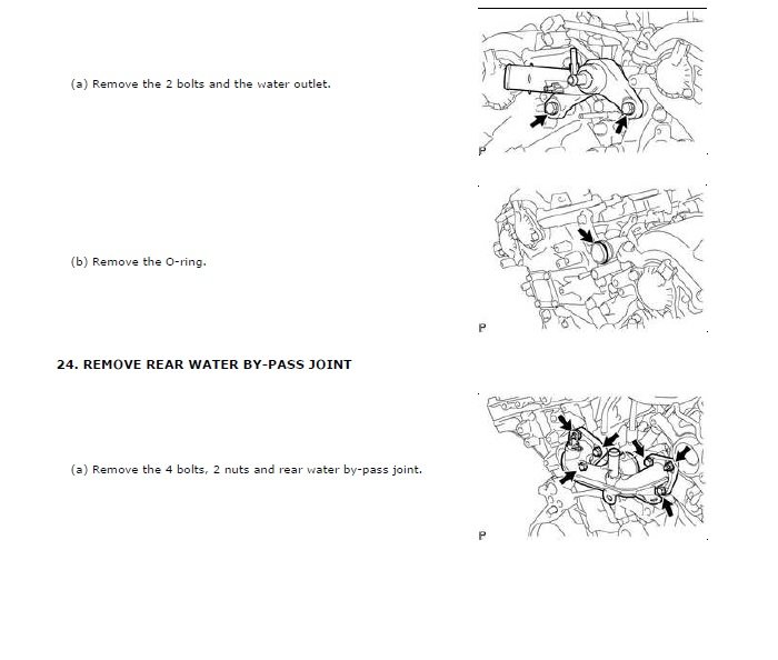

    FWIW, it looks like Toyota calls it the "rear water by-pass joint".
