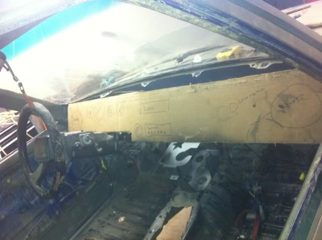

    For battery placement. Still not sure, did start making a dash template. Need to get some sheet metal to make it out of and make a template for the top as well.

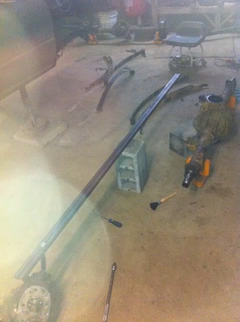

    Thanks man, might as well give an update. Really haven't worked on it in a while, haven't had anytime between work and school. Did pick up about 20 ft of 2x4 square tubing today for crossmembers and sliders.

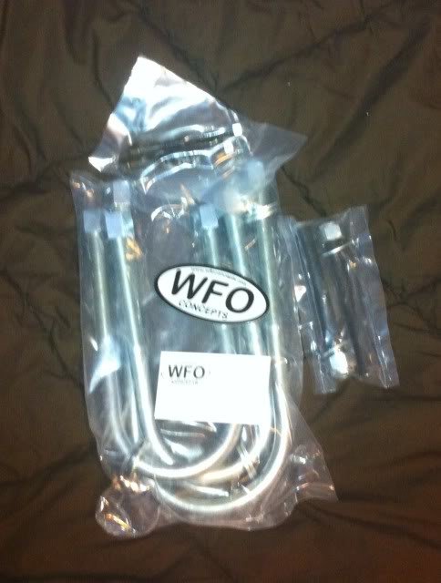

    Ordered ubolts and studs and new leaf spring center pins from WFO concepts and should be picking up my u bolt plate I'm having Chris at MarFab cut out for me later this week. Couple more weeks and it will have jackstands under the axles and not the frame:D

    Stuff from WFO concepts came in today, my Ruffstuff should be here tomorrow and my slider boxes should ship tomorrow:D

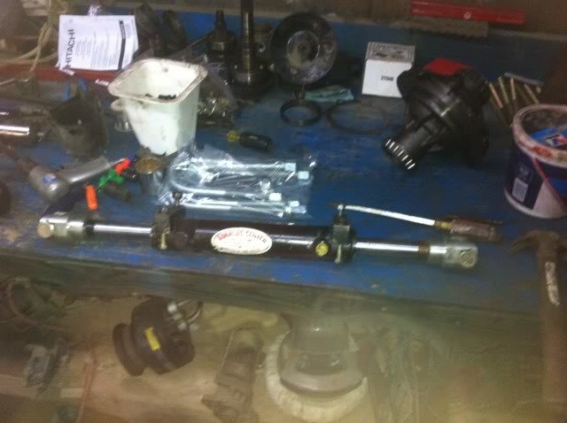

    Also picked up a 2x8 dual ended ram with psc clevis ends the other day, no pics of that though. Also might have a lead on an orbital too:cool:

    Sry for the shitty pics, the ram I picked up with psc clevis ends
