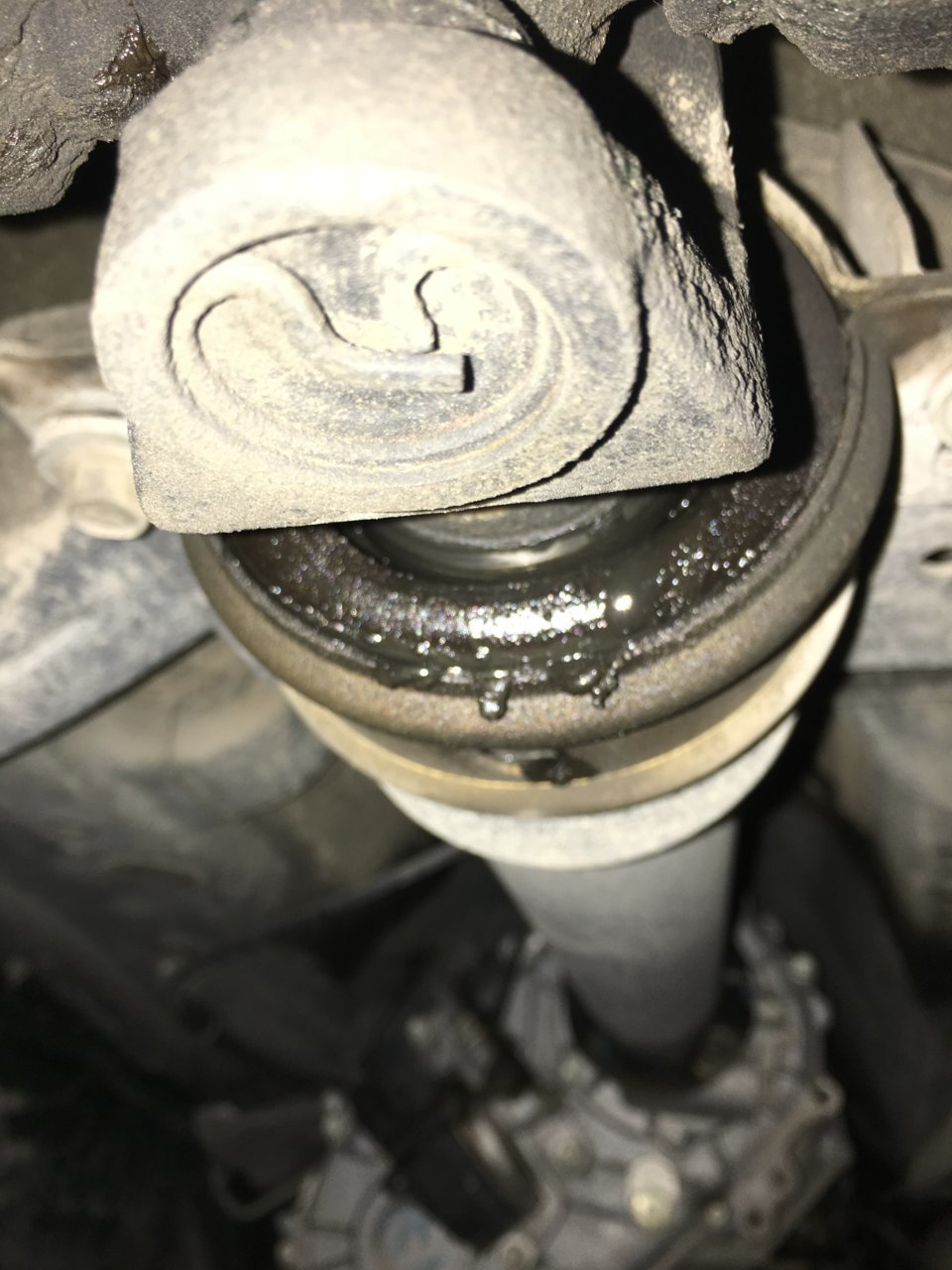

    So this is my 2nd carrier bearing but it’s not OEM. It’s an Autozone one. I was under the truck today and noticed the grease leaking. There’s about 1/2 play also. Would this be a source of the start and stop cluck I have been getting the last few months? I thought I had it resolved with replacing the tranny mount. I’m spending $$$ on an original OEM next time.

    From the photo you posted initially it looks like that AutoZone carrier bearing you have definitely shit the bed, so replacing it with the OEM one should take care of that issue. Clunking in the driveline is a primary characteristic of a failed/failing carrier bearing.
    Its also characteristic of bad u-joints, so if the clunking persists even after the new CB install then I'd look there
