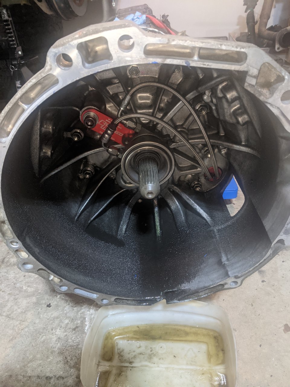

    Yup, that's brake fluid.
    Leaking from the seal.

    Is it leaking through the rubber gasket this kit comes with?

    Yup, through the bearing piston seal. It's a proper lip seal and not an O-ring at least.
    All fittings were tight and leak free.

    Wonder if that lip seal could be replaced with another one of better quality and fitment? One that is more wide @TodayWasTHeDaY
    I’m just brainstorming cause I got a stage 3 clutch and light flywheel ready to go with this clutch master throwout bearing.
    And I’m hesitating to do this now. Which sucks cause my current clutch is slipping :frusty:

    It's a possibility I guess but it'll be a pain in the ass if it the seal doesn't hold.
    I'm kind of thinking that the Canadian winter didn't help things either. Pulling the trans is enough of a job that I don't want to gamble on the thing pissing it's juice out again in such a short time frame and I don't trust it. Just glad I wasn't stranded and needing a tow.
