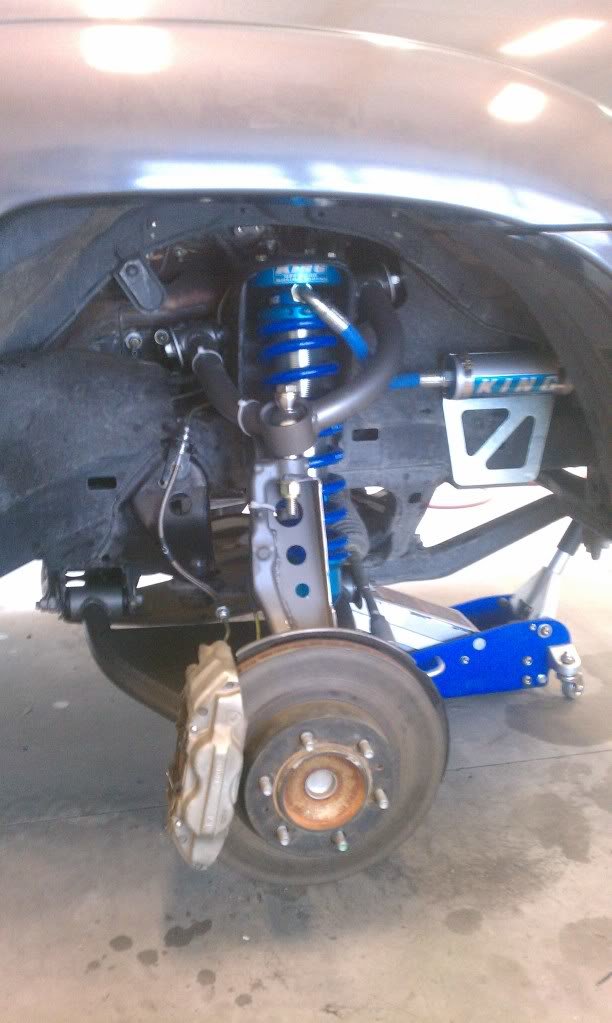

    I am in the market for coilovers with resi. Either fox or king. will be purchasing them used if I can come across some. I have an 05 prerunner. will a 10inch coilover fit? bolt on?
    Im just really not sure what im looking for.

    NO way. They make an oem bolt in version. Unless you are going to use a LT kit then that is all you can run and you will have to get aftermarket uppers also.
    These are extended oem style from kings

    how big is that coil over?
    thats exactly what im looking for, what exactly is it?

    fox extended travel remote resivoir coilovers, 14" eibach 600lb coils, All Pro tubular chromoly 1" uniball upper control arms, All Pro expedition leaf packs, 10" bilstein 5150 piggyback reservoir shocks 265/75r16 Goodyear wrangler MT/R kevlars wrapped around 16" Helo 791 gloss black, Mini H1 retrofits with 6000k bulbs, 18" magnaflow w/custom exhaust reroute various decals, Sockmonkey retro hood stripes
    "extended" means a little over 6", like 6.5" or so
    anything more and it won't be a simple "bolt on" with the stock shock tower

    It's 2.5 body. I think they use an 8" body for basically a 6" shock. I think the specific measurement for stroke length is 5.5". Collapsed they are 16.7" and extended they are 22". Close to those numbers. The only way to use something longer is a full LT kit.
