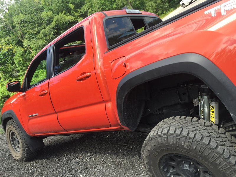

    ADS also makes extended travle that roughly measures (with my tape measure) 22.5 w/ 5" of travel and they are built with race performance parts not high production cheap off the shelf stuff.
    Oh, and they build some saweet rear shocks too.

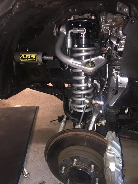

    Do u have top plate spacers with the OMEs and what spring are u running? I had 885 with .5" top plate on both and they topped out all the f'n time. I should of got 884. The top plate shouldn't make much of a difference in ride but it gives u almost the same drop as extended COs. Lower the spring size and add a .5" top plate.
    I ended up going with ADS (Awesome Damn Shocks :D) extended travle COs and it's been night and day. U get what u pay for.
