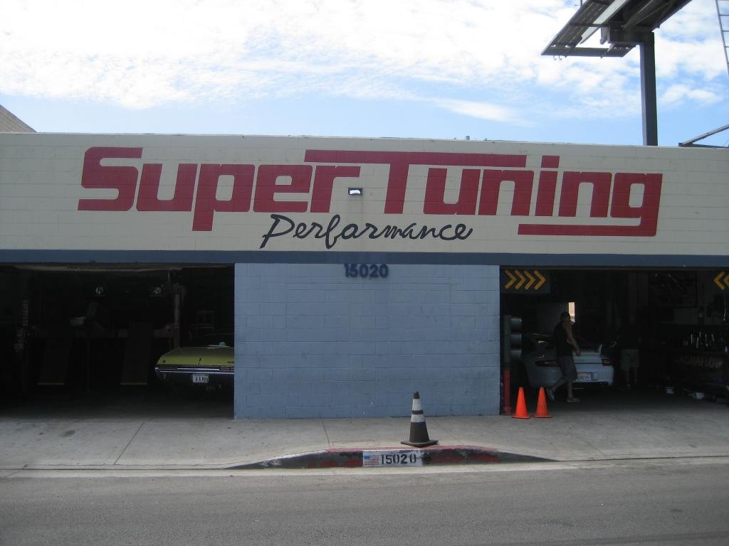

    You can't throw them on my truck because my engine only holds one! :laugh:
    Sure, I'll offer my truck to be used as a test bed as long as it's done at HK Motorsports Dyno Shop in Van Nuys, it's done on Saturday because of work, and I don't pay for the dyno. ;)
    We can swap headers at my house when everything is cold. The truck will need to be driven around some so that the ECU can relearn the new parameters. Then it's off to Harry's for testing as he's only about 12 miles away. We'll use my runs with both the header and intake manifold spacer for comparison so I don't have to remove the spacer. The only rub is that since the last runs, I've removed the stock exhaust and installed a custom MagnaFlow cat back. So that is likely to skew the results. But if you guys are up for it, I am. :)
    I have another broader question that gets to the heart of the matter:
    Since you're considering their header, why not ask Doug Thorley to release their own dyno tests for their own header?
    It's impossible for them to design and build products without logging before and after dyno runs. I chose LCE because I'm old school where long tubes always trump shorties on low end torque, while shorties make more top end horsepower. Just something to consider... :)
    Greg
