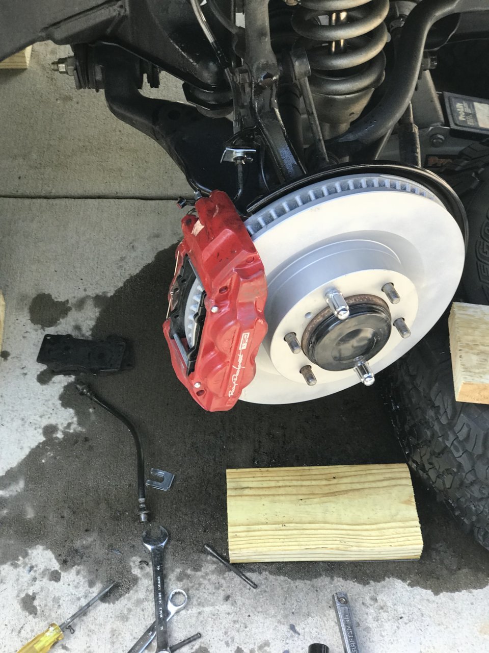

    Just completed this upgrade. Thanks for the tips. Time consuming but otherwise not too bad!
    I did make the mistake of spraying some brake clean on the inside of the hub and some grease came out of bearing... hopefully not a problem but would love an opinion.
    Otherwise here is the finished product:
    Centric calipers and stop tech (non slotted/non drilled) rotors, ss lines from low range offroad, stop tech street pads. Stopping power improved - did not quantify. Bought most of it from rock auto. Blinged the calipers.
    Nate87, nudavinci64[OP] and TacoZim like this.
