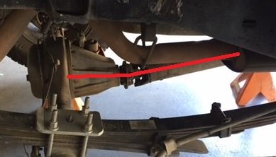

    You just need to reduce the angles but the shims is dependent on the angle. Do you know how the rears are lifted? Blocks? AAL? If it's just AAL, it's usually 1.5 to 2" of lift and I would go 2 degree shims but if it's a 3"+ blocks, I'd do 3 degree. Give Headstrong a call to discuss, they are very helpful.

    1.5 add a leaf I think ... There are pics on this thread

    I legitimately have no angle ... Like maybe slight, but not that I can really tell... Hmmm

    There are easy ways to tell what your angles are and to know if they are right. If they aren't, then you will know exactly where to shim. First read this.
    http://www.4xshaft.com/driveline101.asp
    And then this.
    http://www.4xshaft.com/tech_slopesVSangles.asp
    Then go take some measurements and let us know what you find. :)
