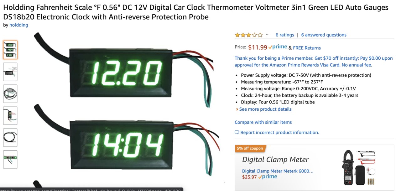

    God I need to update this damn thing, work is kicking my ass. Anyhows here's another mod to add to the list. Saved for later
    Saved for later
