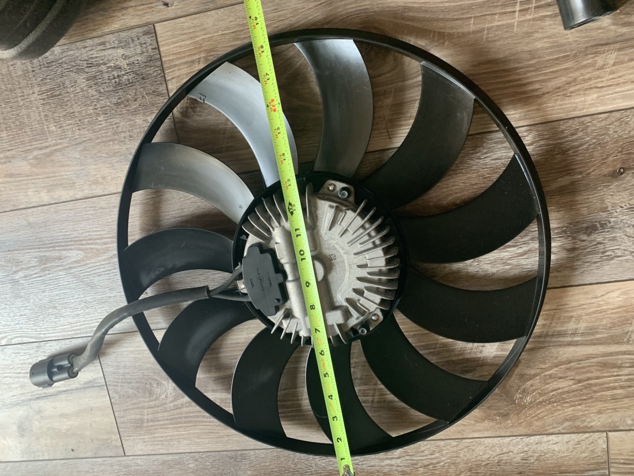

    What size fan is that

    The inside fin to fin is 18” but if you add the outter lip it’s closer to 19”

    Oooo where did you find that part number

    I picked up up off a 18’ Camaro. Not sure what GM part # is, haven’t looked into it. Just waiting on the OE controller module. Are you running it in tandem with the lingenfelter VSFM?

    Its not required with the vsfm module. Spal even says to wire direct to battery with inline fuse.

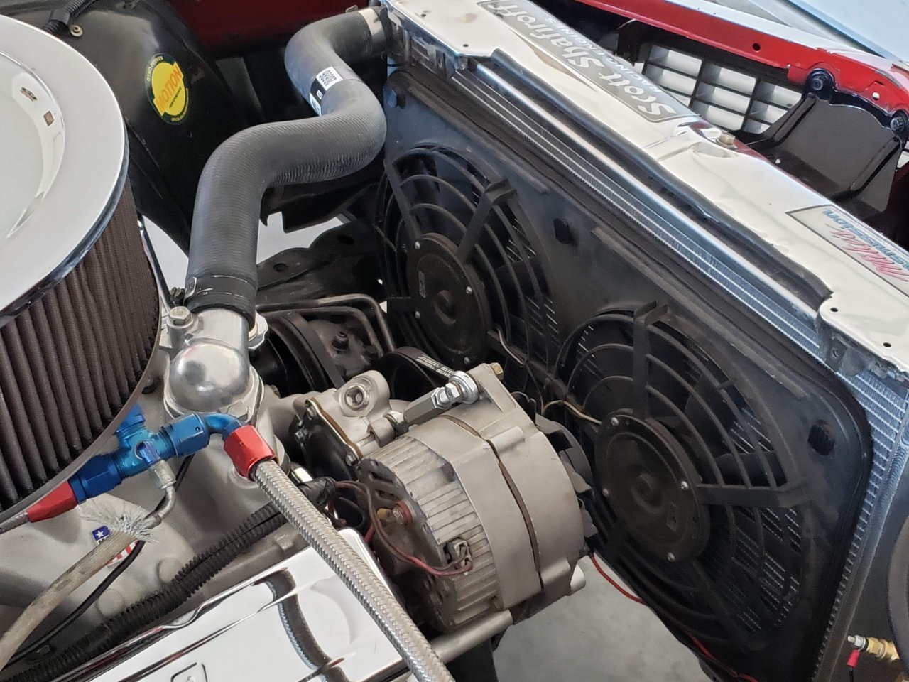

    I'm also running a Flexalite dual electric fan set up with dual 12" 10 blade fans and is part #680 and designed for 1999 - 04 Toyota Tacoma's
    Works very well in my Camaro with a 600 hp 427sbc and keeping temps at just under 195°
    So yes , I'm running a Toyota part on my Chevy
