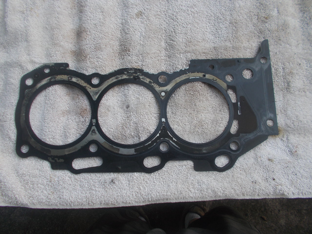

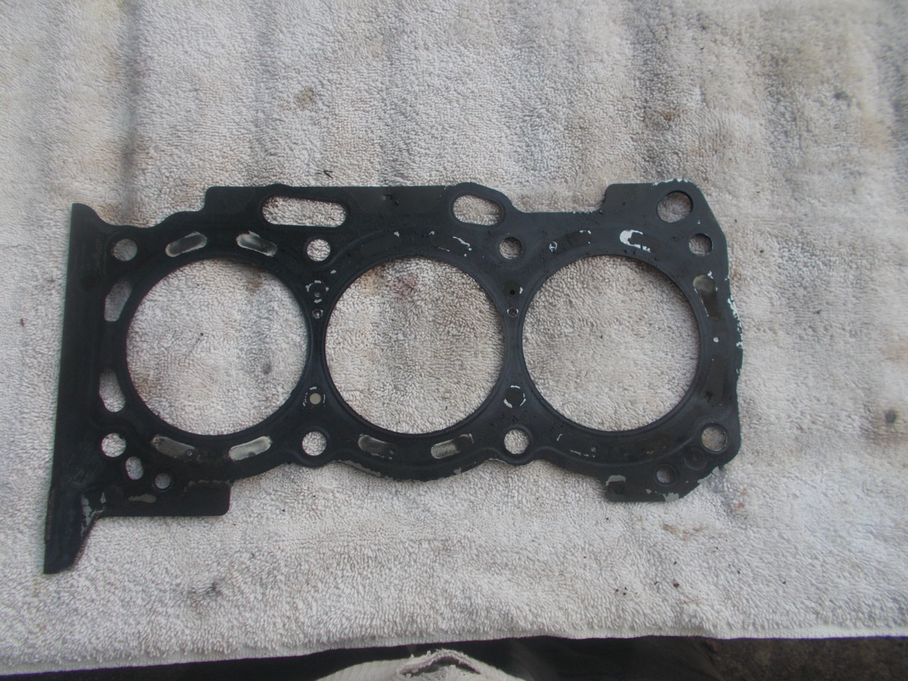

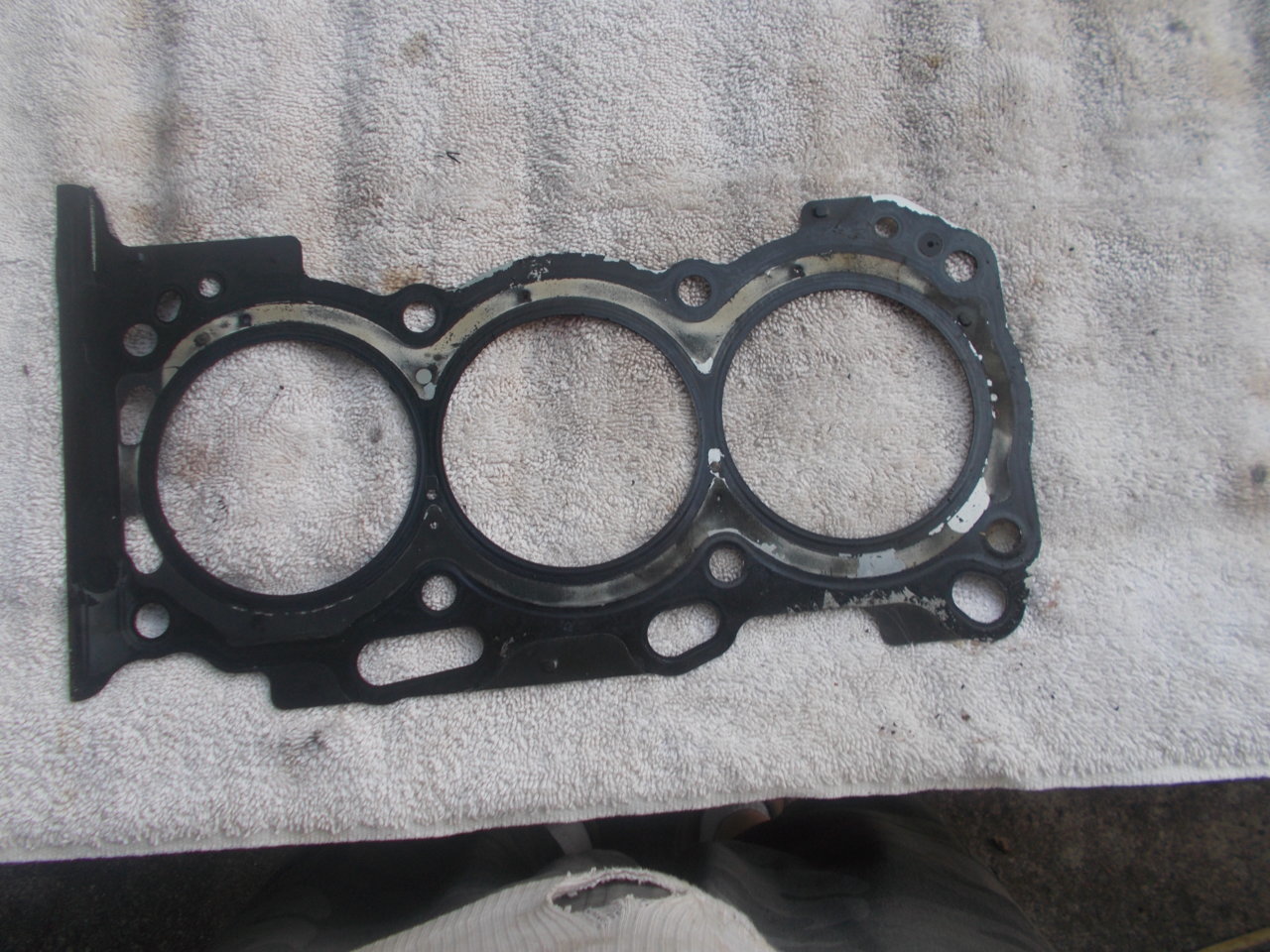

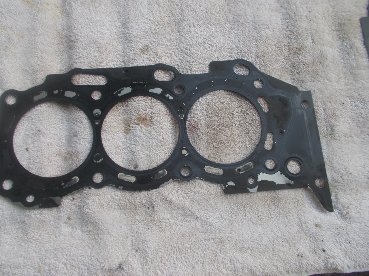

    Were you able to get the pistons to move at all yet? Any pics of both sides of head gaskets? Still need to find source of stuck crank before thinking about machine work. Just my thoughts. I'm no expert but just here to help where I can.

    Not yet on the crank or Pistons. But I don’t try that hard tonight. I can get a pic of the headgasget tomorrow well later today my time lol

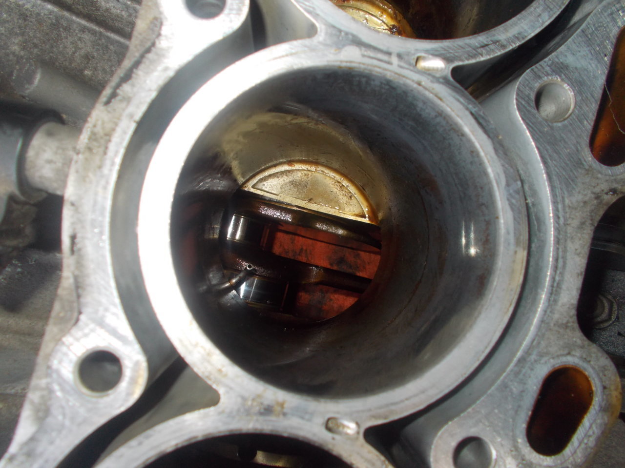

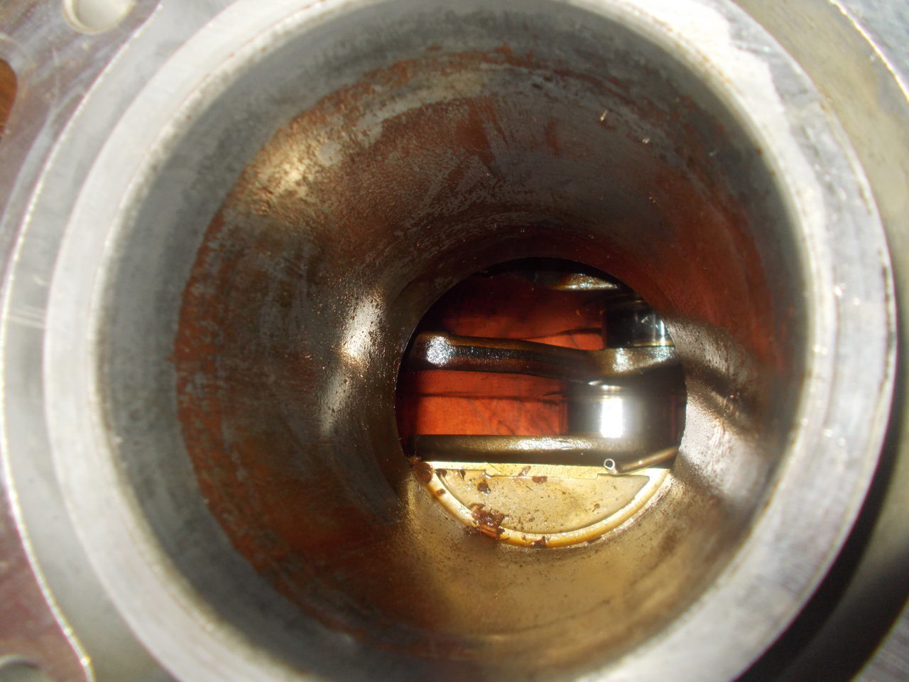

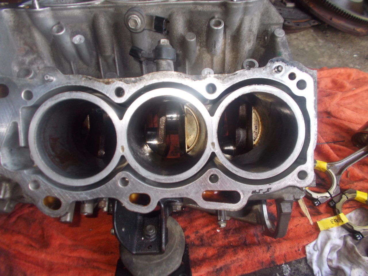

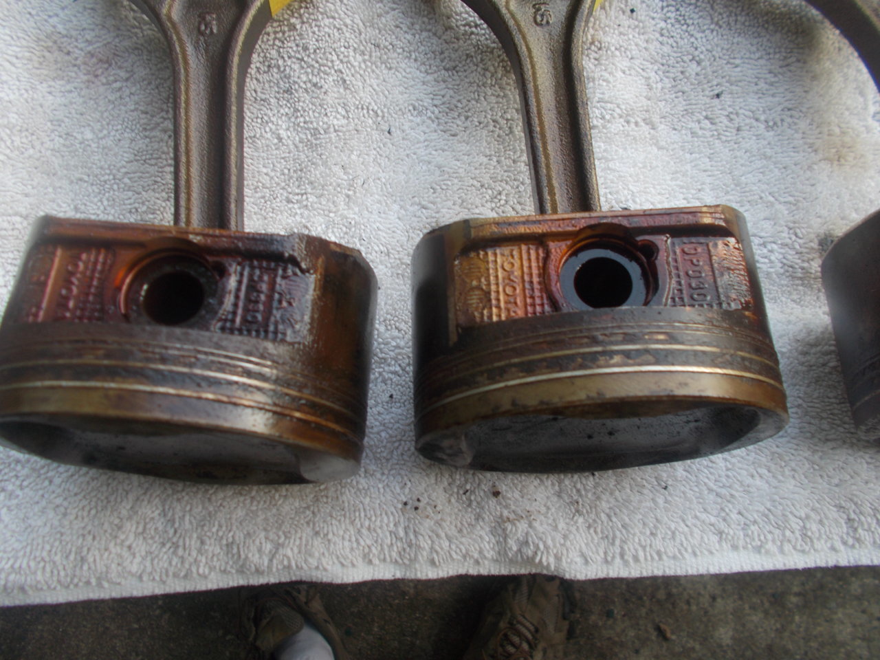

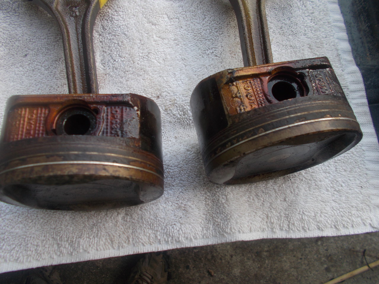

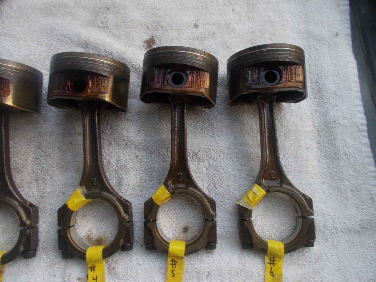

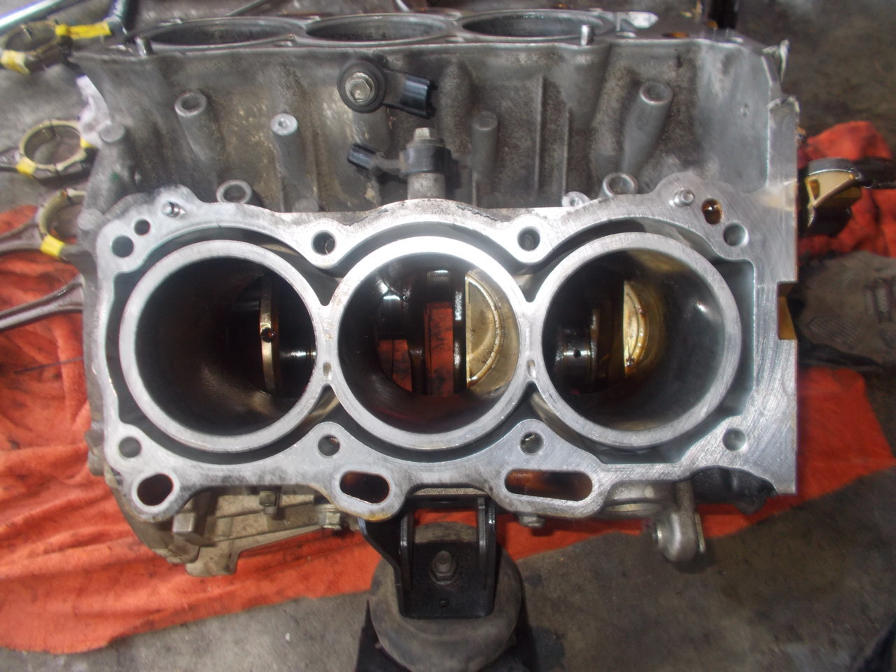

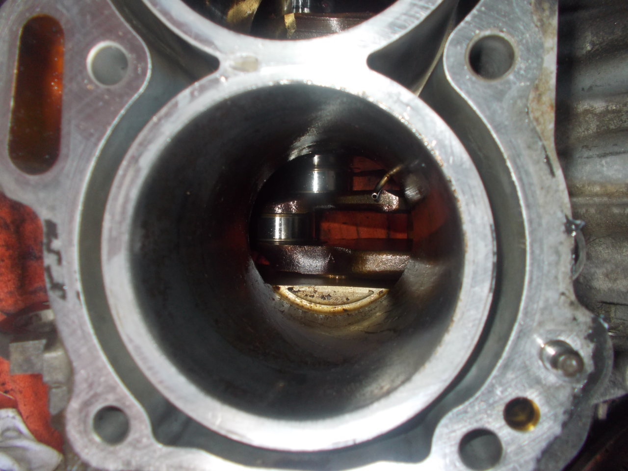

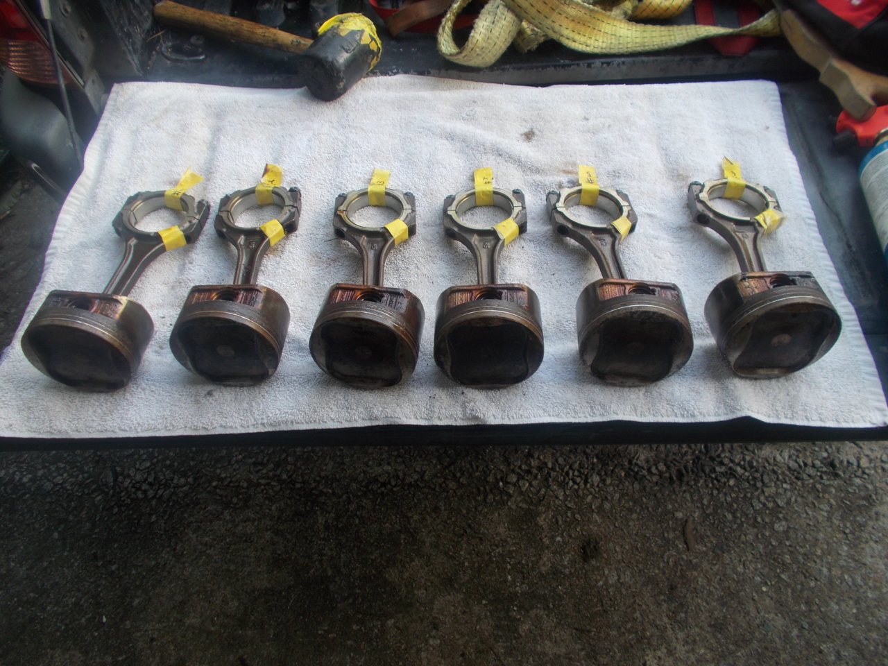

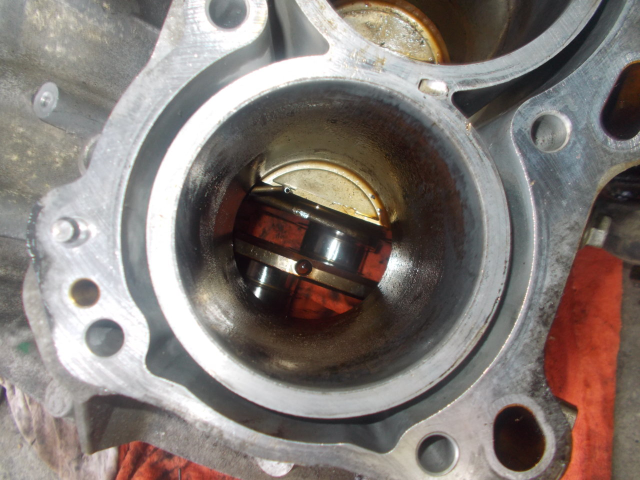

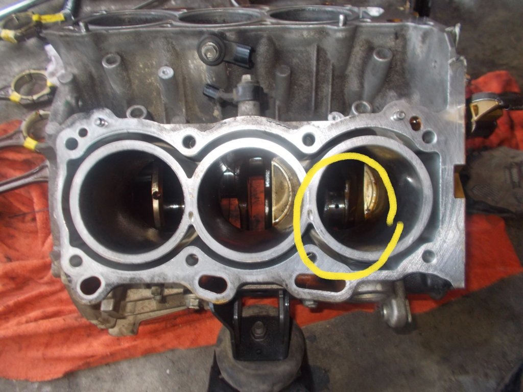

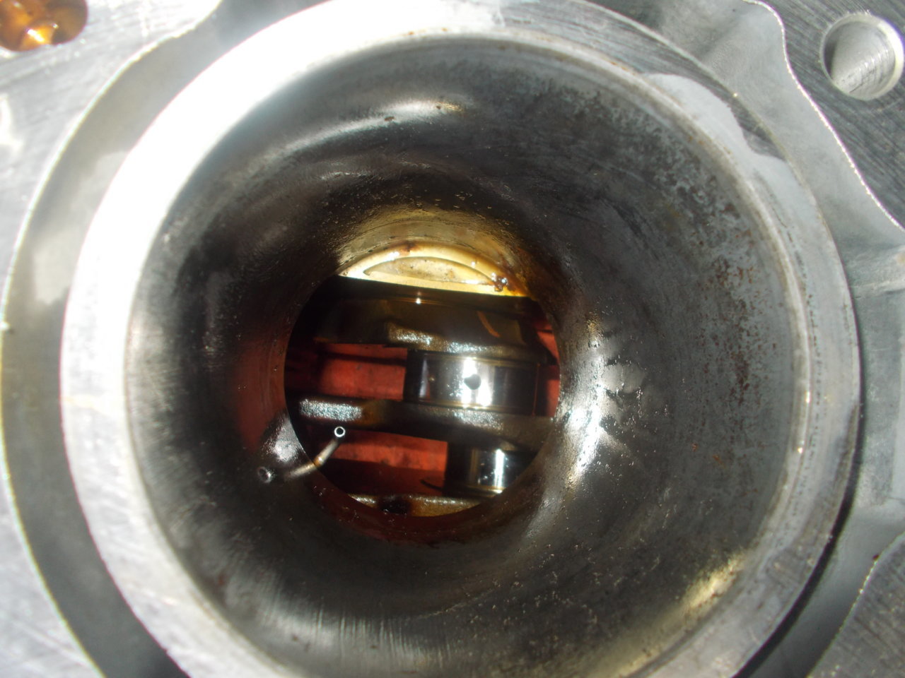

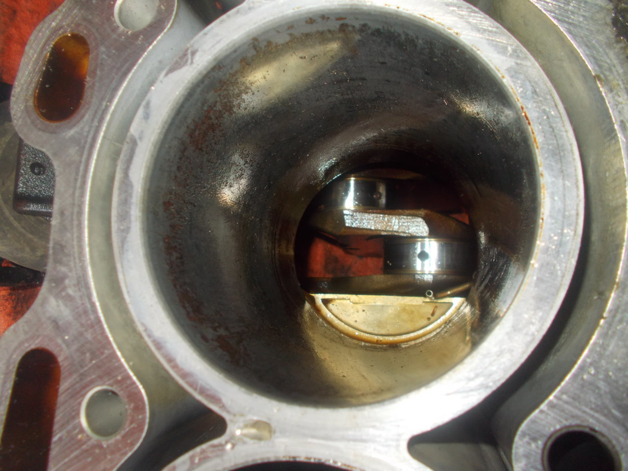

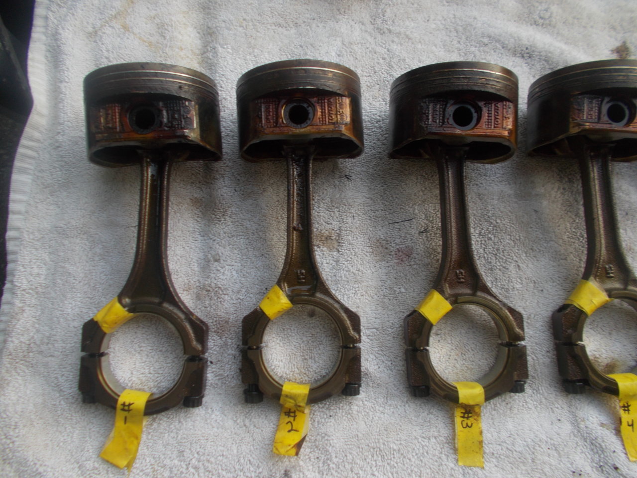

    up date got the pistons out and the crank finally turns.what do you guys think a machine shop can save the block?DSCN0621.jpg DSCN0620.jpg DSCN0619.jpg DSCN0618.jpg DSCN0617.jpg DSCN0616.jpg DSCN0609.jpg DSCN0610.jpg DSCN0611.jpg DSCN0612.jpg DSCN0613.jpg DSCN0614.jpg DSCN0615.jpg DSCN0622.jpg DSCN0623.jpg DSCN0624.jpg DSCN0625.jpg DSCN0626.jpg DSCN0627.jpg

    Is that rust or just crud on the cyl walls?

    Don't see ant obvious head gasket leak. How hard was it to get each piston out? If crank is turning smoothly then it appears the pistons were just hung up on rust ridges? Block looks to be ok with some cleaning but may need to be slightly bored. Depends on how deep rust is or just surface. Good job labeling everything.

    The cylinder liners in these are super thin, you can’t remove much from them. I’d look around and see what used engines you find. Look for an 07 and up, you don’t want to buy an engine and put it in only to need to do head gaskets. Your engine can probably be saved, it’s just a matter of how much work you want to put into it, if you knew it’s history I’d say rebuild it and run it.... but everything being what it is, I’m inclined to say just throw a used engine in there and forget it. The bearings and everything look good, so I doubt it’s been thrashed too hard, you never really know though.

    Hone the cylinder walls, clean the pistons, install some new rings, have the heads rebuilt, reassemble and drive it. Was there any particular piston that was troublesome to come out?

    Not sure if this is just grease or it got hot?

    I think it maybe crud from nocking the piston out.
    I think #2 was the hardes to get out. Got the crank to spin enough once 1-4 where out to get 5&6 to brake free enough to get on the bolts to get them out. now the crank spins just fine
