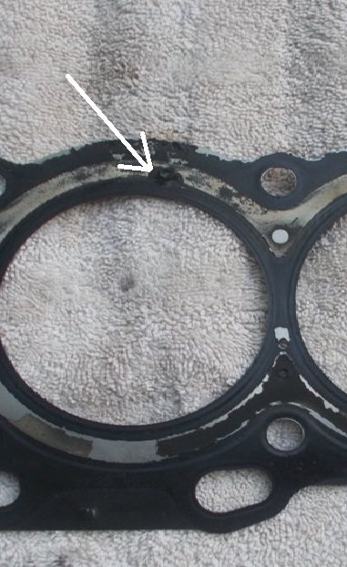

    Cylinders look honable....to me from my house.
    Bring it by a shop, see what they think. If it needs a bore, you;re going to be better off looking for a replacement.
    I doubt any valves need replacing, just the heads redone. Looks like the pistons did all the wearing of the engine's poor life. I see scuffing (heavy) of the teflon on the skirts, some is normal but these were rocking a bit.
    Looks to me like the last pic. of headgaskets had a leak in the middle cylinder.

    Check the fuel source at the fuel rail before putting any engine in this truck. You stated cooling system was full and pistons show no signs of coolant exposure just water exposure.

    at 160K the whole thing needs to be worked over...valve guides seals etc...
    could be ok, just have to micrometer check them, same with the cylinder walls. Im not sure what the max is but some engines can be bored over. if its too out of whack gonna have to find a good used block.
    As for the rust if theres no identifiable leak in the head gasket or cracked head...it got swamped. IE mabye got shut off before it hydrolocked but thats the only way I see ALL of the piston walls to get corroded.

    Looks like you have a big project on your hands. Looking at your pics I'd say it's totally saveable. I used a dnj kit like you linked for my 2tr. All the gaskets looked to be good quality and pistons, rings, and bearings were all in spec.
    Those bores look pretty rough. While it may be possible to hone and have them be ok, I wouldn't. It's likely they would still be bad. You can have it bored and honed .01 over and get those pistons and rings with the kit.
