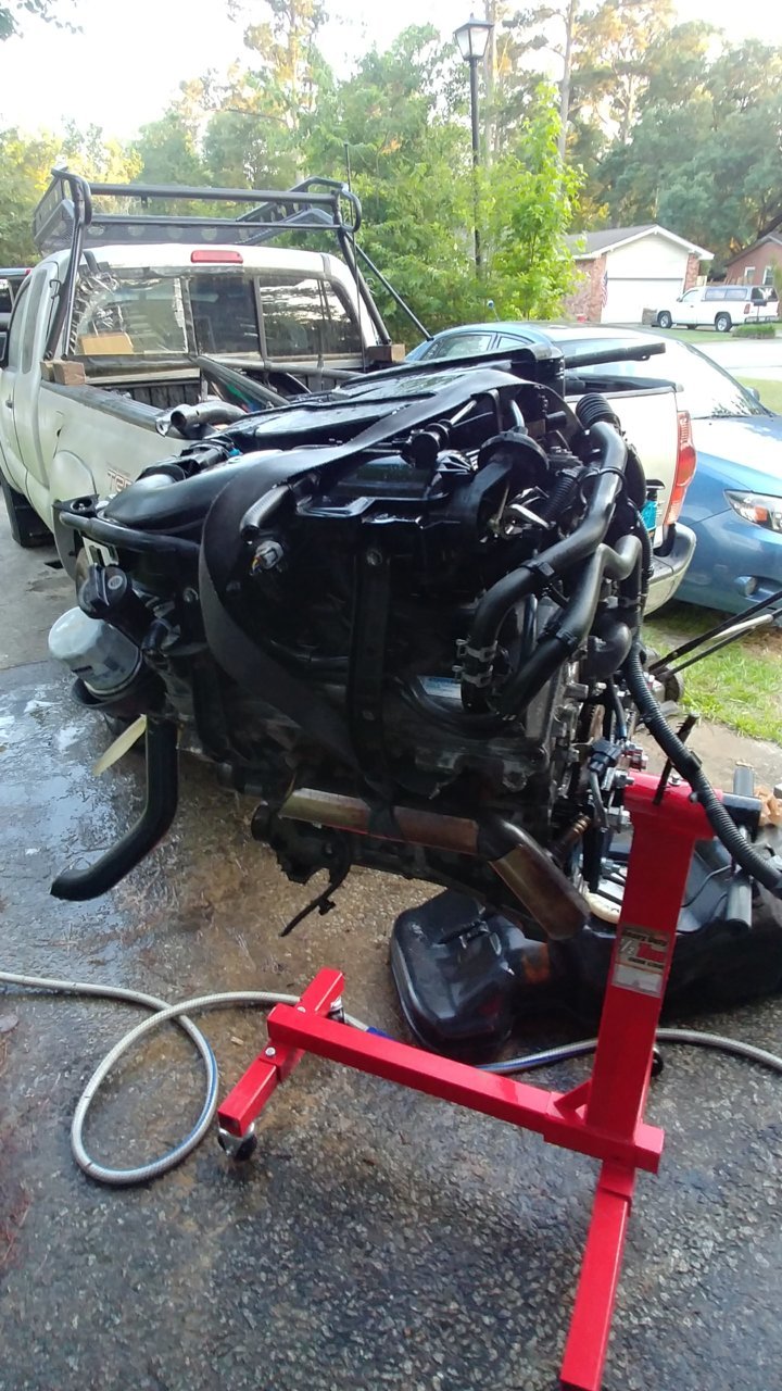

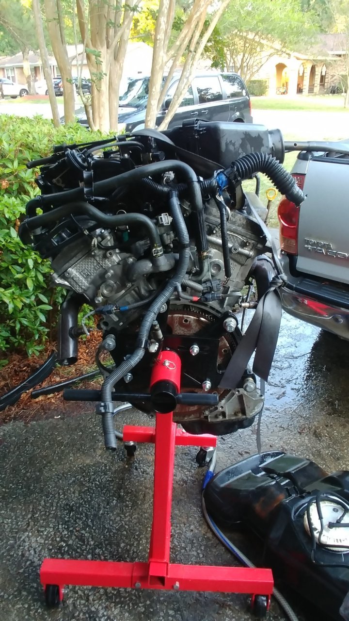

    Sorry I have been away for so long guys. New update I Finally have a motor for the truck.paid $1300 it has 86k miles on it and a 30 day warranty.now to get somethings changed over and in the truck and running in that time frame.0520191939a.jpg 0520191940_HDR.jpg

    Hey, good to hear. Looks clean.
    Is it post '06' head gasket iffyness?
    This will make a nice truck for a long time.

    It came out of a 2005. I know you guys said 05-06 have head problems. But I had to take it. Plus I still have my 07 motor as parts

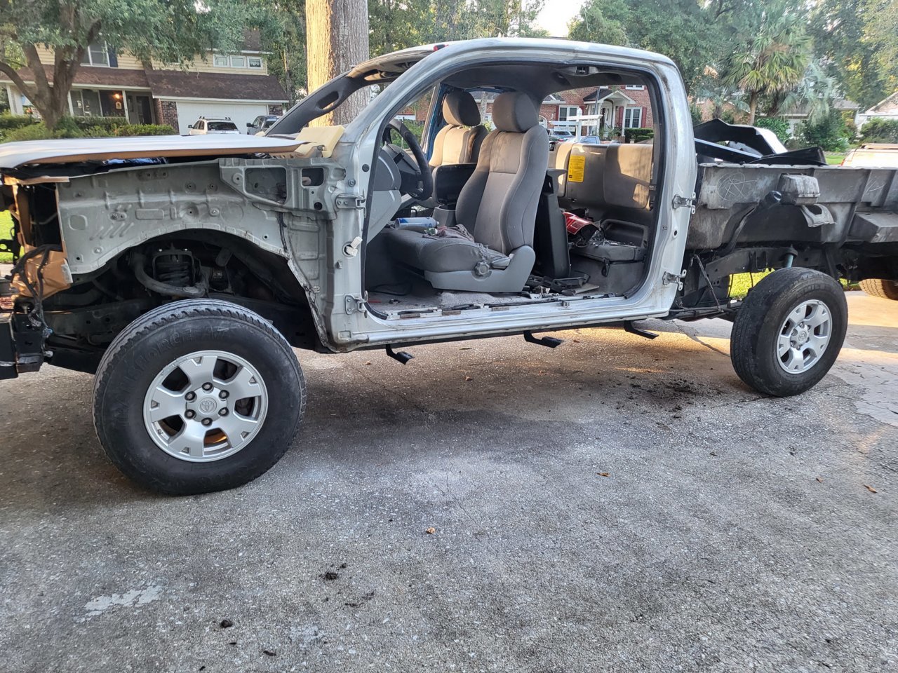

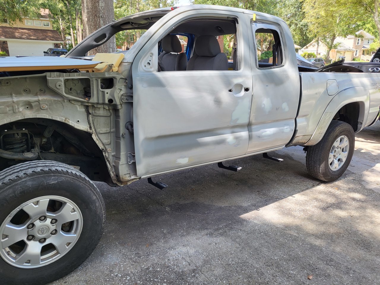

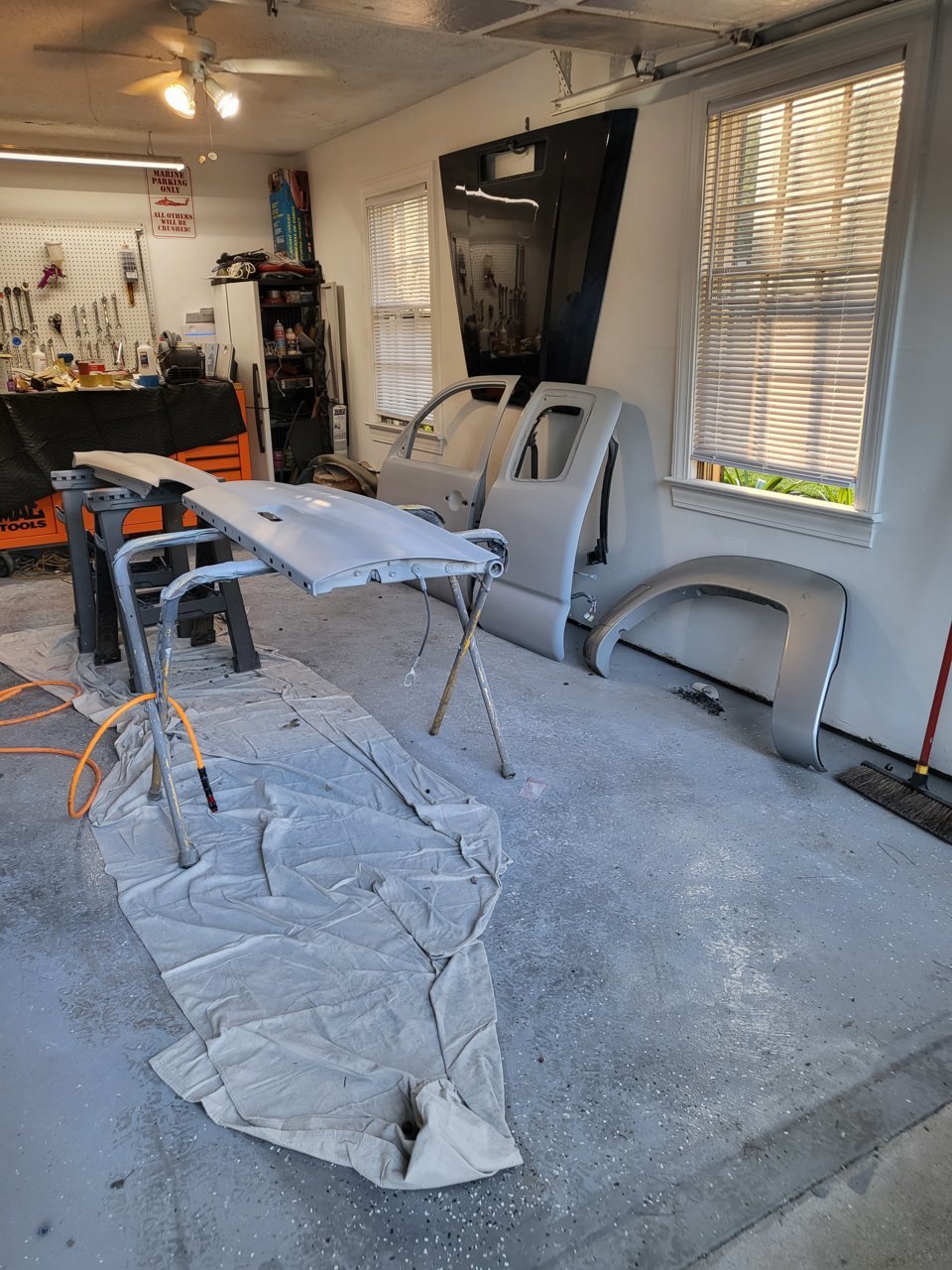

    Hey guys it's been a bit but here is the update.i replaced the motor and the truck is in body work and primer right now she will be back on the road soon
