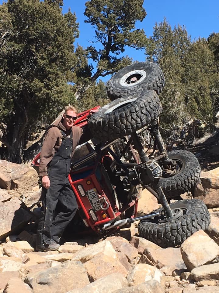

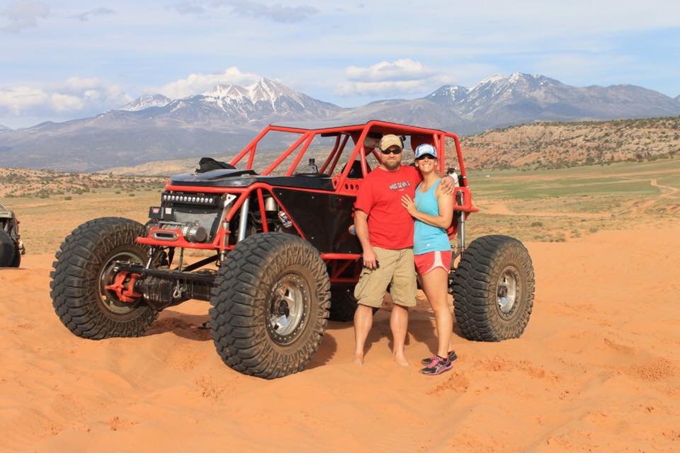

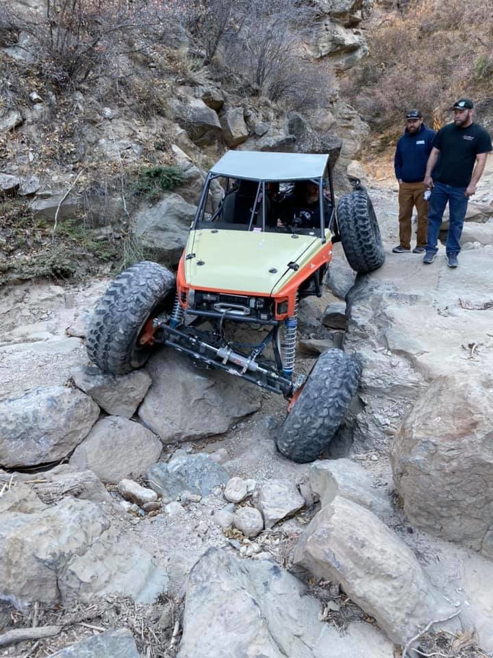

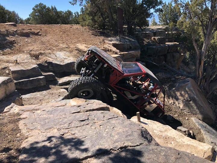

    So this is going to sound bad, and this is not directed at you. This is just an observation from many years of "hardcore..."
    A mini truck/4Runner/Tacoma with 40” tires and a Toyota powertrain...work ok. I edited/quoted/bold your post, because you can't be hitting hardcore trails with anything less than 39" Red's, leaf sprung suspension is a joke for crawling (especially on both ends), and the mentality of 40/42's and Tons is the standard for hardcore, not because it's just a bunch of people blowing money...it is because it works. I won't comment on the dumb peasants.:D
    I wheel with Toyotas, but let's be honest, these are really not even close to Toyota's anymore but the engine...maybe the transmission.
    22RET/5sp, soon to be a V6/auto
    4Runner...sort of. 4 banner/5sp
    4Runner 4 banner. Nothing else yoda.
    and for some reason, he is usually like this.
    You might notice a common theme here with these three rigs and their drivetrain.....

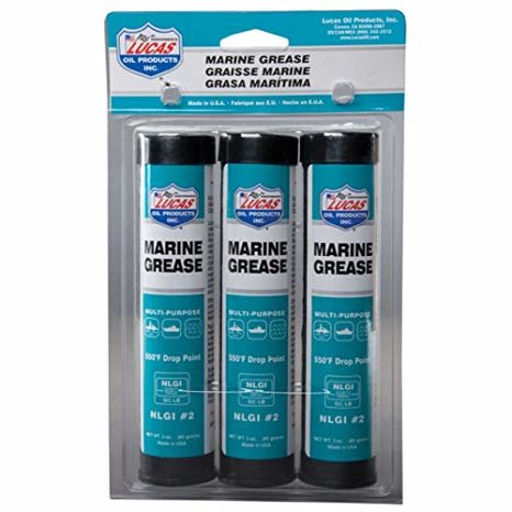

    Nice rigs and to answer your questions, yes the female coupler was replaced everytime since it also stripped its inner splines. And no anti-seize was used. I used marine grease when mating coupler and input shaft, which was recommended by my fabricator.
