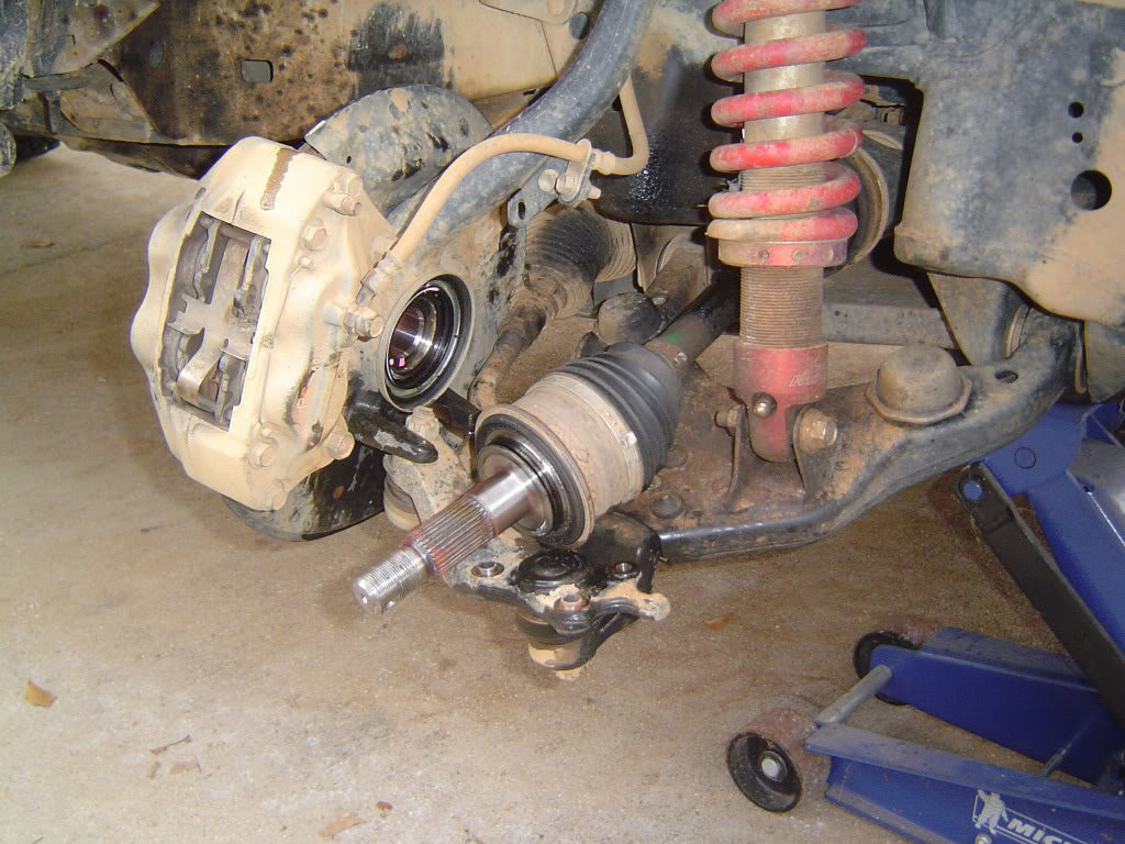

    You mentioned in the post before last that you left the wheel on while trying to shove the axle back in. You have to take the wheel off and remove the end of the axle from the hub so it looks like this
    then put the axle nut back on the end, and tap it back into the diff with a hammer. Sometimes you have to rotate the axle a bit to find the sweet spot where it wants to go into the diff.
    (pic above is a 1st gen Tacoma but same idea)
    6 gearT444E and TnShooter like this.
  4. May 16, 2022 at 2:04 PM
    #44
    TnShooter
    TnShooter The TacomaWorld Stray
    Sep 2, 2010
    #42625
    21,321
    Deogee
    07' TRD Off-Road, Auto
    STOCK
    That is the way I do it.
    Except the 2nd Gen has 2 big bolts for the lower ball joint. The axle nut is 35mm I think?
    Watch the brake lines and ABS sensor wire. Unbolt or unhook if needed.
    I think the LBJ bolts are like 118~ ft/lb
    And the axle nut is like ~175 ft/lb
    It’s been a bit since, so you should double check those figures.
    wi_taco and Superdave1.0 like this.
