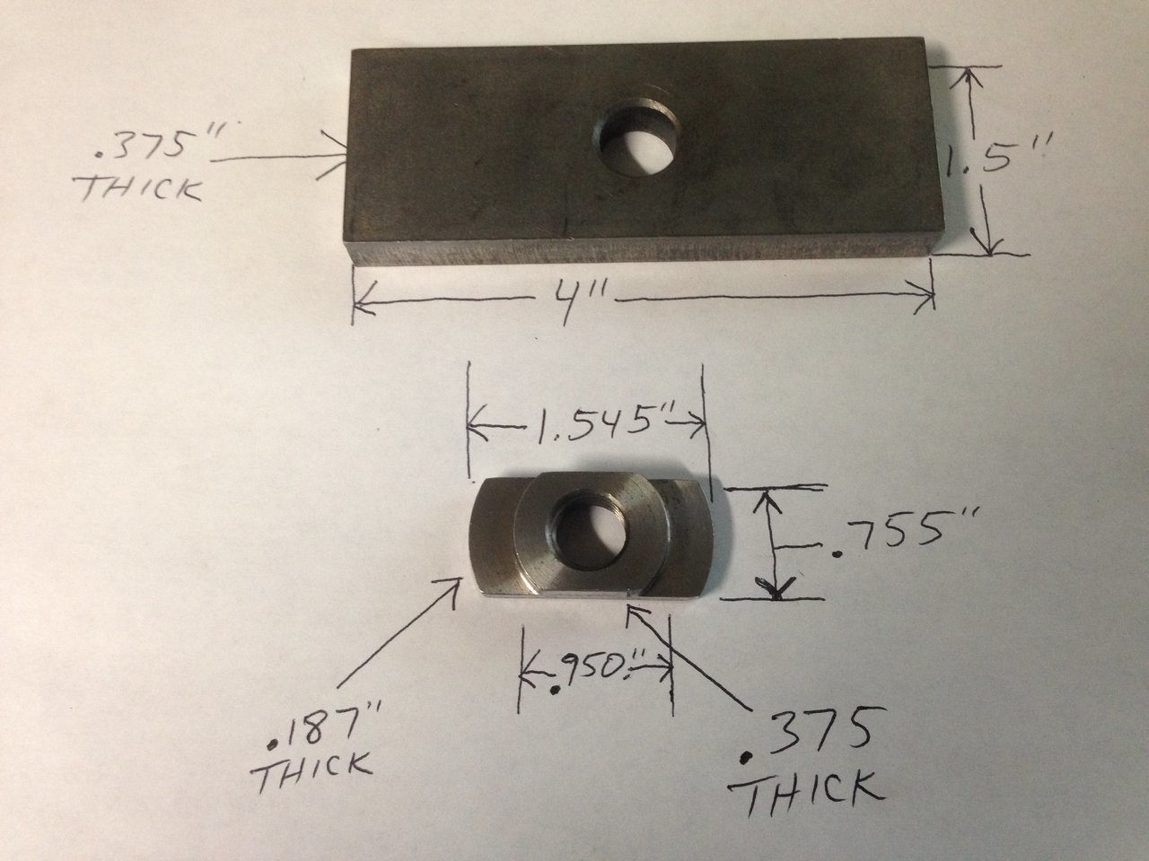

    Got a picture of that? or were you using rental forks...? I may need to go out and get some. Pry bar and yanking on steel cable not getting it. About 1/2 a day from tantrum or 2nd fouled up part, lol

    Nothing magical about using the pickle forks. It’s what I had in the garage, and they are something I didn’t care what happened to them. Check out Harbor Freight. They have Pittsburgh 16” forks for $9.99. Get a coupon get a few buck off.

    Thanks, I more so just meant a picture of how you combined the two to gain leverage, but I was able to whack the thing out using a pry bar and sledge. Same thing as everyone else said, patience, turn, and just keep going at it.
    Now, since I was too cheap I need to go and create a puller tool as the part from Autozone isn’t long enough to reach back to where the needle bearing is. Anyone got measurements of that plate that’s used on the backside from the ECGS tool? Thx

    I appreciate drawings like this. Perfect for a boring day in the shop. Most likely jinxed myself..hope not to need it, but sketched it anyway. I don't tantrum much anymore, but curse and swear for sure. Then walk away for 5 minutes, return and have it practically fall out.

    Of course the home-made puller tool would need some sort of adjustment and, the JB weld project did not hold up to this. Sigh... I guess I have to order the puller and give myself a :thumbsup: for at least attempting to solve it with mind over money.
    Arrgh, $48 on a one-time-use tool to install a $60 part has me :annoyed: like a big baby rn
    But I reckon I did just say in a previous post that the right tool makes all the difference :D
