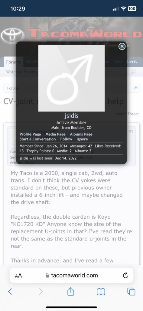

    Click on OP’s name and it’ll show you the last time he was on here.
    Sorry I couldn’t be more help!
