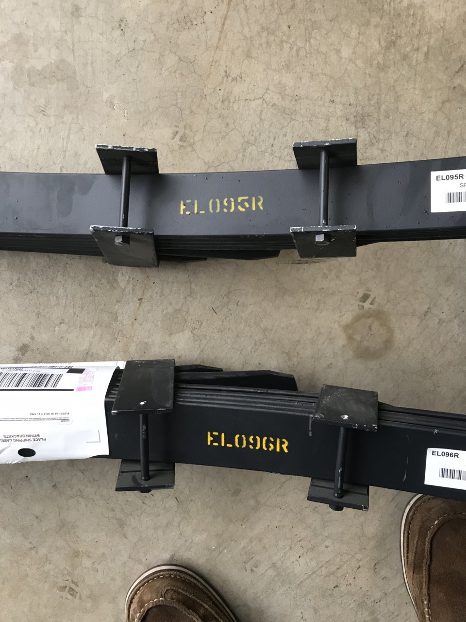

    I believe that is the only difference. Others can correct me if I'm wrong.

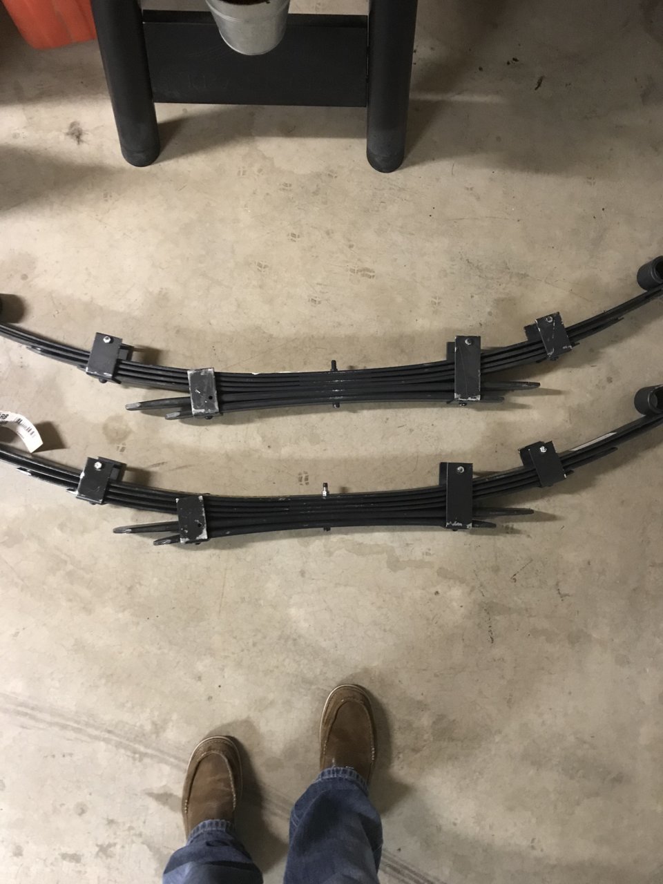

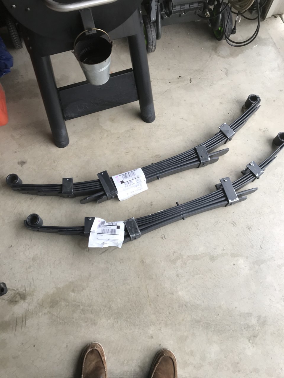

    So remove the 3rd leaf from the top correct? And if anyone has the leaf spring tourq settings that would be awesome.

    Remove the third leaf down in the 96R pack to make them both the same. There’s no torque requirement for the centerpin if that’s what you were asking.

    Removed the 3rd leaf from the top. Had plenty of bolt length since I was going down in size. Did notice a little bit gap size on the bottom leaf, but I’m sure that will just compress out once it gets some weight on it.

    Great looking leafs compared to the factory ones. Couldn’t imagine throwing an AAL in those.

    Yup you got it OP just remove the 3rd leaf down to make the 96 pack a 95.
    That stated, look at the packs if one is a + and the other an O or - spec (there will literally be those symbols on the top leaf painted in yellow). Put the + on the driver side.

    nothing weird about two +'s but if you had one that was less than a + put it on the passenger side to aid with taco lean.
