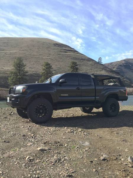

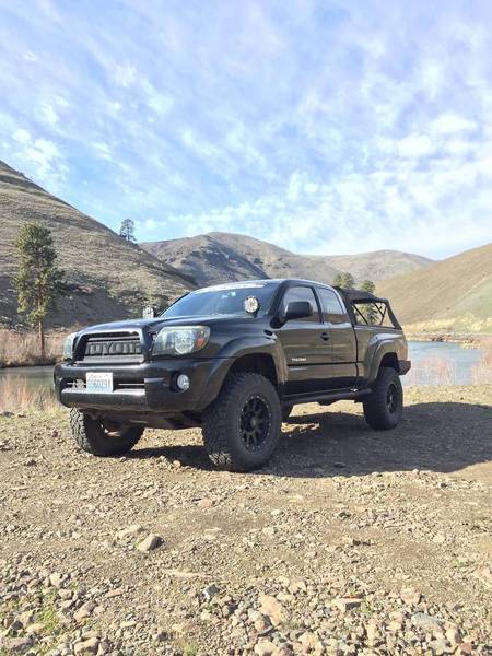

    Total Chaos +2 LT w/ 2.5 x 8 Kings, 700 lb coils, Chevy 63s, BAMF Shock relocation, 12" King Smoothies, Locker Anytime Mod, 5% Tint All Around, 4xInnovations full skids, Custom Made Rock Sliders, 4xInnovations HC Rear Bumper w/ Tire Carrier, SOS Original Plate 2 Front Bumper, 130 w KC Slimlites, Homertaco Raptor Grill, Bestop Supertop, Smittybilt 9500 lb winch, Flowmaster 40 series, JVC deck w/ 12" Rockford Fosgate T1 in custom box, and lots more!!
    Oh by the way I washed, clay bar'd, sealed, and waxed it :D I think we're passed the winter weather here (since it never started) so time to look purdy again and get some tree branch protection.

    Gracias! Sweet 4Runner!
    Soon I'll have a front plate bumper and I'll actually fit In around here... :p
