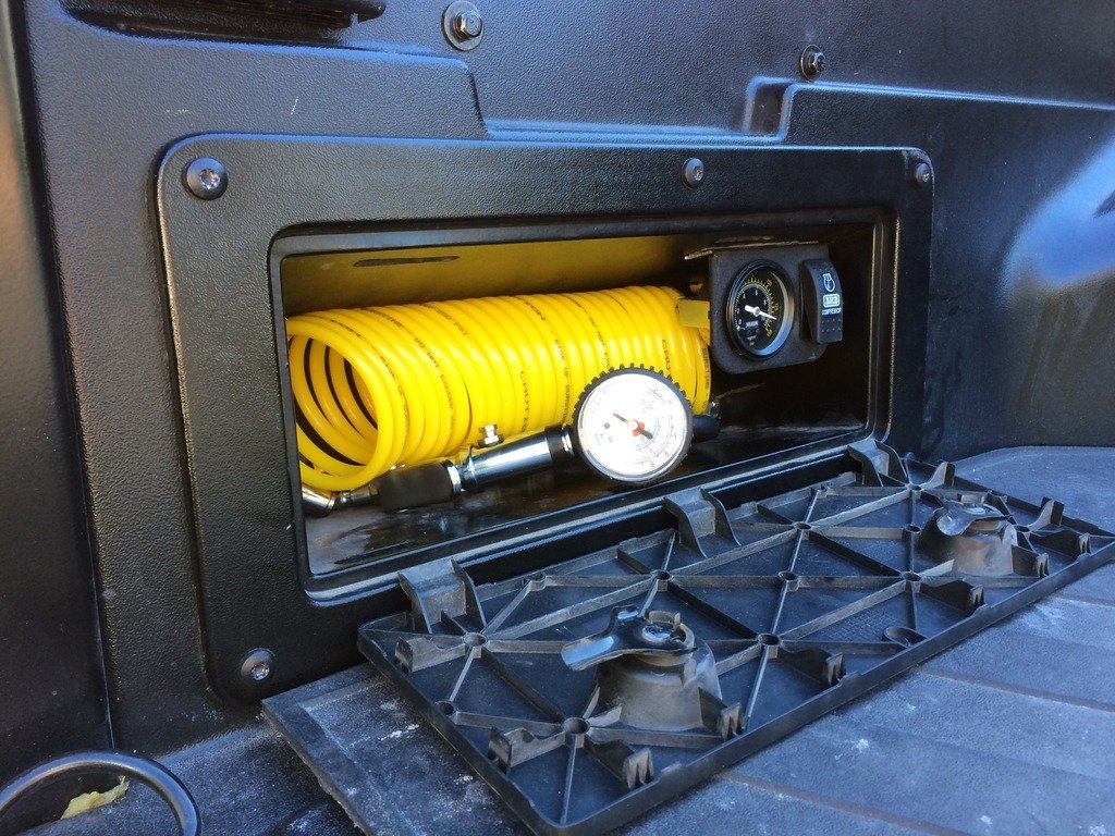

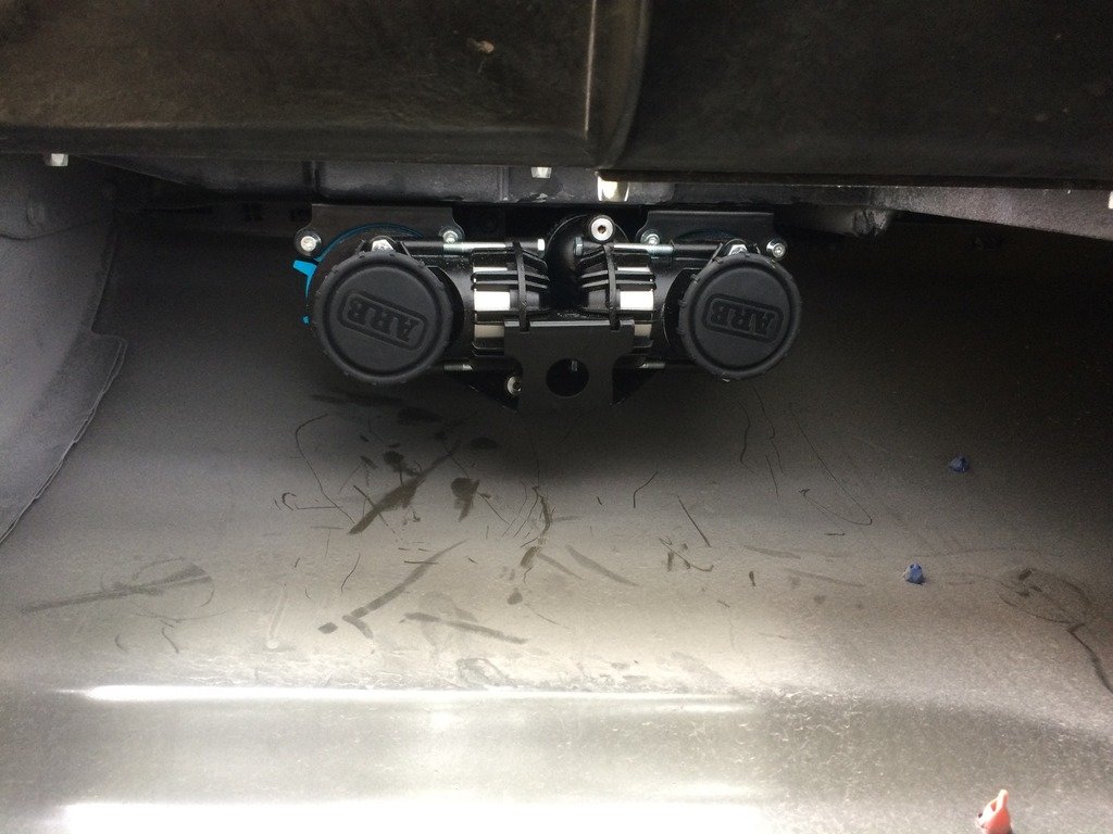

    Hey man saw your post in the OBA thread. Here is how I did mine.
    ACB02E57-DA00-4708-AFD3-ED3897A99893_zps_78efaa4778efcd6c3c4469526941eb6df65df261.jpg
    Works well just had to cut out one of the bed support ribs to get it to lay flush, and put a nice 90 degree elbow coming from the compressor. Also clears the pocket completely.
    At the top of this pic you can see the bottom two mounting bolts.

    That's a really good spot for the dual compressor!

    Dude that's awesome! Looks really clean too! So you just cut a hole in the back of the pocket for the airline to run thru?

    This is exactly what I'd like to do. :cool:
    excellent install! :thumbsup:

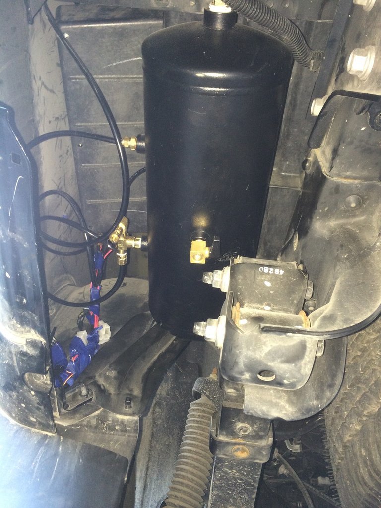

    I have an airline that runs to the two gallon tank that's mounted under the bed just below the pocket and then from there to the pocket for a quick connect.
