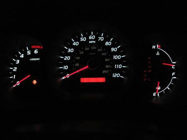

    Well I've been doing this mod last night and this morning and it's been a PITA because I have no soldering experience. I finally got them all working except the fuel light. The solder isn't sticking to the board on one side. Any suggestions? I've scraped it a little and cleaned it with alcohol but with no luck. I'm thinking maybe a wire brush?

    if solder is not sticking to the board, you might have ripped off the pad that the solder melts to! is it completely green underneath, or is the pad still there? it should not take much at all to melt solder to the pad itself.
    DONT do a wire brush, you will completely mess it up!

    The pad is still there but it looks a little burnt

    clean the tip of your solder gun and retin the tip. then touch the pad of the board...this will clean it better than any alcohol or anything will. if you are sure the pad is still there, any solder will melt almost immediately.

    Thanks man. I'll try it in a little while.

    I like how yours turned out! :thumbsup:
    Hey Josh... still loving mine man. Nice work! No luck yet on the back up camera, but I'll let you know.

    yea, im really like yours w/ the orange ODO.

    Finally got mine done! Thanks again yosh. It looks freakin sweet, but I'm not really looking forward to doing the radio and ac.

    my pleasure..and yeah...about that..if you had trouble w/ the cluster...radio is going to be terrible for you. the OEM led are even smaller, and the pads are extremely small...like 1MMx1MM small...no joke.
    if you want a radio done, check my forsale thread here. i have several colors/types that i will custom make for you. or if you want to send me your own radio, i'll do it as listed in my LED thread.
    and concerning the AC...not going to happen either unless you plan on doing red...there is orange plastic in there that cannot be changed.
