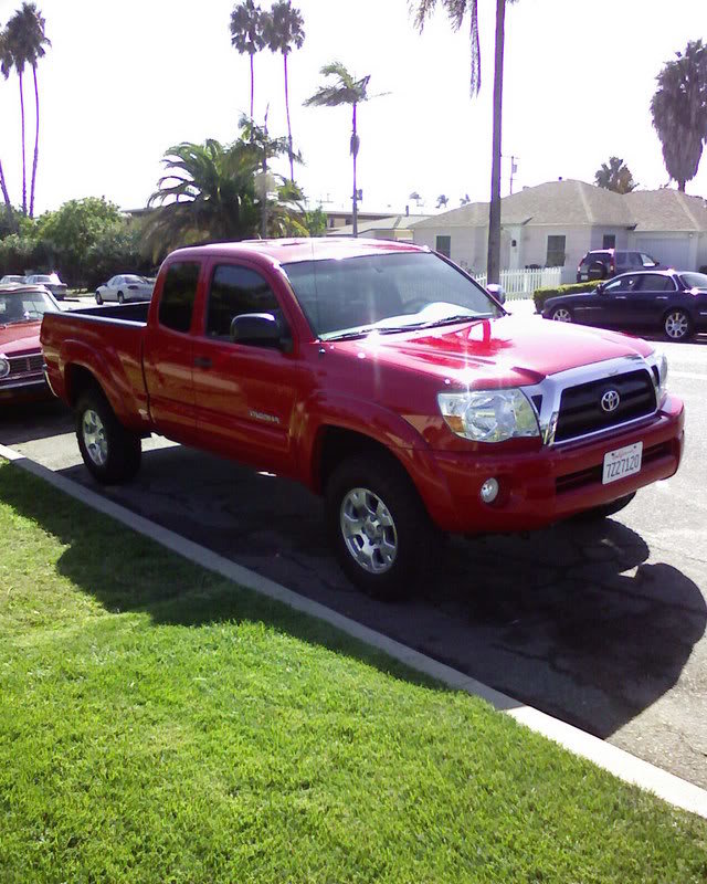

    I have a 2005 Prerunner SR5 that doesn't have the daytime running lamps. I was curious if anyone has installed something or rewired the front turn signals so they become daytime running lamps. Id love to keep them as signals as well. Also, i'm more than curious to make the parking lamps functional, as in making them into turn signals as well. anyone have any theories on this>
    I'm new, so excuse the noob crap. heres a picture of her. Aint she pretty?
