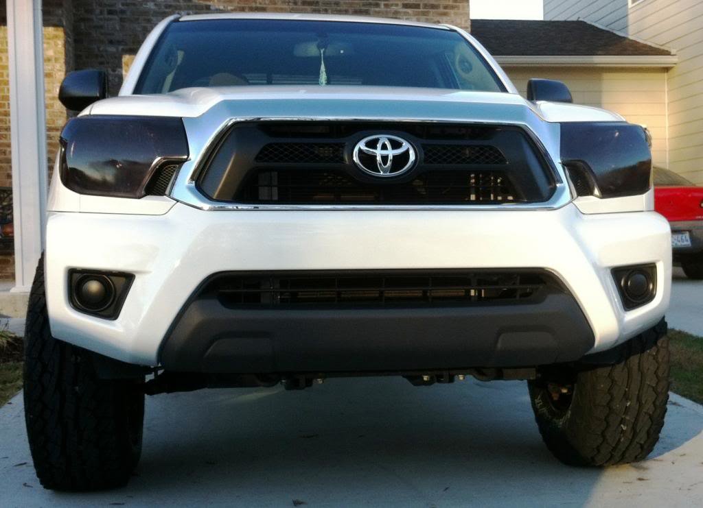

    Man, what a pain. My little build here had a lot of speed bumps.
    I asked around and did plenty of research about what offset/backspacing to run for my wheels. I was told 3.75 would keep me from rubbing the sways. It didn't, I rub just a smidge only when backing up an turning and at full crank. Kinda sucks, but i'm living with it. I may consider spacers in the future.
    First of all, fatbobs lift is pretty easy except for the rear. I completely underestimated how difficult it would be putting the leafs in. I think most of the issues were created by myself but anywho..
    I first ordered my wheel and tire combo in late August. I ordered a set of Pro Comp Series 51, 15x8 with 3.75 backspacing (-19mm). As for the tires, I waited on back order for 3 months!! - Until finally getting pissed enough and calling BF Goodrich myself and learning they do not make the KA T/O's in 32x11.5 anymore, thanks 4 wheel parts! So, Falken Wildpeak AT it was.
    So the wheels come in, I get the tires mounted - They dont fit! The center caps dont fit either, they are huge. I decided not to run any anyways. Thanks knowledgeable people at 4 wheel parts for telling me they would.

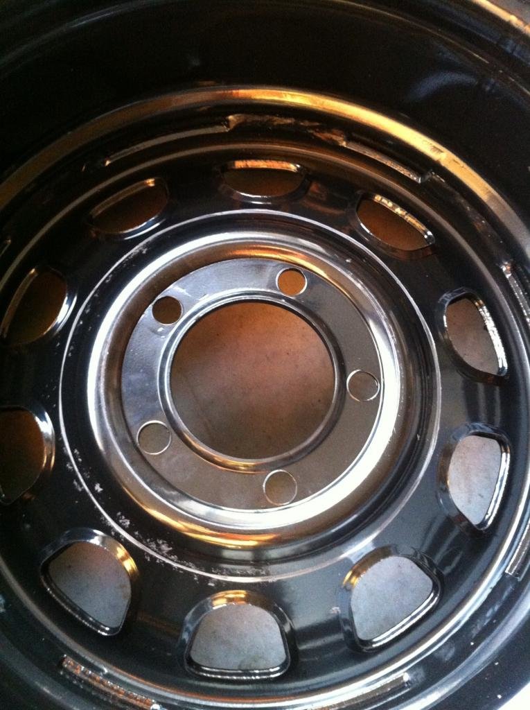

    Here was the result of the wheel not fitting:
    They rubbed on the lower caliper brackets. So, I trimmed about 3/8" off each side and they now fit, after mounting and dismounting the 60lb tire wheel combo 400x.
    Ok thats the end of my story. Now for the pics:

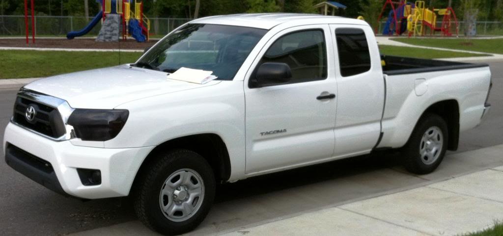

    Before:

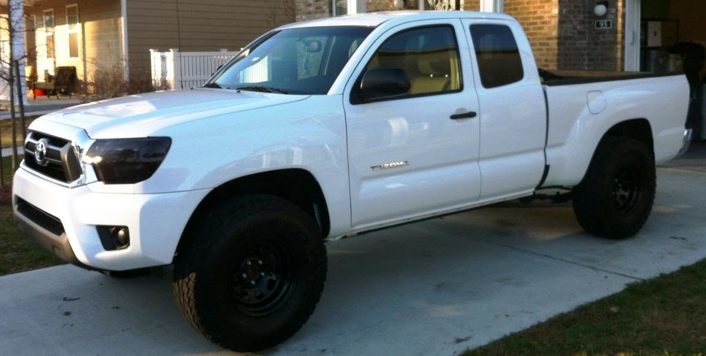

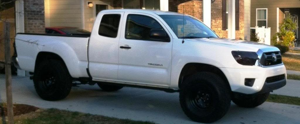

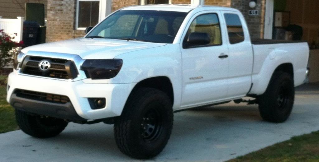

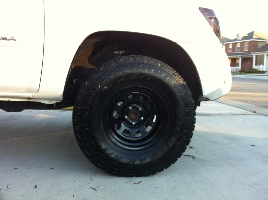

    After:
    If anyone wants to run 32''s.. heres a few notes:
    - Do not order from 4 wheel parts
    - Watch the ReadyLift video religiously
    - If you can, use a lift to put the lift kit on (if not, have 2 jacks to make life easier and have at least 2 jack stands).
    - Rent a spring compressor to rotate the strut to accurately fit the spacer on
    - 3.75bs works great with this combo, will work great with 33x12.50 as well. Must gut the inner fender wells to get them to not rub. Will not touch the sways.
    - BF Goodrich does not make 32x11.50s TA K/O's anymore, so don't wait even if two different tire shops tell you they are on national back order.
    - Make sure you see the back of the wheel before purchase, and don't be a dummy like me and fit the tires on before mounting and ensuring fitment.:rolleyes:
    - If you want 33x12.50, run 3.75bs or less and gut the wheel wells.
    Thanks for looking.

    so how is the light output on the headlights, they and the tails seem a bit too dark.

    :thumbsup: nice looking truck! Er, minus the blacked out lights.

    It's not bad, definitely some light loss.
    Thanks, to each is their own.
    From the black box mod? Hmm.. Didn't notice it that much so it didn't bother me. Maybe I'll spray it black sometime, I'm burnt out on this thing for now. Thanks though?

    Do you mean LESS backspacing?
    More wheel backspacing will bring the tires in closer to the frame, less backspacing pushes the tires out farther from the frame.

    Oops, my bad. Good catch, thanks! Its now fixed. Long day compounding and polishing the truck,I need a drink lol.
