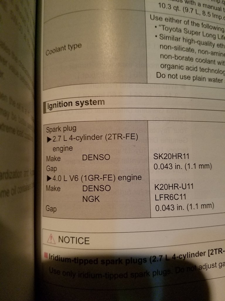

    @luco1029 I would run what the manual recommends that would be your fourth selection.
    I understand the purpose of long life but just speaking in a manner of instance here what if it was too long before the spark plugs were removed and it were to be rusted into place.
    I change mine every 30000 miles is of recommended and I have found rust on mine but then again I off-road and I wash my engine bay.
    And you don't need to run your iridium it's just an extra expense that is not necessary, Trying to save $

    So which plug did you mean? Which price since they're all different I'll know which you're talking about
    TXpro4X4[QUOTED] likes this.
  19. Aug 17, 2017 at 8:58 PM
    #39
    TXpro4X4
    TXpro4X4 Fuck Cancer!
    Oct 29, 2011
    #66093
    29,404
    Bryan
    Costa Mesa, CA
    2011 TOY
    20170817_205355.jpg $4.69
