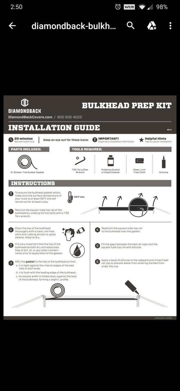

    Diamondback owners, did you all install this stick on gasket per these instructions?

    I didn’t

    That gasket makes it impossible to reattach the tube without stripping the bolts because it sits too high now. Are these instructions outdated?

    I did. I had to really press down on the top tube to compress to gasket to get the holes to line up. That isn't the issue of where water comes in. A lot of water will enter through the front two corners unless you get the OEM plugs that go there, but they're like $58 per side.

    Yeah the gaps are pretty wide. I'm about to stuff them with silicone.

    I installed it, and as littlefish said, it probably isn't a point of water entry as much as the gaps between bedrails and bulkhead. If I did the install again I would skip it. Also the metal bar that sits on top of the bulkhead also has a very thin "gasket" already affixed to it.

    This thread has all the info on them. Haven't bought them myself but it sounds like they're the answer. I have the spaces gummed up with HVAC putty and water is still coming in.
