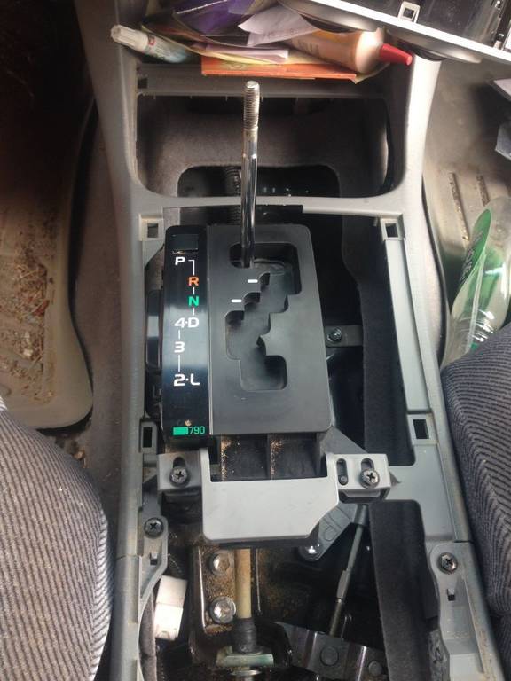

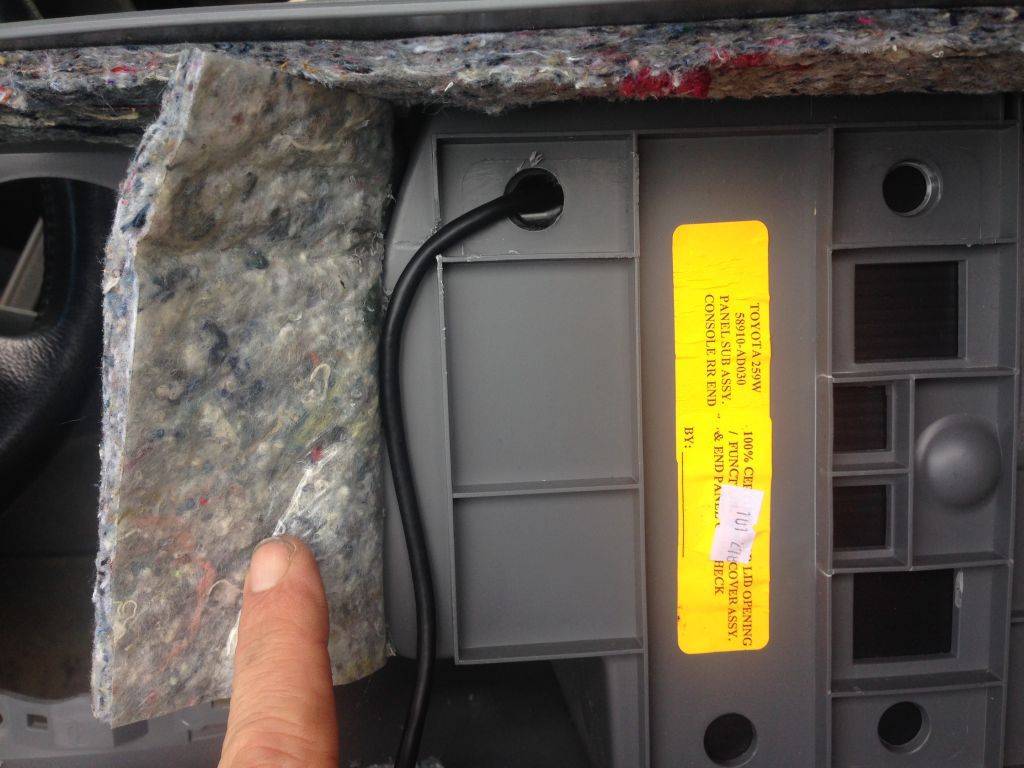

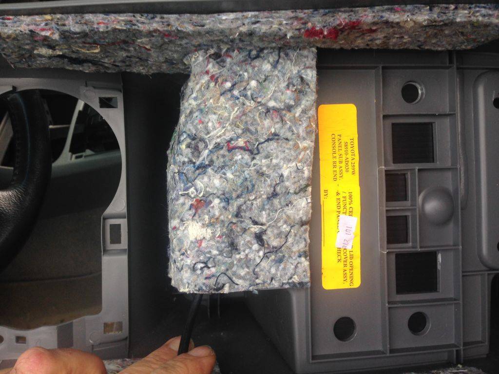

    Decided to finally get around to moving my USA SPEC PA-15 from the glovebox to the centre console so I can access my ipod easier
    I referenced this thread for removal of the interior trim pieces
    http://www.tacomaworld.com/forum/2nd-gen-tacomas/57895-center-console-removal-w-pics.html
    Removed the front cup holders , shifter knob and shifter trim

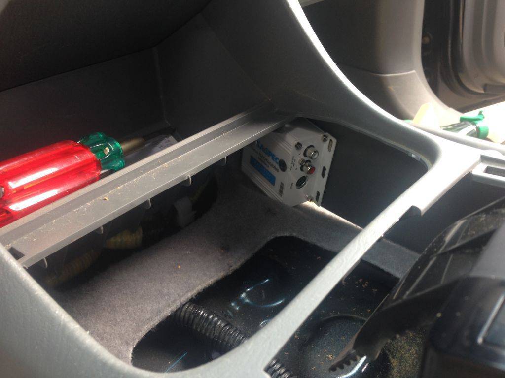

    I found the PA-15 unit fit nicely in this area just forward and to the side of the cup holder trim piece . I didn't want to hear any rattles or have it moving around so I used some double sided tape to fix it to the plastic
    I routed the cable from the radio down behind the glovebox and into this area ahead of time

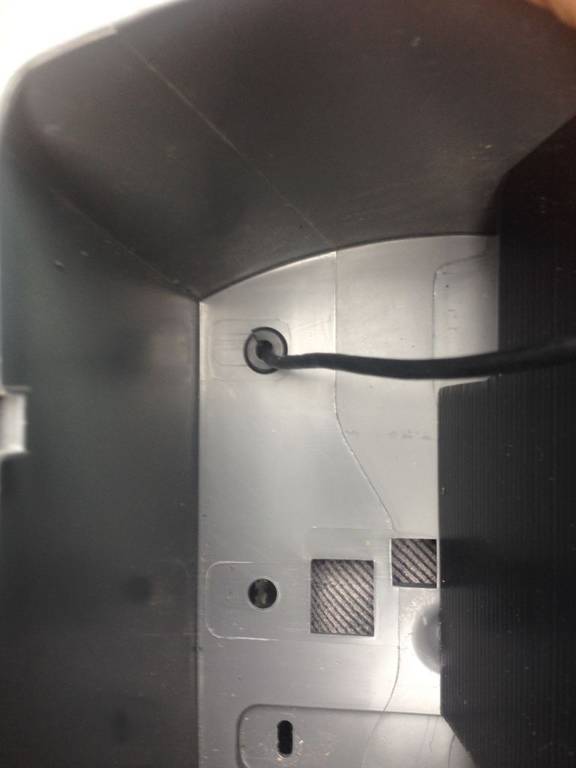

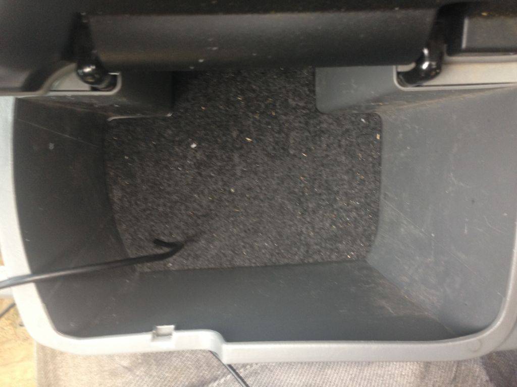

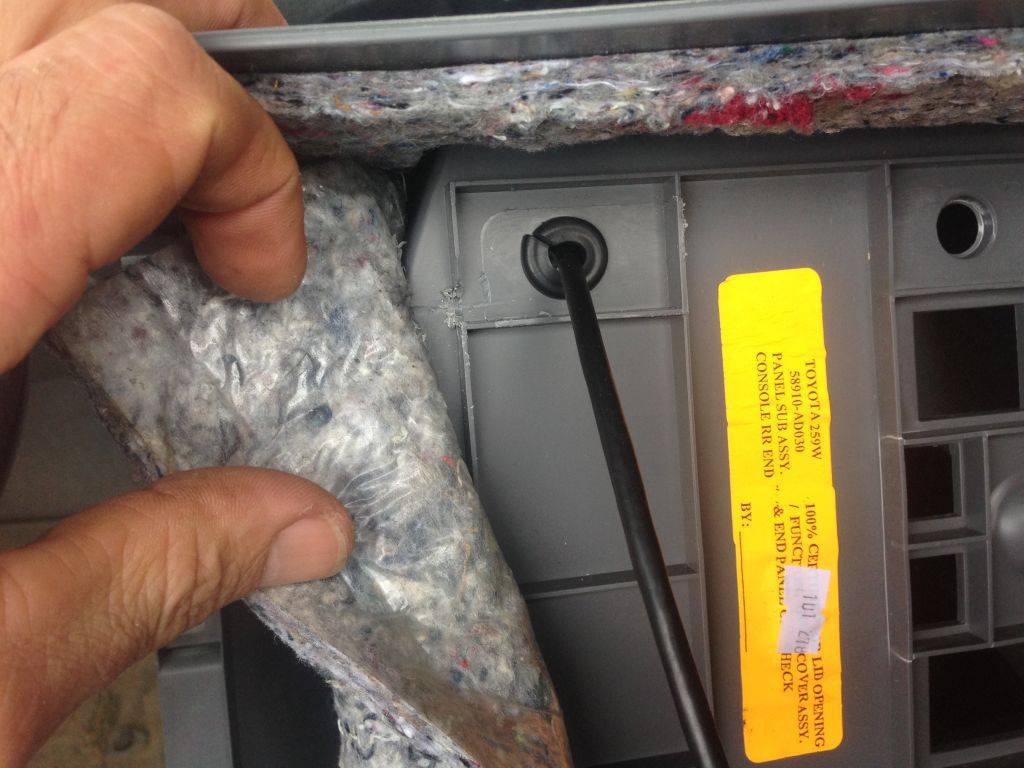

    I pulled the centre console , used a dental pick to pull up the carpeted bottom and enlarged the forward hole of the console bottom to allow the cable end to pull through

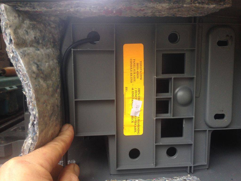

    On the underside I gently pulled back the insulation , notched the reinforcing rib and trimmed the plastic so that there were no sharp edges
    I had a couple wiring grommets kicking around so I trimmed one to fit and installed that and folded the insulation back over the cable
    Bottom
    Inside

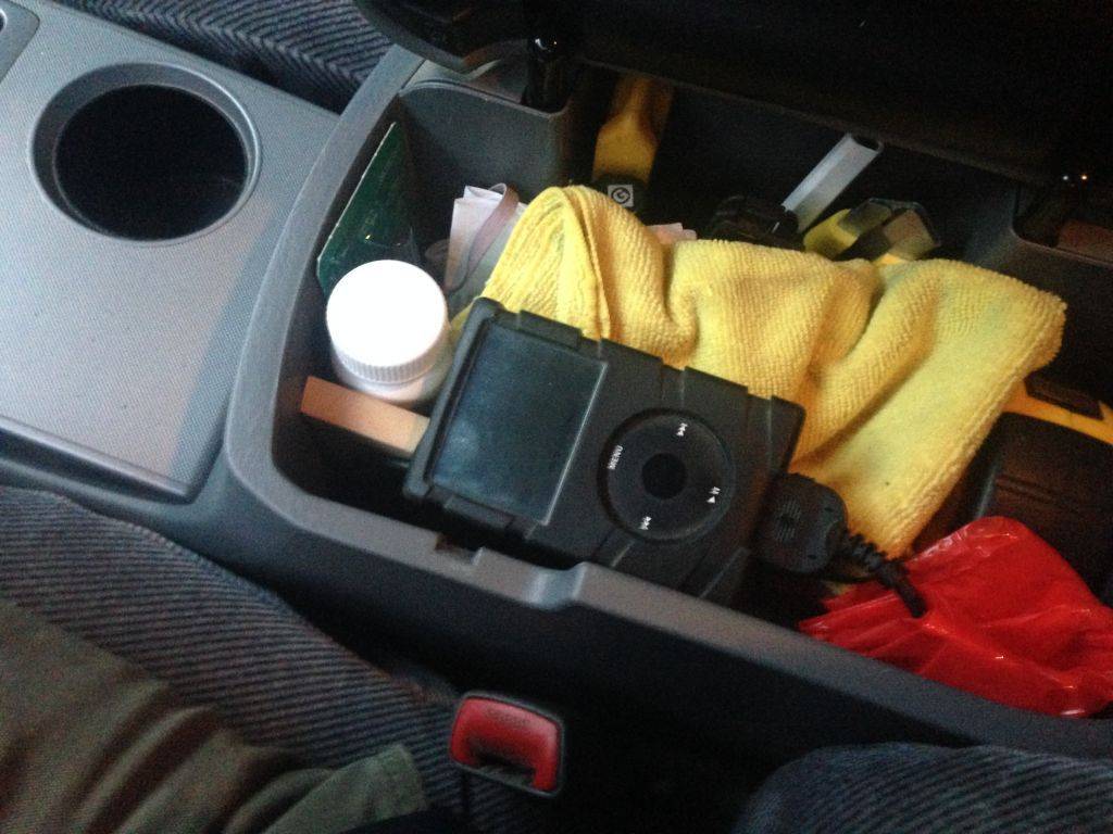

    So now I can access my ipod , still may refine a mount for it in the console but for now this will work

    Looks a lot more handy there, never understood why people had their iPod hookups in their glove compartments, seems like pretty much the worst place to put it as it's the furthest area away from the driver's seat.
    I'm surprised your floorboards are that dirty, but not surprised there is sawdust in your center console and shifter area.
    What's the iPod case? Looks nuts.
  9. Oct 16, 2014 at 7:43 PM
    #1669
    OZ-T
    OZ-T [OP] I hate my neighbour
    Dec 15, 2009
    #27584
    50,587
    Peter North
    British Columbia
    The PA-15 generally just runs playlsts that you can toggle through with the stock radio , the only time you would need to access the ipod is if you want to go into direct mode and choose something from the ipod controls , the case is just a rubber shock resistant cover that's been on there for years
