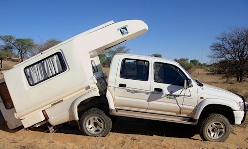

    How heavy is too heavy?
    The premiss behind Diet Taco is that it is important to control the weight of your rig. That naturally leads to the question of how much weight is too much. The trivial answer is that the GVWR is the maximum weight. Clearly though being ten pounds over the GVWR isn’t going to break the truck or make it unsafe. Is 10% over acceptable? How would anyone make an educated decision?
    The question of what is the “actual” safe limit, what modifications could be made to increase that limit and what compromises are made when you exceed any given limit comes up rather frequently in expedition and camping forums. The answers range all over from those who claim going one pound over will result in your body being picked clean of all its flesh by ravening packs of lawyers waiting to sue negligent drivers who are over GVWR to others who brag about being 1500 lbs over GVWR while towing a trailer an additional 2000 lbs over the vehicle’s tow capacity and who disable all the stability control systems on their vehicle because they are a better driver than the computer. The discussion typically devolves into to shrill shouting matches devoid of any actual references or calculations with Godwin’s Law being fulfilled in less than thirty posts.
    Having now wasted far too much of my limited time on this planet researching this topic I thought it would be worthwhile to make a few posts here in a build thread dedicated to keeping things light about just what trade offs are involved in getting heavy.
    Looking Good
    In this first post I’ll simply cover what the various specifications and ratings are for the Tacoma (focused on my configuration of a DCSB 4WD V6 w/tow package). In a later post I’ll describe where these ratings might come from and what if any regulatory consequences there are for exceeding them. For now it is worth noting that the GAWR and GVWR are determined by the manufacturer (Toyota) and are effectively impossible for an end user to change from a regulatory stand point.
    • Front Gross Axle Weight Rating (FGAWR) - 2775 lbs (pg 571 2015 User’s Manual)
    • Rear Gross Axle Weight Rating (RGAWR) - 3110 lbs (pg 571 2015 User’s Manual)
    • FGAWR + RGAWR - 5885 lbs
    • Gross Vehicle Weight Rating (GVWR) - 5500 lbs (pg 572 2015 User’s Manual)
    Note the GVWR is less than the sum of the two GAWRs by 385 lbs. Why? People posit various theories online but no one seems to know. The most often offered theory is the brakes but as we will discuss later that is very unlikely the case.
