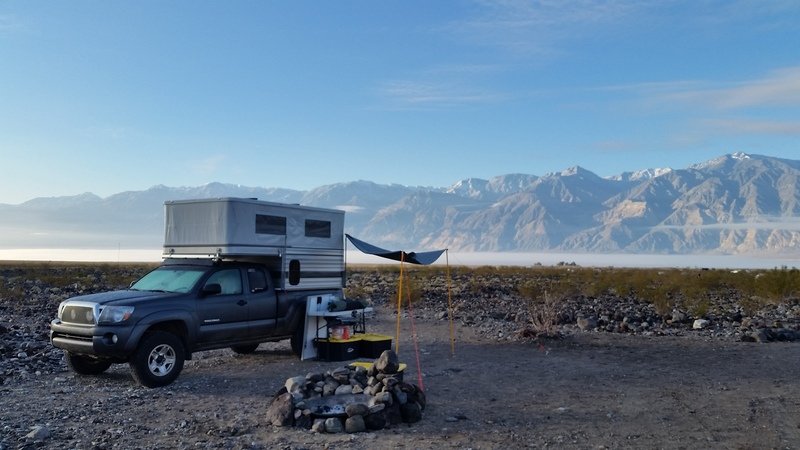

    Usually I move camp every day and so setting up shade in camp isn't necessary. We do use the Fiamma awning for lunches on the go and it works great at midday since the sun is directly overhead. Even for a late or early lunch I can orient the truck to maximize the effectiveness of the relatively small footprint of the awning. For a full day in camp though the sun angle will change too much for the awning to be effective on its own and so creating a more effective shade footprint is desirable.
    One option would be to attach side panels to the Fiamma. Even a single panel could just be moved at mid-day to the other side. This would also be a useful addition for lunch stops. I'll definitely make a detachable shade panel one of these days.
    The other option would be to create a much larger shade footprint using the Fiamma as a base to help support the shade material. Useful features would be:
    • Dropped/angled sides to handle low sun angles in the morning and afternoon
    • Low wind drag
    • Permits breezes to pass through
    • Minimal noise in wind
    • Easy to setup and support
    • Flexible deployment options
    • Easy to pack
    So called camo netting fits the bill well with the trade off being that it doesn't not provide true deep shade. The theory is that you can still scoot around into the deeper shade provided by the awning or the truck/flip-pac itself but be surrounded by a comfortably large patch of light shade. In the desert reflected heat and UV from the ground surrounding a tiny patch of deep shade is quite significant and the net would cut down on that. It also allows more space to have camp gear out of direct sunlight.
    Last summer I purchased a 10'x20' Tan Camo Net. I was looking in particular for a durable one that include true netting separate from the shade material itself. This needs to hold up in desert winds. A true net with strong side cords also allows for securing at any point along the edge without the need for a grommet hole like in a tarp. In an earlier post I mentioned a failed attempt at acquiring a spreader to help hold it up which proved to be ridiculously large and heavy. Instead I acquired a metal pie pan and drilled a hole in it to place on top of a single adjustable tarp pole.
    This trip I finally got to try setting it up for a day working on the truck out in Basin and Range National Monument. It all worked quite well. Setup the first time was quite easy solo starting with the Fiamma already setup. Along one edge I attached it to the truck in three places using elastic ball straps. Along the far edge I only secured it in two places one of which was shared with the Fiamma. The tent pole and pie pan held up the outside corner at the front of the truck.
    In the above photos you can see the whole setup from the outside and the inside as well as details of the attachment points. The pie pan on top of the tent pole worked perfectly. Note the detail of the "Figure-9" device used on the orange line in the upper right corner. These little things are wonderous little gizmos that I highly recommend. You never need to tie a knot and can leave a lot of excess on any tent/tarp line using the Figure-9 to cinch to the proper length. In the second from the left photo you can see it can also be used to secure one line to a second as I've attached the corner of the net to the existing line for one corner of the Fiamma. Allows for very flexible and adaptable setup.
    Everything worked almost perfectly the whole day. There were some stiff breezes and the net did nothing more than rustle a bit like leaves - no snapping or crinkling sounds. The extra shade was very welcome. Even sitting under the awning itself all that extra shade was easier on the body and the eyes. I quite enjoyed it and it made working on the truck through the day much more pleasant.
    The only problem was where I was camped - right on granite. As a result I could only use cairns to anchor and I knew that would be insufficient for strong winds. In the afternoon a mild thundershower came through and despite probably 40 mph winds everything held with a little bit of monitoring from me when a cairn started to slip. In this storm the net was mostly in the lee of the truck. I was impressed everything held together despite the crappy anchors - a testament to the reduced wind load of the netting compared to a solid tarp.
    Later another storm came through and again I decide to just watch. This time the winds were fierce but worse they suddenly changed direction making the net the windward side. That was too much for the cairns and they broke free. In the end though the net did just fine! It never became particularly airborne and being literally a net tended to quickly hang on things and not blow around so much.
    The awning itself though was another matter. I had to physically hold it down and drop its legs to keep it under control. In the process a rivet popped on one of the support legs and the leg dropped to the ground. In a testament to the ease of setup and tear down of the Fiamma I managed to actually get it stowed mid-storm solo while being wrapped in the surrounding camo net. It was a bit of a chore but no damage beyond the lost rivet.
    Post storm it was getting near sunset and there wasn't going to be any more sun due to cloud cover. Packing up the net was a breeze as there is no need to fold it at all - just stuff it into a stuff sack. It lives under my raised floor in the back along with my roll up camp table and folding chairs. I likely won't use it that often due to my camping style but now I know it is really easy to setup and take down. I'll just restrict it to sites where I can actually drive stakes into the ground!

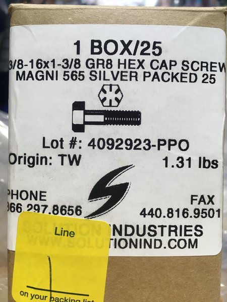

    OK, so I'm just now getting around to ordering, because it turns out I need a few Tap Bolts (threaded the full length of the bolt) for another (Tacoma-related) project. That got me thinking - is there a reason you choose Hex Bolts for your kit, rather than Tap Bolts? Seems like Tap Bolts would be more flexible, since you could utilize any length of a Tap Bolt, but are restricted in usable length to the "end" of a Hex Bolt.

    Tap bolts are a great idea. I ended up using hex bolts primarily because I wanted JIS bolts so I wouldn't have to fish around for odd sized sockets while working in the field and I couldn't find any JIS tap bolts from the vendors I was looking at. I've seen plenty of US metric tap bolts though (though fewer in the fine/super-fine thread pitches). I actually thought for a moment of just getting long tap bolts and then trimming them to size as needed but quickly realized that "trimming" 12mm bolts would be rather exciting. So in the end it seemed that since I was going to get a variety of lengths anyway that hex bolts would be just fine. I made sure to order lengths spaced by less than the threaded length. I also have plenty of washers which allows a bit of fine-tuning if the threaded portion stops just a tad too early.
    So anyway tap bolts seem like a fine idea to me, don't know a good reason not to go that route. But still be sure to get a variety of lengths for the thicker bolts as I suspect they'd be hard to cut to size in the field.

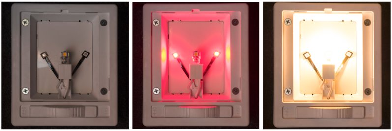

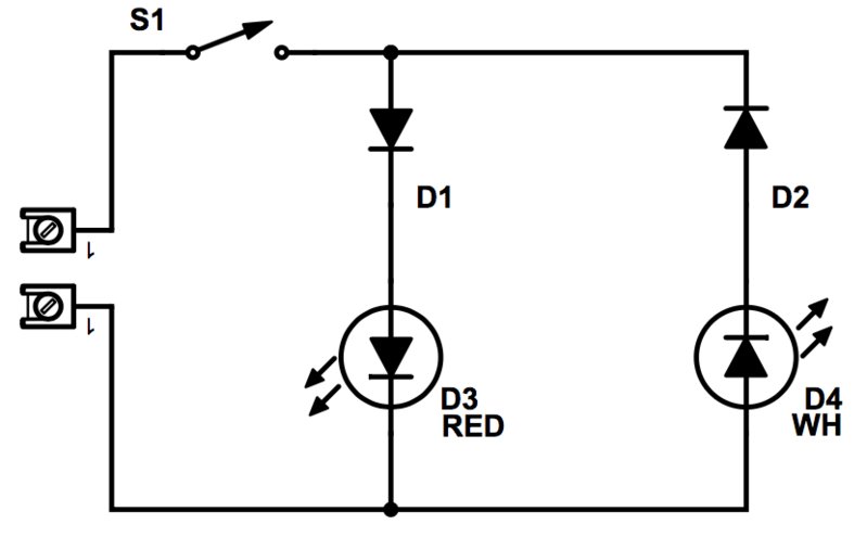

    This was actually done sometime ago but I never wrote up or took photos. I wanted to be able to switch between either red or white lighting in the Flip-Pac. The light housings that FRP installs are pretty cheap and have a simple slide switch on them for on/off. There are two of them and their wiring is glassed into the Flip-Pac and emerges at the rear drivers side interior. In a previous post wiring power to this point was shown.
    Previously I showed installing a white bulb in one and a red bulb in another in order to be able to select white or red. In this mod I've installed red and white in both housings. Color is selected by reversing the polarity to the power going to the housings. Right now this is done by just swapping the spade connectors at my power connection but in the future I want to put a DPDT throw switch in to do that along with a dimmer.
    I didn't want to add a second bulb socket to the housing so instead I added two red stick on LEDs on either side of a white bulb in the socket. The diodes and wiring are hidden behind the inner cover panel in the housing. The basic circuit is:
    S1 is just the on/off switch at the light housing. There are actually two lights in the Flip-Pac so this circuit exists twice connected to the same pair of power wires that emerge at the rear of the Flip-Pac.
    Realize that D3 and D4 are actually more than just a diode in reality. The white one is a bulb which includes either a current driver or current limiting resistor. The red one is actually two different stick on red diodes again with integrated current limiters.
    The point to D1 and D2 are to prevent reverse current flow through D3 or D4. Recall that LEDs typically have a low reverse breakdown potential (i.e. they will conduct current when connected in reverse if the reverse voltage is is more than a few volts). Also some bulbs are already designed to be independent of polarity - they will illuminate regardless of the applied polarity.
    D1 and D2 are rectifying diodes with a high reverse breakdown voltage (50V in this case). So if power is connected in one direction current will only flow through the white bulb and if power is connected in the other direction current will only flow through the red bulb.
    I think if I add any additional lighting to the Flip-Pac I'll just follow the same scheme and route just a pair of wires with polarity based color. That will allow me to have a master red/white switch for all the lighting.
    Here are photos with the covers off showing white, red and off for one of the fixtures:
