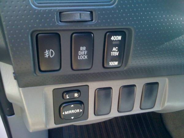

    Doesn't 4Hi and 4Lo lock the rear diff anyways? So why would I need this button....

    so why is there a need to have the diff lock button and the 4lo?

    When you are in 4-lo, that is just a lower gear ratio through your transfer case, It has nothing to do with having a locked rear Diff. Now on the Off Road models, it allows you to lock the rear diff. When you engauge the locker, it locks both axels ( left and right rear wheels ) together, so they spin together NO MATTER WHAT. Where as if you had an open diff, depending on the terrain, or tire placement one wheel would get more power.
    The only thing the Locker and 4-LO have in common, in this instance, is that toyota will only let you lock your rear end in 4-lo
    hope this helps

    because in 4 wheel drive, regardless of the gear reduction (4low or 4hi) only two wheels have power transfered to them in low traction situations. That would be the right rear and the left front.
    This is caused by the physics involved with open carrier differentials. (does not apply to sport models, as they have a limited slip carrier in the rear axle)

    Study up on how 4x works first. Basically when you put it in 4hi or 4lo you have made it so power goes to the front wheels. Now, think about driving your truck in a circle in a parkinglot, the outside wheels have to rotate more times than the inside wheels for the truck to get to the same place; let's say the outside tire fully rotates 15 times and the inside tire only rotates 10 times. You with me? good. Now for this to happen (wheels rotating differently around turns) your truck has an open differential which basically will put power to one wheel while you turn and let the other basically coast through the turn, since they are rotating differently. This mechanism takes stress off of drivetrain components, prevents uneven wear on your tires, and helps the truck not to slide out (fishtail) on turns. NOW, when you have a Locker engaged, it make both of the rear wheels rotate exactly the same and both having equal power; when you do the same circle in a parkinglot with a locker engaged, the tires will squeal and sometimes "hop", this is because the tires are being pushed or dragged because they aren't rotating naturally.
    It's like if you ever tried to do a donut in your truck, probably only 1 wheel did the peeling-out= open diff.

    I understand the deal about turning and one wheel having to spin faster and power going to two wheels in low traction conditions. But what are the driving situations when I would need to lock my rear diff? I know that 4Hi would be like when I am driving around town in the snow. 4Lo would be rock crawling or something like that. In what situations would the diff locker(in 2Hi) be useful?

    4 Hi can be good on trails and light crawling. 4Lo can be helpful in some slick offroad conditions and more intense crawling. I've used the e-brake locker to get outta some stucks. Heavy duty rock crawling uses it. I'm not really sure past that...but I know 1) I want one and 2) I wanna learn how to use it more...

    Everyone with a 4WD Taco needs to enjoy their truck and what it was made to do! 4WD LOW (L4) is for CRAWLING Up or Down steep grades, or deep/ stuck in the mud situations... SLOW is the beauty of LOW RANGE... You won't break things if you crawl over them. Low Range is for maximum torque power to the tires, not speed. As has been said above, you can't go fast in L4.
    Now, for the '09 and '10 Off Road TRD 4WD Tacos... We have the A-TRAC button to push in L4, this provides LSD (Limited Slip Differential) action so if one of the tires pops into the air or begins to spin from lack of traction, the opposite tire will now get power to pull you along.
    Earlier Tacomas had open differentials only, so once a tire looses traction, only it will have power and spin, uselessly. That is why we loved the LOCKING REAR DIFFERENTIAL... That insured at least both rear tires got power, even if one of them lost traction or was in the air.
    Maximum traction is 4L, A-TRAC and LOCKING RR DIFF. all working for you. This is for slow speed and to get out of the tough situation. Turn off the locker when you don't need it. A-TRAC will take care of you!
    For those of you new to four wheeling your new Taco, most of your four wheeling will be in H4. This allows higher speed and fun in snow, sand, mud. H4 is shift on the fly (from H2) and is automatically in TRAC (LSD) for front and rear limited slip traction.
    If you are in 2WD Taco (H2) and you become stuck (rear tires won't get you out) a quick push of the VSC OFF button turns on AUTO LSD for LSD braking action without regulating engine output. Those of us with 4X4 Tacos can just go into H4 for a better way out, but AUTO LSD is available in H2!
    If you want to spin donuts (H4 or H2) and goof off, hold the VSC-OFF button for 5 seconds while stopped, and the '09/ '10 Taco will be just like the earlier ones with open differentials. Touch the button again or re-start your truck and TRAC + VSC is reactivated.
    Have fun... I sure am!
