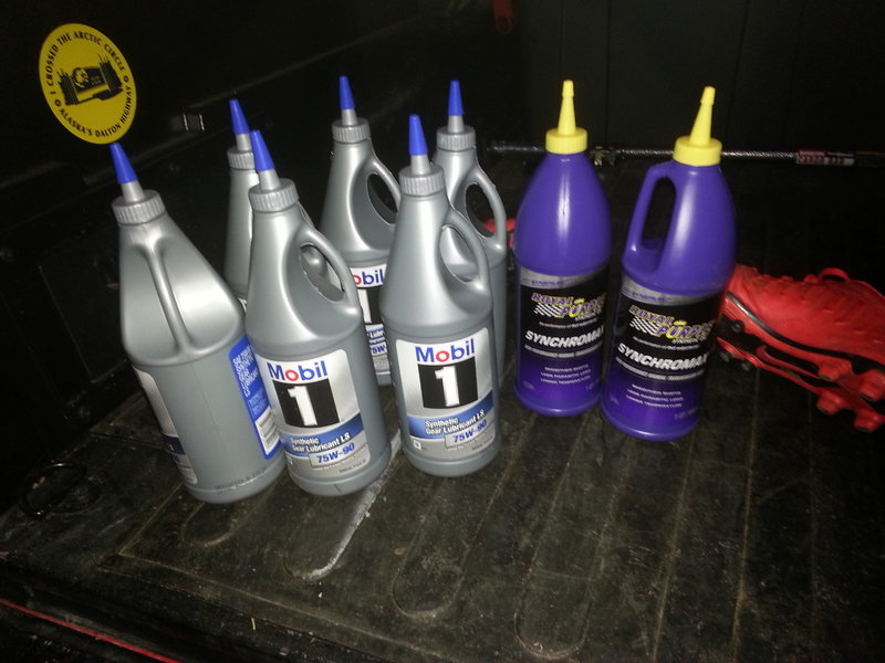

    Almost there. Hopefully one last question(regarding transmission): I went to Pepboys, they carry Mobile -1 but not the Redline 75w-90 NS thing that people here talk about. Instead, I bought Royal Purple - which just says "high performance manual trans fluid" This thing is expensive, any thoughts about this brand? It does not show the weight anywhere. Do you want me use Mobile-1 instead?

    The only oil you should even consider in the manual transmission is Redline MT-90. NOTHING else. The issue is the synchros. I use it in the TC too. Front diff gets Redline 75-90 GL-5 gear oil, and rear diff gets Redline 75-110 GL-5 Gear oil ( I was using 75-140 until the 75-110 came out. I do not have limited slip,...ARB air lockers at both ends.

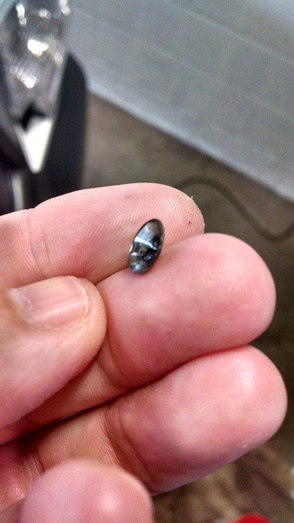

    Found this in the rear differential, attached to the plug's magnet:
