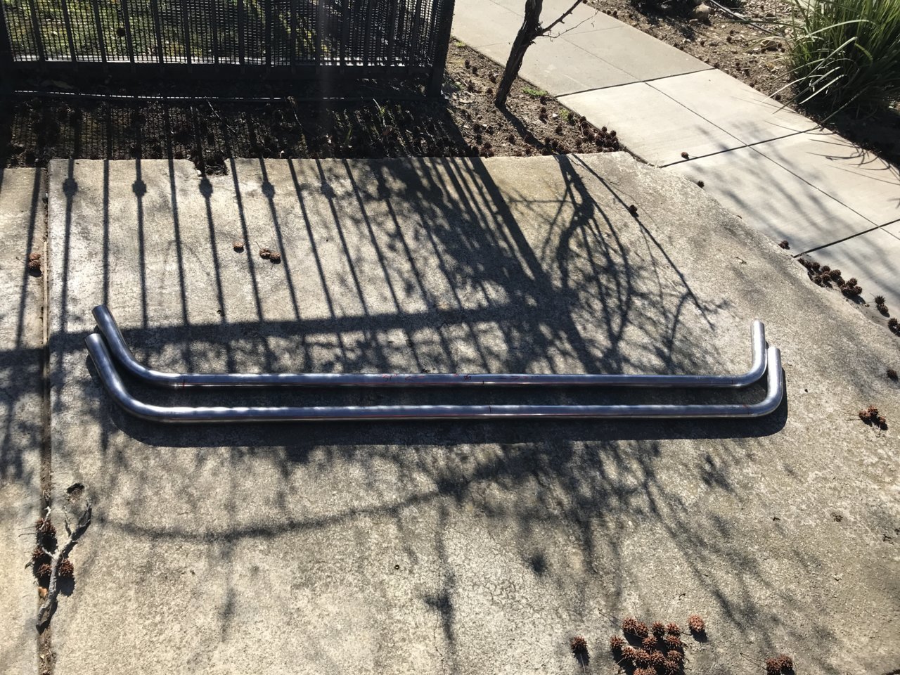

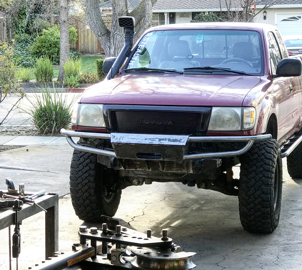

    jd^2 model 3 manual bender. With a homemade stand. The die is 180 degree with 5 inch center line radius for 1.75 OD

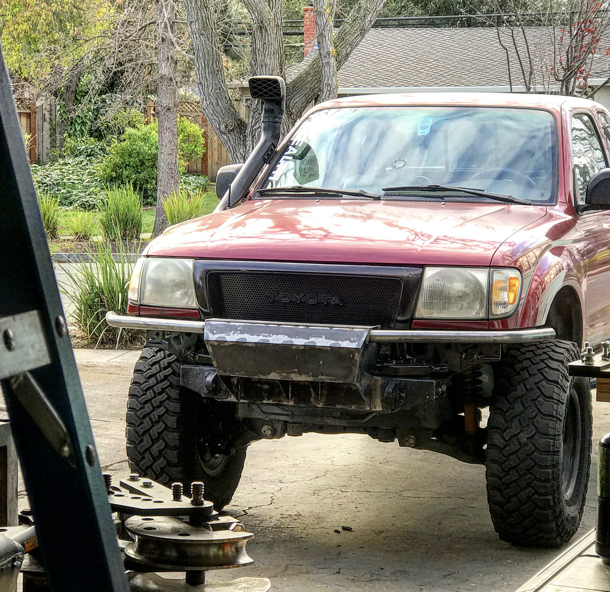

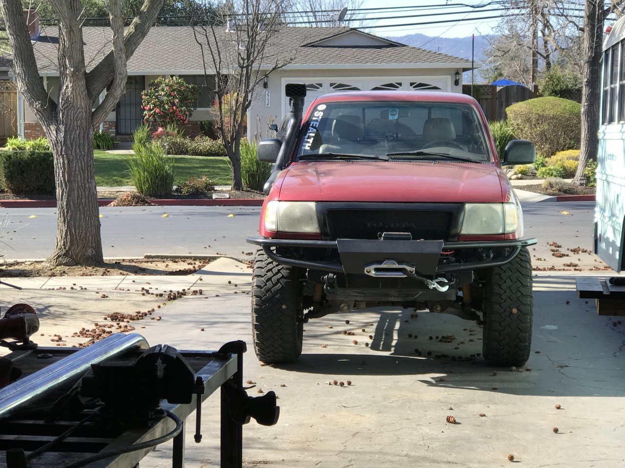

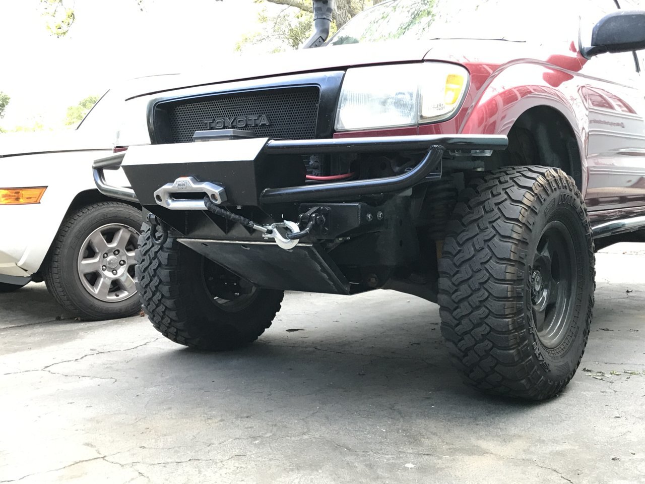

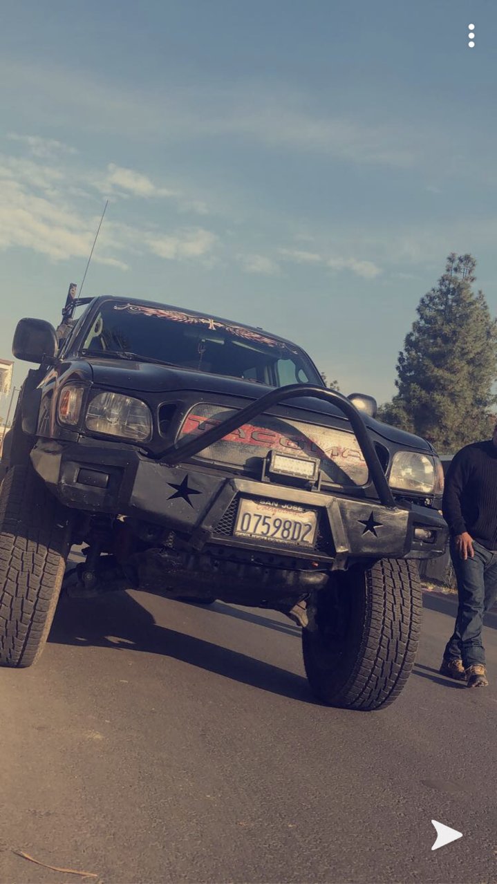

    Forgot to update: bumper has been painted and winch is mounted. 36895ACB-6483-4981-AC41-2EEEBA91454E.jpg

    @Talon2142 is also going the DIY route for his sliders and needed some tubing bends. 84CA7381-8028-4887-8266-54F58E215342.jpg

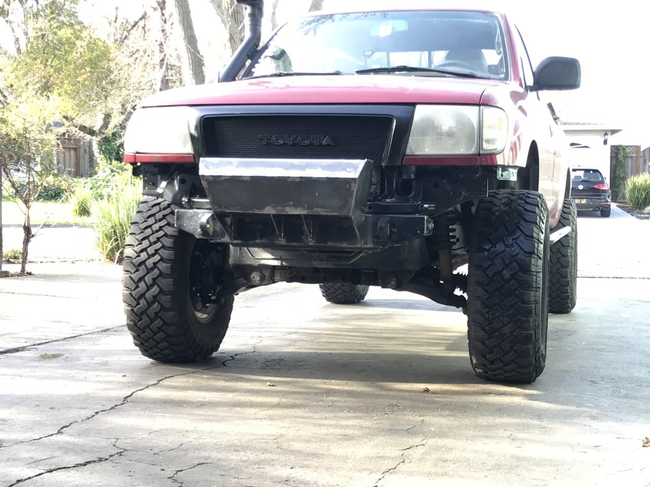

    Here’s a little sneak peek

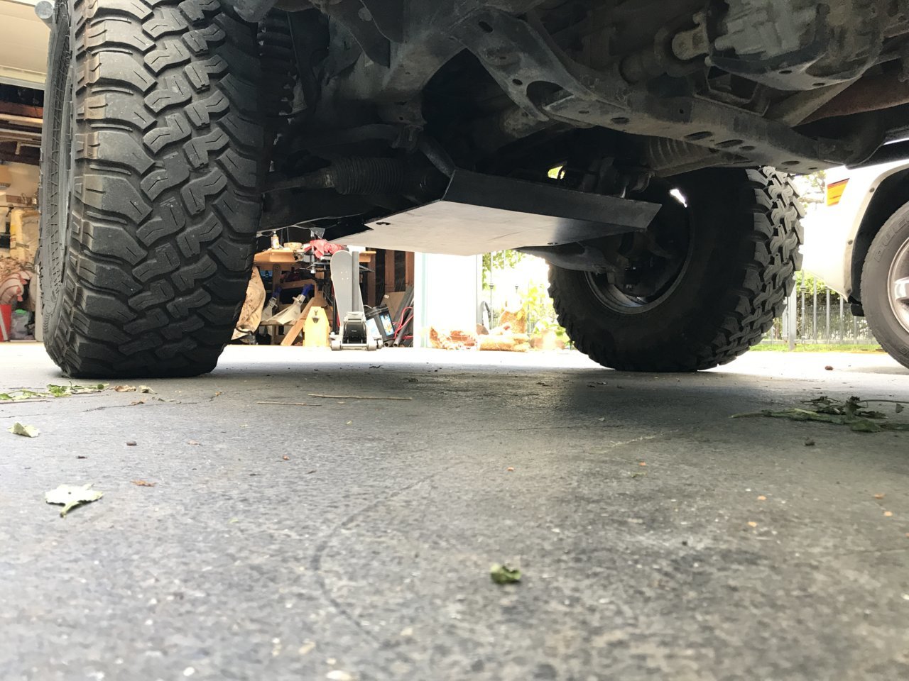

    I just used my stock skids and transferred the hole patterns to two prices of 3/16s (one is mounted to the bumper, other is mounted to the cross member.) Then just bridge it with plate.

    Needs some paint and off to the next project

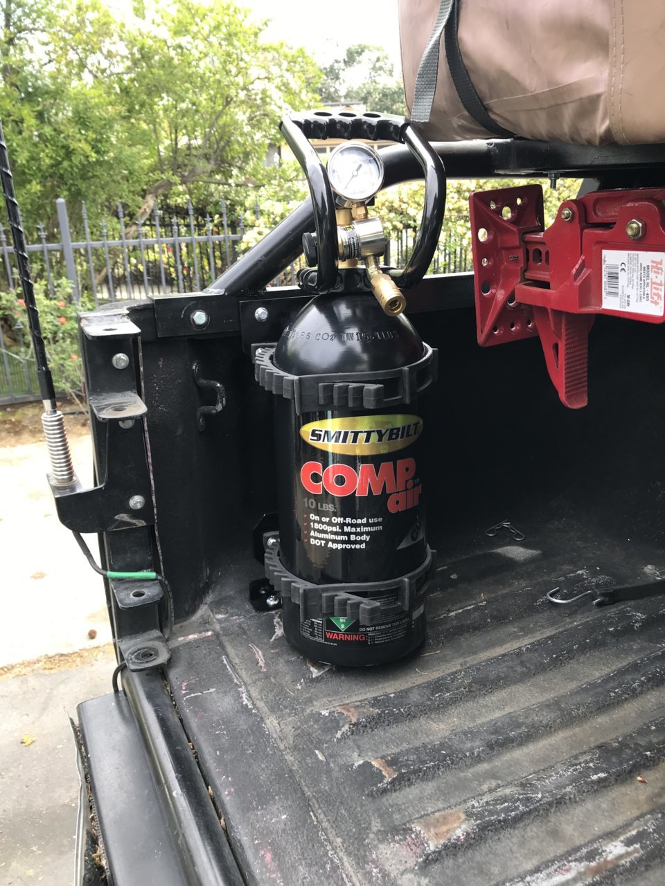

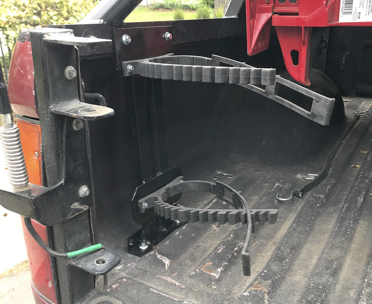

    As for updates, I picked up a CO2 tank and currently building a mount, nothing exciting it will be mounted inside the bed.

    Building stuff has been on hold due to moving, no garage anymore but have basement so the fabbing continues! Got to test out the CO2 mount on a short camping trip, worked out great!

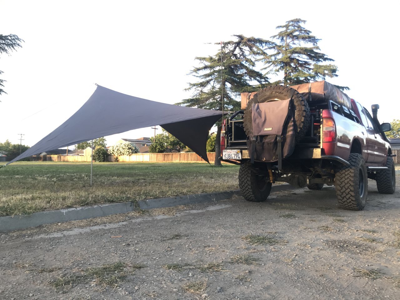

    2000 T4R Limited
    Purchased two triangles:
    Sekey 10'x10' x10' Triangle Sun Shade Sail PES Polyester Canopy Waterproof UV Block Weather Resistant Durable, Big Shadow, Perfect for Outdoor Patio Garden Yard Backyard, Dark Grey https://www.amazon.com/dp/B07TLJ2MQL/ref=cm_sw_r_cp_api_i_p77QEbC8EH4BZ
    And 1 telescoping tent pole:
    Stansport Telescoping Tent Pole https://www.amazon.com/dp/B004Z10D16/ref=cm_sw_r_cp_api_i_O87QEbFJPW657
    4 carabiners, Paracord for tie down lines, heavy duty tent stakes and made a small bracket to mount carabiners from triangle shades to pole.
    Note: Pole is on the shortest setting.

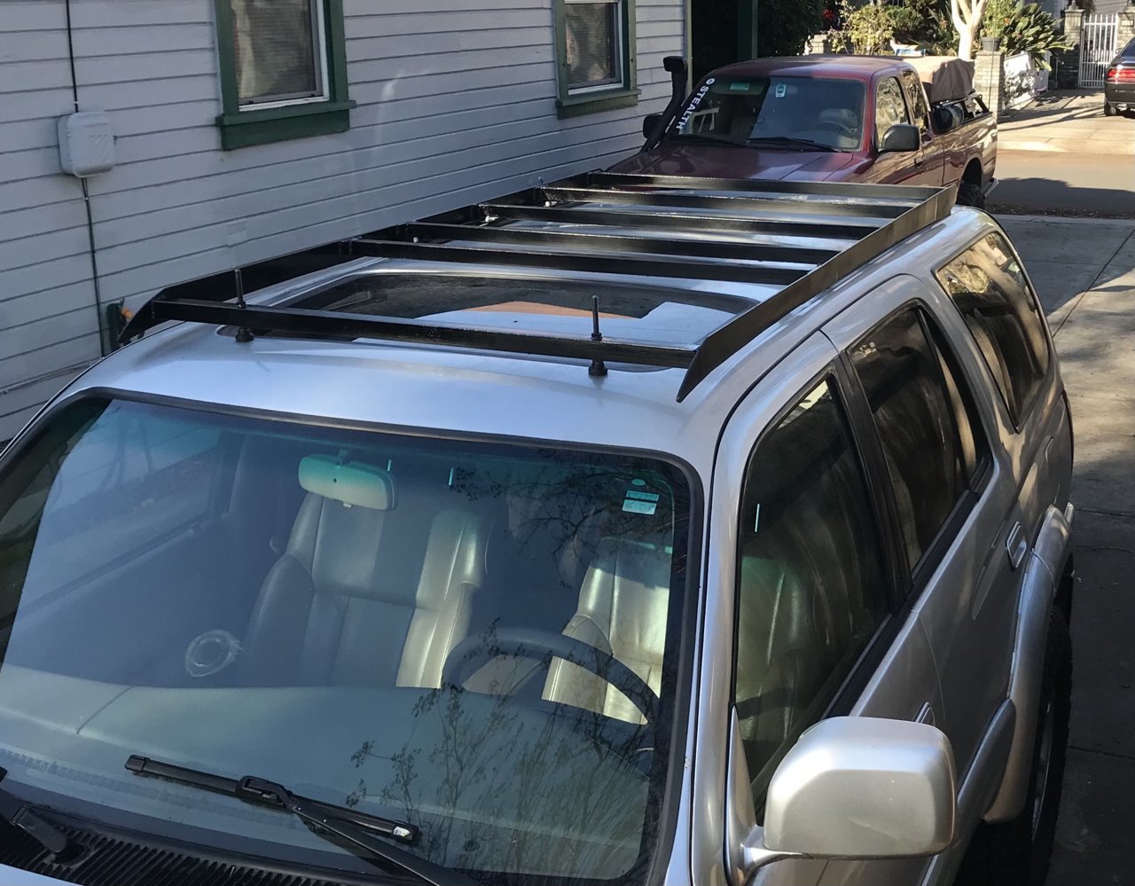

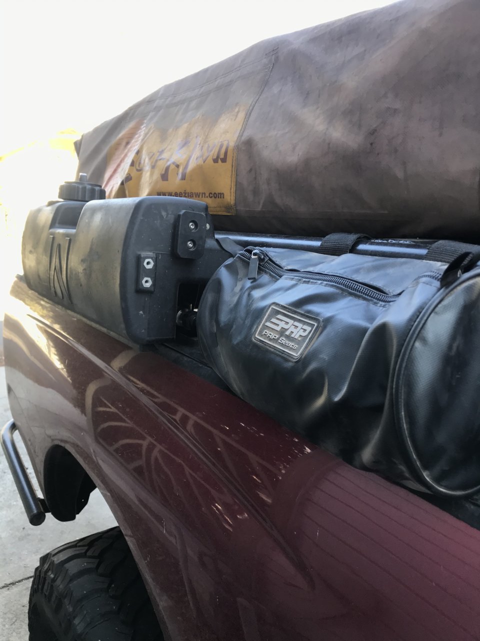

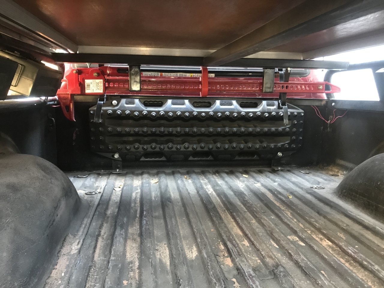

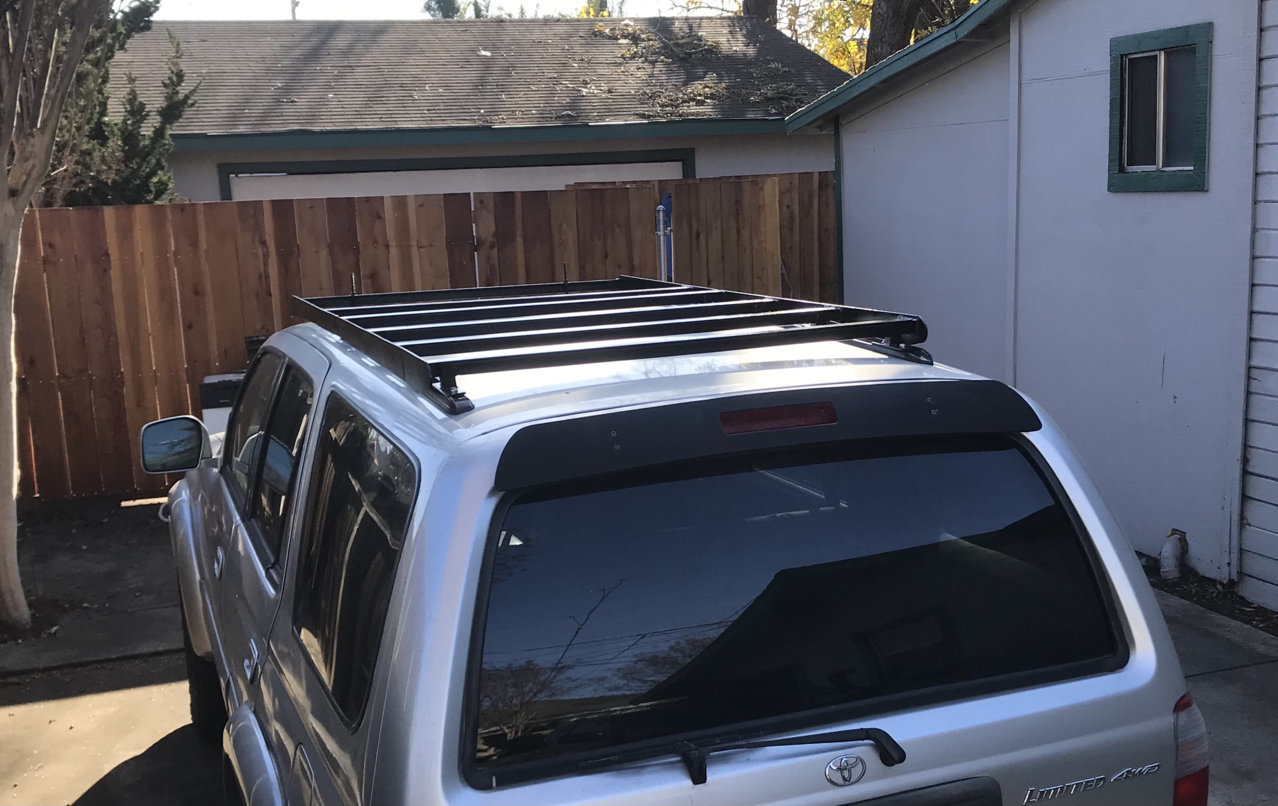

    Made a mount for the waterport, max trax and the runner got a new roof rack(still need to add the fairing)
    1626F54D-D6AC-499A-B2C5-466A7B7F9A54.jpg 199261D8-A98B-4E6F-A7E5-C6F07FF50E2D.jpg 0DFE843B-31AA-4E0D-91B7-D2D6F87ADF47.jpg 14729F50-4421-4F79-9549-329847ADDE73.jpg
    added fairing, mounted the tent and made some paracord handles 48242774-6847-44E9-99E5-E1FF03F93318.jpg
