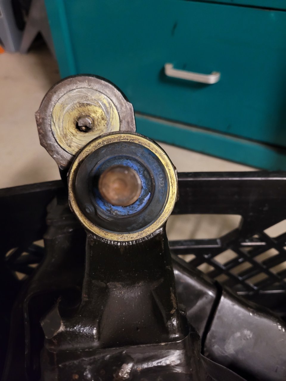

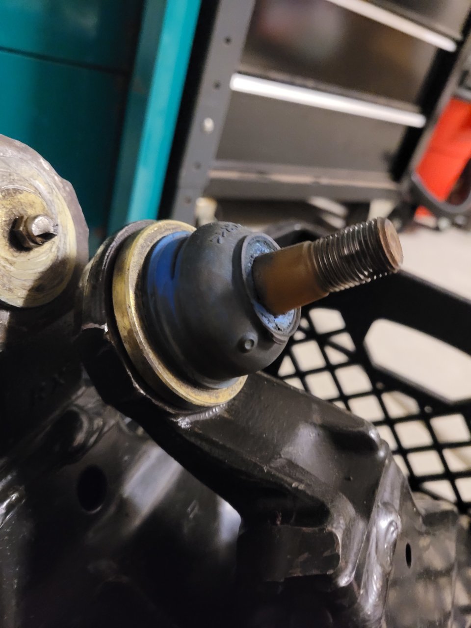

    Bump for help..... I have a set of lower arms I'm rebuilding.. I already pressed in my white line bushings.....
    The problem I'm having is the arms currently have moog ballpoint that need to be pressed out and these moog have really big lips on them to where none of the ballpoint kits reciever tunes fit that I have purchased. There is very little room for a cup to rest on the arm but over the ballpoint.
    Has anyone here ever replaced moog lower ballpoint on the lower arm?

    That's OEM ballpoint which has a smaller od lip on the ballpoint so you have more room to fit a sleeve

    If you’re removing them anyway, just get at it with a cut off wheel and get yourself some more room.
    I know none of the kits I tried were the right size when I replaced my oem bj’s with moog so I ended up modifying one to make it the right size.

    Yes, you need a 3-inch long cup/tube with a 2.5" ID. A metal yard should be able to cut you a piece for cheaps. A DOM tube is ideal - one without an inside seam, or you can grind it out, as I did. The wall should be 1/4 or 3/16 thick. Mine is 3/16ths and I dont think a thicker walled tube will fit.

    I don't have alot of metal supply companies where I'm at....
    I got frustrated and accidentally everything with a grinder lol.
    But the balljoint is out :)
