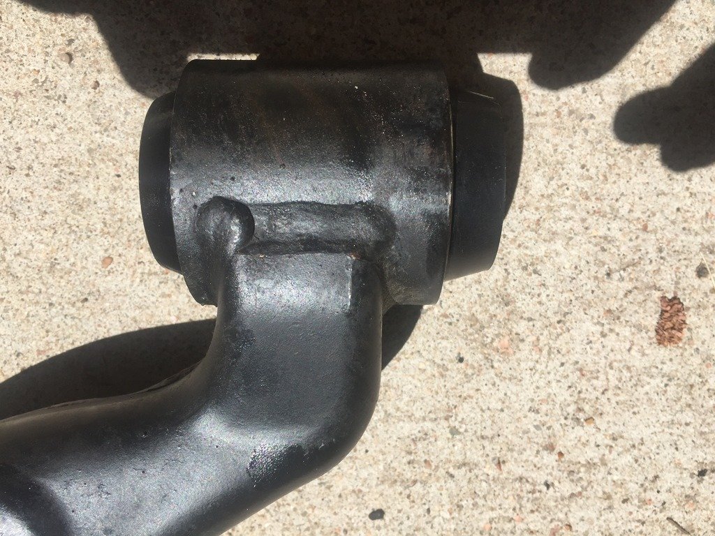

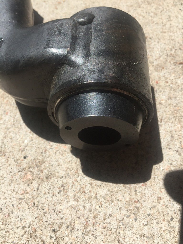

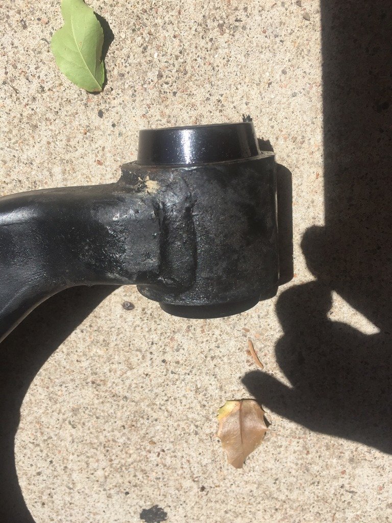

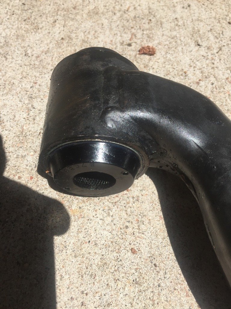

    Well I got off my lazy arss and put my white line bushings in. They fit perfect!!!

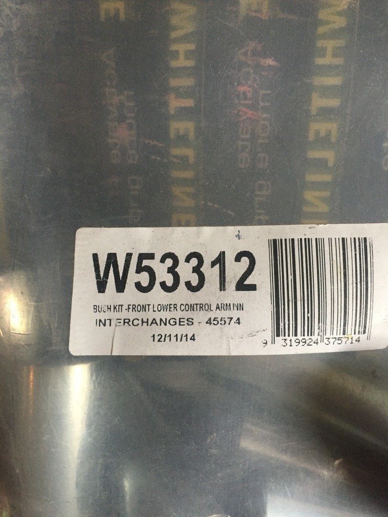

    Can you share the part # for the Whitelines, thanks.

    That could be. I took detailed measurements of mine with a slide caliper of the Whitelines... I should post them before they get lost...
    Just so you know, the Whitelines don't go in by hand at all. Maybe 1 CM, then have to be pressed, so similar to what you had originally reported...

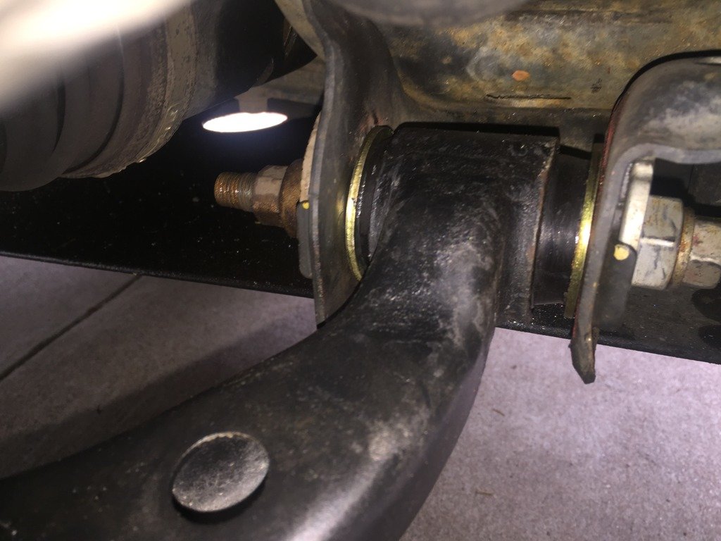

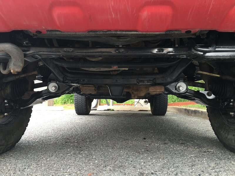

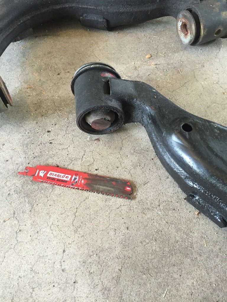

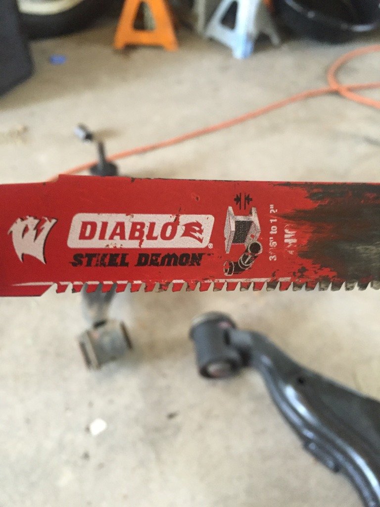

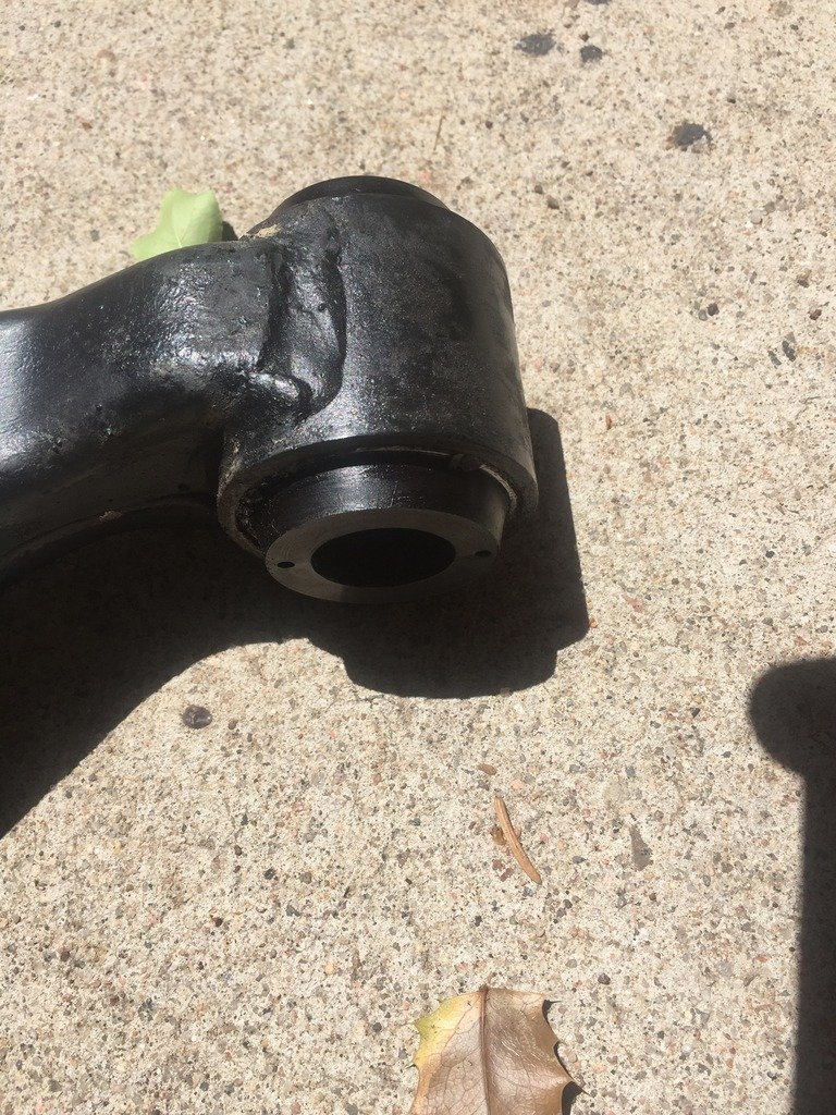

    Well I broke out the sawsall and put in some work and got the lcas installed. Went through two blades and it really wasn't that's bad of a project. Figment was really good too
    1F359035-9522-4B31-B310-10EFD42628C4_zps_865399b04d205473f386a5b2e3109d7399d832a8.jpg
    F2911C36-71AE-423B-85F4-9E7A34C7DEBC_zps_039512b113537272c05c558a9b1b0daa02b8927a.jpg
    42C781B7-C3A3-4E0F-8ADA-0A8B281C73DD_zps_5ce8d55b7ed083fbb5a0825aa6979b60ec525772.jpg
