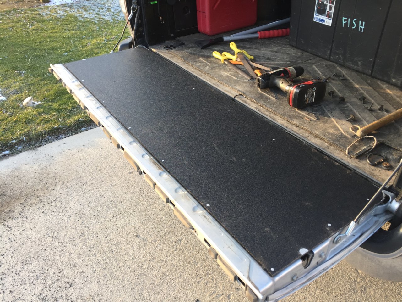

    Went to the junkyard found a K body with an aluminum tailgate skin, yanked it, trimmed 4" or so off one side, ripped the plastic crap expanding square "nuts" out of the tailgate skin and replaced them with 1/4-20 riv-nuts, reglued the inner tailgate frame to the back of the outer skin with structural 2 part apoxy adhesive, coated the mating surfaces with FIPG, drilled new holes in the diamond plate skin, affixed with stainless "sidewalk" bolts.
    BAM:
    Cost me like tree-fiddy.

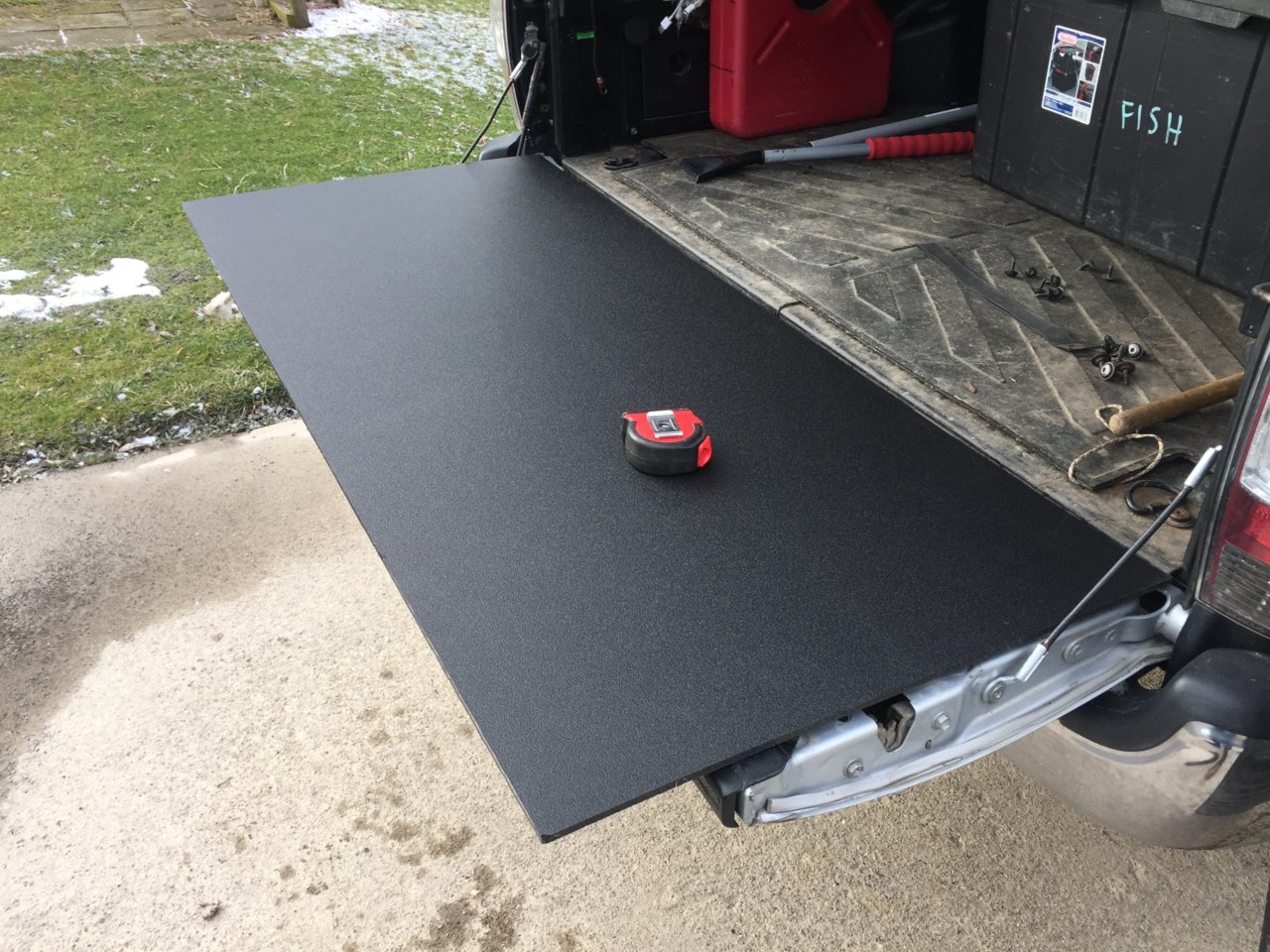

    HDPE showed up today.
    New new hardware inserts showed up too
    I’ll start on it tomorrow

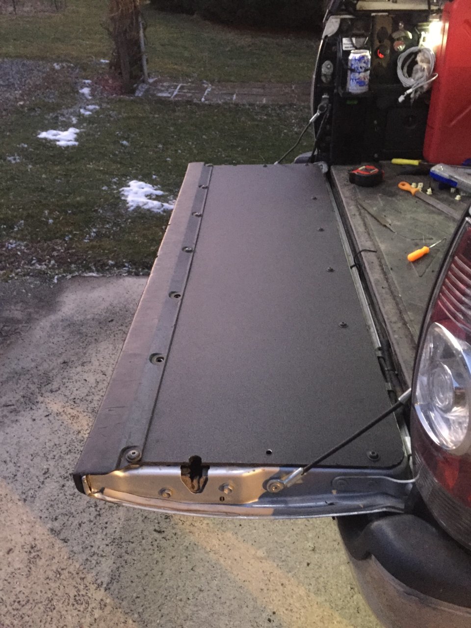

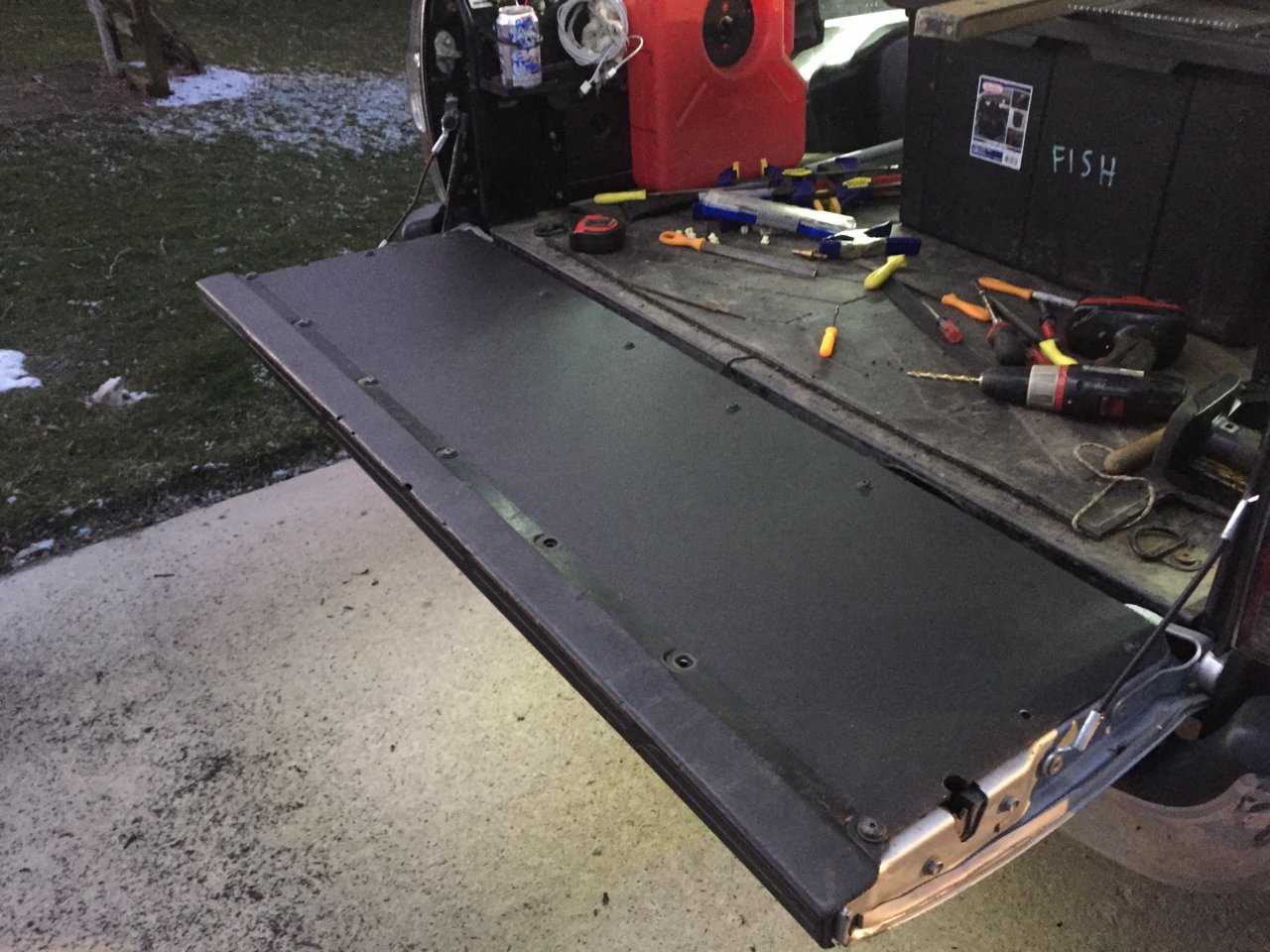

    Done and done.

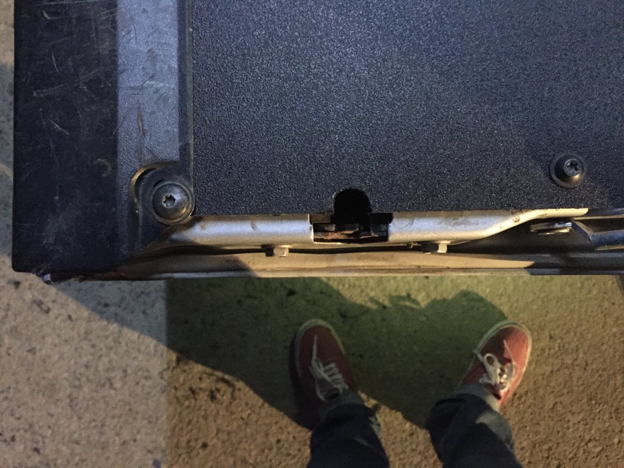

    99% happy with it. The bottom edge is about 1/8” too long and it binds the slightest bit when shutting the tailgate.
    I’m gonna pull it off tomorrow and rip an 1/8” off that edge then install the new screw retainers and install it for good.
    I may explore the option of countersunk hardware down the sides and along the bottom.

    Looks good OP!

    Looks nice- you happen to have a link to the place you bought the hdpe?
  12. Feb 14, 2020 at 3:50 PM
    #32
    steveo27
    steveo27 [OP] Ask me about my weiner
    Aug 12, 2013
    #110326
    6,084
    Steve
    Pittsburgh
    '11 TRD Off Road & 1992 VW GLI
    The same shit everyone else has.
    https://www.ebay.com/itm/142754668242
    It’s 24”x54” I wish it was a 55”.
    You can see it’s about 1/2” shorter than ideal on each side.
    The next size up is 24”x48” but the extra cost wasn’t worth it to me.
    eBay is the only place I’ve found with free shipping on hdpe. They have 3/8” and 1/2” as well I believe

    Bird nest engine bay.
    Came out very nice OP!!! Love the beer holder as well!! Time to toss my ply wood and get me some HDPE !!!
    Maybe i'll take out my tailgate panel and trace it!!! onto the HDPE.

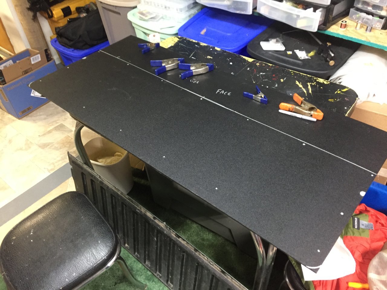

    Thanks. Cup holders are an essential part of camping.
    That’s all I did. Traced it and cut out.
    The only issue using the oem panel as a template is the bottom edge hangs down too far.
    The tailgate won’t shut because the HDPE is a little thicker than the oem panel so I had to rip 1/2“ off that edge to make it fit. It still binds a tiny bit and I plan on ripping another 1/8” off of it it to remedy this.
    So all said and down, the bottom edge will be 5/8” short than the oem panel.
    You could probably cut the bottom edge with a 45* bevel and it would fit without ripping it. Or if you wanted to get fancy, you could hit the whole thing with a router.
    I chose to rip it and keep the 90* edge since no other edge is beveled

    Thinking about doing this and buying one of the kB voodoo metal lips for the top edge...
    how do you feel about the 1/4 in thickness? Does it add any strength or weight to things or about the same as stock?

    One thing different I did with mine - lay out centers for an additional rivnut into the center of the internal cross bars. Mostly was thinking it would help avoid rattling on a rutted FS road.
    steveo27[OP] likes this.

    That’s not a bad idea at all. I may explore that using sountersunk hardware if need be.
    No additional strength or weight. I wouldn’t do jumping jacks on it, but standing on it was fine. It does flex a tiny tiny little bit.
    You could use thicker HDPE but you’d have to router the edges down to 1/4” where it meets the edge of the bed similar to how the Mountain Hatch is. Or cut a smaller piece of HDPE so it doesn’t quite extend out as far, but you’d lose the oem mounting holes.
