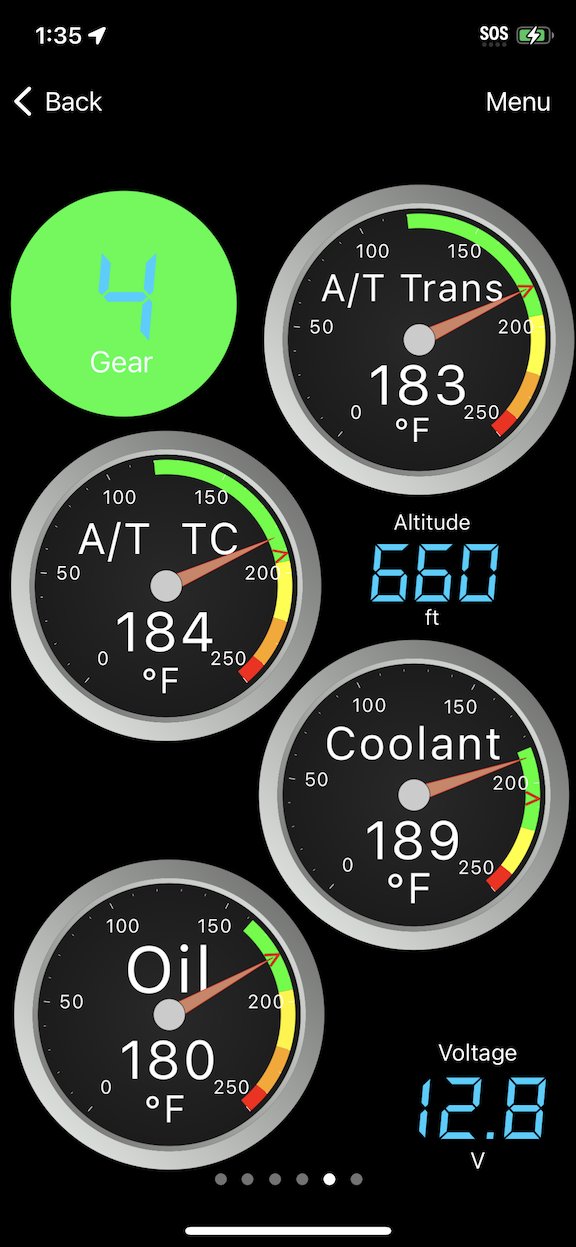

    Scan gauge is the most popular PnP option. I run a popular app called OBD Fusion. This will require an OBD dongle like below and you must create custom dashboards.
    https://www.amazon.com/gp/product/B073XKQQQW?ie=UTF8
    There are 2 bid threads on how to make dashboards. It's much easier to go to the swappin' thread, download one someone else has already created, and customize it to your needs.
    https://www.tacomaworld.com/threads/obd-fusion-tips-and-tricks.590248/
    https://www.tacomaworld.com/threads/obd-fusion-dashboard-swappin-thread.683932/#post-24114304
    Here is the dashboard I run when towing the camper. I run this on an old iPhone and always have it up.

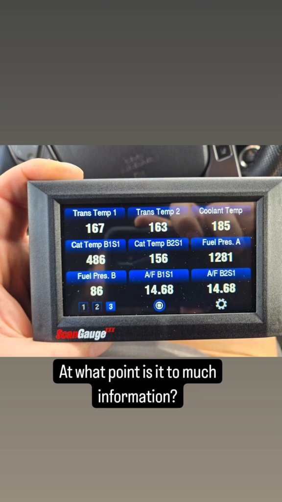

    I'm late to the party, but we're setting up our Taco for trailer towing and am curious how much real estate the SG3 eats up. For reference, I have a 7-inch screen on a magnet mount to the right of the steering wheel, so I'm thinking of putting another just to the left (on top of the dash trim, but not blocking the dash vent) and putting the gauge there. I like the larger screen and auto features despite the SG2 being able to mount on the steering column. Just concerned it'll take up too much room.

    It's not a small unit by any means when compared to the SC2 but I found the screen a pain to read in comparison so that's why I went with the 3.
    I was going to add a picture of it mounted but apparently I don't have one. So here's one of it in Hand that may help.

    I appreciate the photo. Looks manageable and, since Autozone is having a 15% sale this month, I may just swing up there and snag one.
