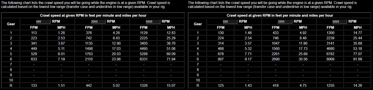

    It sounds like you are talking about true crawling versus what most consider offroad? There is a true crawling thread that is pretty epic, but well beyond me:
    https://www.tacomaworld.com/threads/3rd-gen-true-crawlin-thread.613915/
    Folks there might be able to give a good answer to your question.
    For the offroading that I have done, the MT has been stellar. About 7/10ths of what the stock setup can do. The lower gearing, control, and Austin Powers u turns have been great for me. Note that 5.29 gears on an AT are just a bit lower than the 4.30s on the MT.
    MTs have the Clutch Start Cancel button that folks on ledges and such really appreciate.
    ATs with the OVT GearLock tune would have close to MT control over the transmission.
    For fun, MT on the left and AT on the right. Stock except for 265/70R17 tires:
