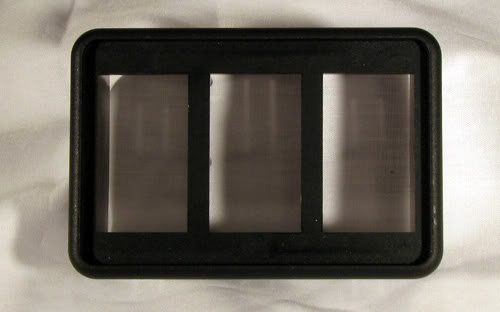

    One more favor please. Looking at the picture of the switch blanks, it looks like there isn't room for the carling switches in there. I know you generally have to trim the sides of the switch blank opening for the carling switches and it doesn't seem like there is enough room to trim. So I was thinking of ordering the switch blank holders from OTRATTW and cutting out the space and putting them in that way. Can you find the measurements of the flat area for the buttons?
    Three switch holder:
    Cutout required for installation is 3.05 X 1.90 inches
    Finished dimensions are 3.40 X 2.30 inches
    Four switches
    Cutout required for installation is 4.08 X 1.90 inches
    Finished dimensions are 4.434 X 2.3 inches
    Do you think either of these would fit?
    Thanks so much for being everyone's Guinea pig. :bowdown:

    id have to check...post a link of what switch exactly so i can look...
    im running the same blank covers from the 09 on this piece...i know there are new blanks now
    but from what you say, it may fit
    no prob...gonna post my 09 dash for sale soon

    Yep, that's why I was thinking I would just have to cut out the entire panel and put in their switch holders. I was wondering if the area is big enough for the switch holders or not.

    im pretty sure theyre not big enough...so trimming will be required

    I think we both agree that trimming is required, I am wondering if the flat area would hold the size that the OTRATTW switch holders would need to be without overlapping over the edges. I am not sure if I am communicating clearly or not, so my sincerest apologies if I am confusing.

    it may fit...i would need to check one of those buttons to see how much need to be trimmed
    now im curious because i plan on adding a locker and this is where i plan on adding the buttons

    These are the dimensions of the switch holders:
    Three switch holder:vm3_98cb51b936eb28ed0ac8051956e48eda1f2ae0e0.jpg
    Four switches
    And here is a link to a thread I found on installing these particular switches and how much to trim.
    http://www.tacomaworld.com/forum/2n...-contura-v-carling-stock-switch-location.html

    ya that panel wouldnt fit on there...id rather just cut the piece on the existing panel...i wanted to try to fit a 5 switch and completely move the 12 v accessory plugs on a new spot
