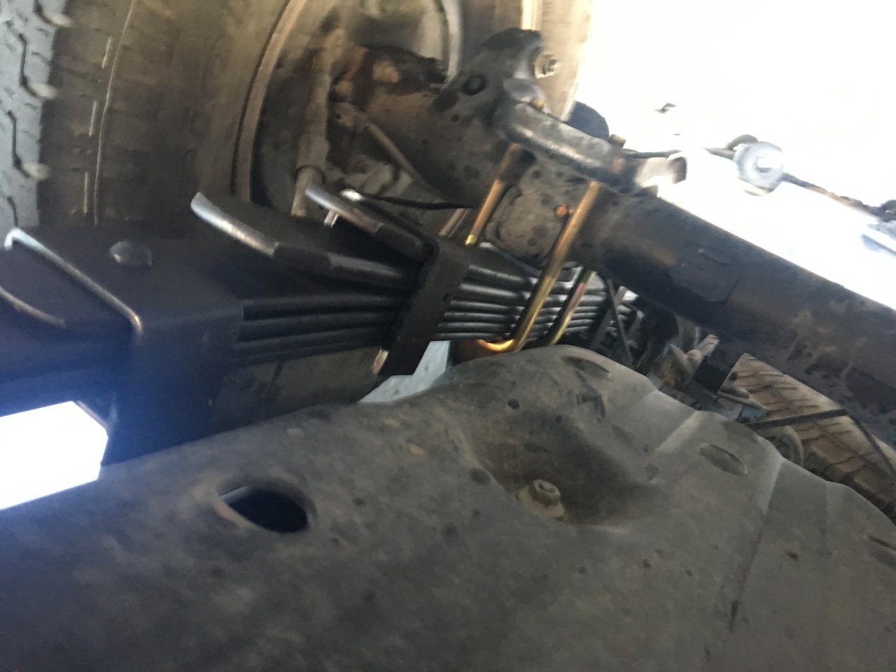

Does thes dakars look correct ?

    Looks upside down
    These trucks have a flat leaf, even with aftermarket leaf pack. I'll try to get a pic of my Dakars later today.

    Do you have a topper or/and stuff in the bed? I was thinking I might need to add another leaf to my OME pack, but I have the older packs that are more equivalent I think to the current heavy duty EL096R.

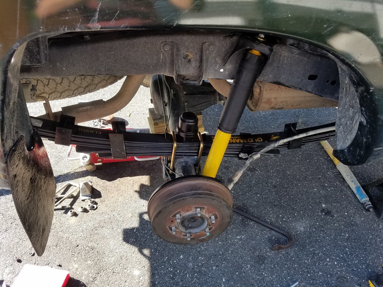

    Yours:
    My CS047R:

    Empty 6 foot bed

    What did you torque the u-bolts to?

    Possibly over torqued at 85 inlb? Yes -very rarely carry +300 lbs so I got the lighter packs- 25 1/4 inches center to fender.

    Torque to 85 ft-lb isn't excessive. The book says 37 ft-lb but mostly everyone thinks that's a typo. It's either supposed to be 73 ft-lb or something like that.
    Greater than 25" sounds fine, mine are right about 24" center to lip with a camper shell and a bunch of junk back there.
    I don't have the original measurement but they will settle a bit. They sure do look odd, though, like they are slightly in recurve.

    Have you driven it since the install? They can look funky right off the jack stands.

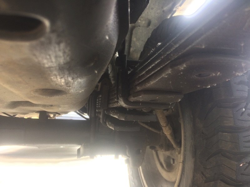

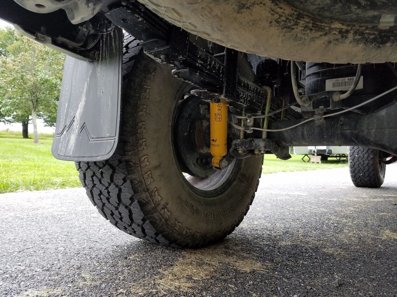

    Mine look weird too. Had them on a few months now and no performance issues, just really funky looking 20170901_174104.jpg

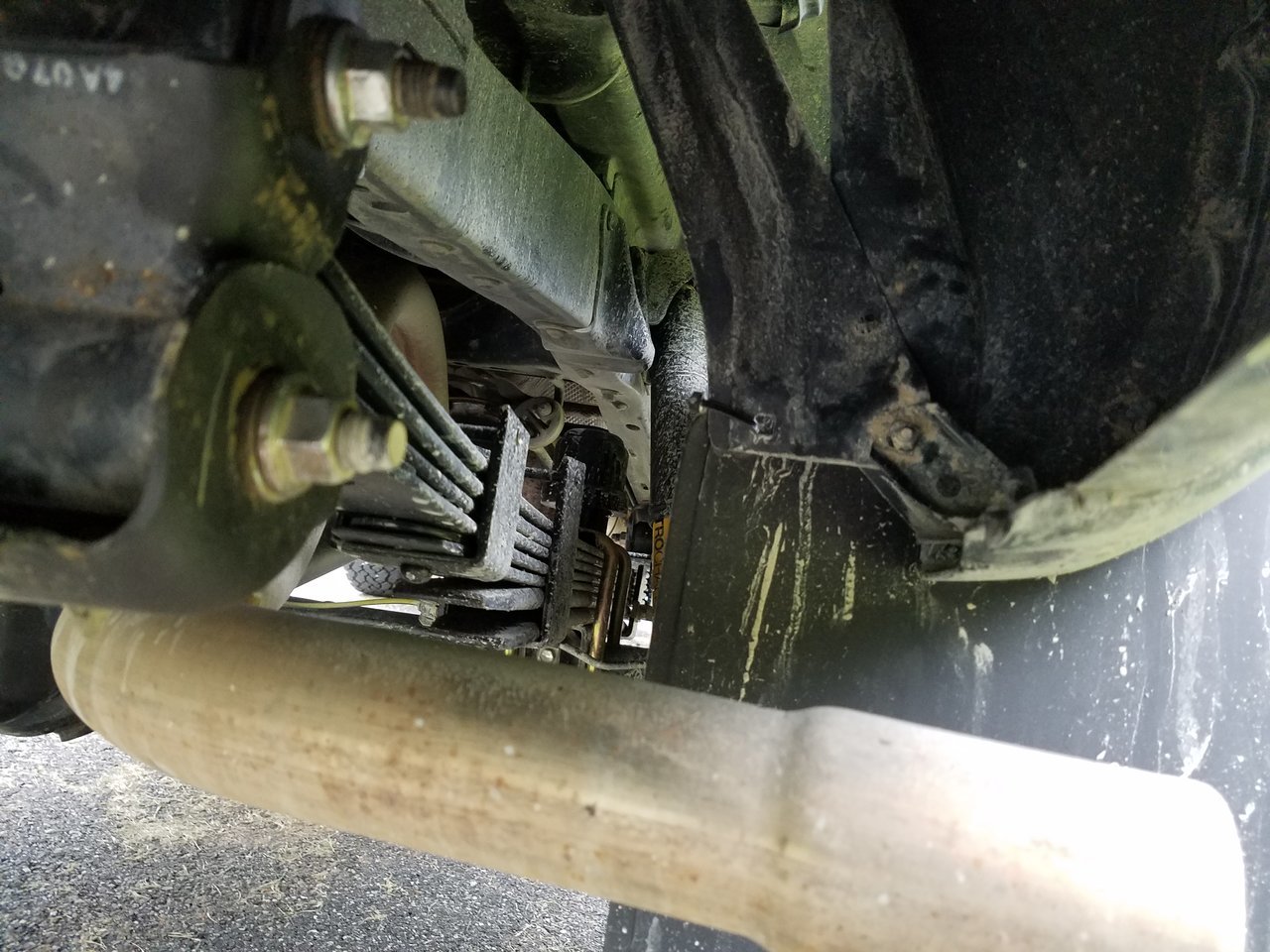

  12. Nov 6, 2017 at 1:36 PM
    rollin904
    rollin904 Feather Slinger
    Apr 11, 2011
    #54724
    2,348
    TJ
    Greenville, SC
    '14 DCSB 4x4
  13. Nov 6, 2017 at 1:41 PM

    Kind of looks like you have the W curve going on. I noticed that i have that also when I'm parked on an incline, like my driveway. Recheck on a flat surface?

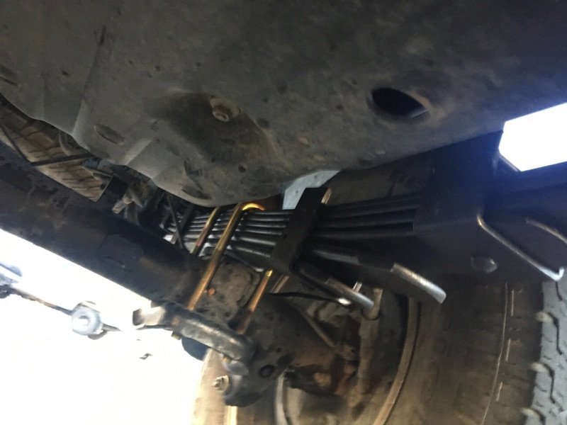

    That does not look good or right for brand new packs.
    This looks right
    Nope
    Op, where did you purchase them from? Maybe get with them. Your after lift height is in the ballpark but damn the pack looks flat.
    There are a couple good threads in here that discuss the "new" Dakar packs in detail and all the pics I've seen don't reflect what I'm seeing here.
    I've got some 96's waiting to be installed and when they are and if they looked like that I would be giving my vender a call.

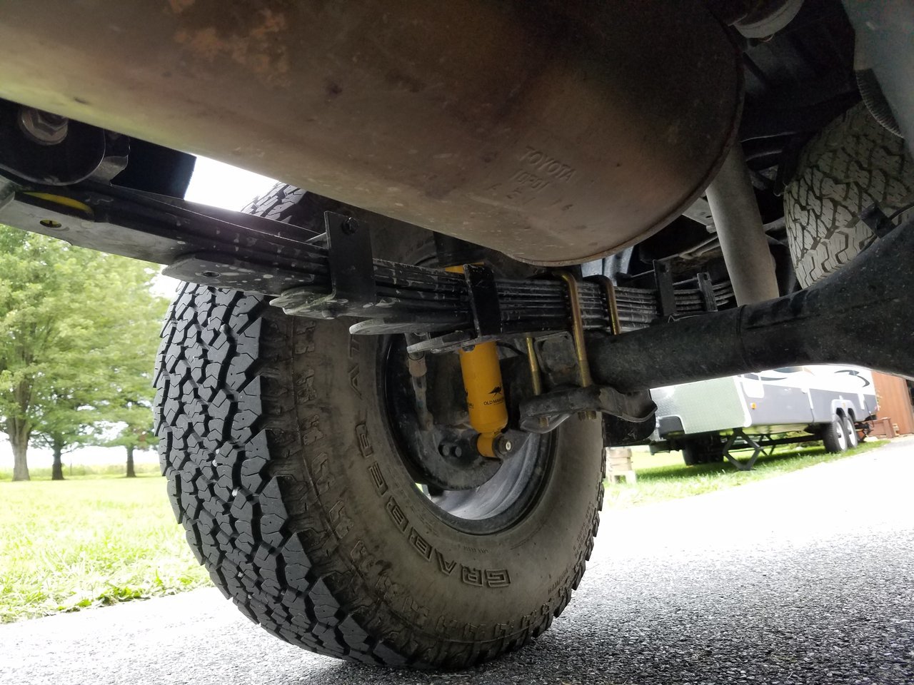

    You'll probably end up in the same boat as us :)
    Here's a thread where some similar observations are discussed https://www.tacomaworld.com/threads/post-pics-of-ome-dakar-leaf-packs.282883/
    I bought my stuff from @HeadStrong Off-Road, a reputable vendor, and I've spoken with ARB and they confirmed the packs sit with a wavy appearance at the axle. I can't say I've loaded my truck down since adding these and since I'm running HDs they may look quite different when they're near weight capacity. I know I went from 1.5" lift to 3.5" lift in the rear, and that's with a cap
    Here's my packs they day I installed and without any weight:

    You guys are getting lift but they look weird, so that's the rub, isn't it? OME springs have never been perfectly curved though. They seem to have a flat area over the spring perch that I believe is intentionally put in to minimize the stress you'd put on them pulling them flat with the u-bolts. I dunno, if Headstrong and ARB both think it's OK then I probably wouldn't worry too much.
