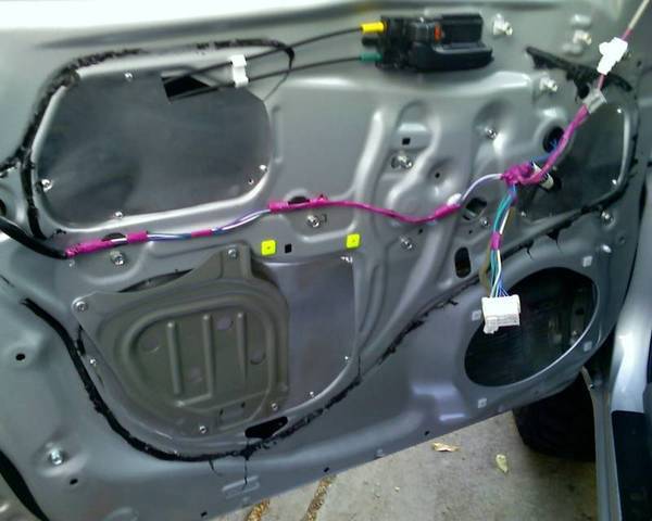

    After some research, it looks like my first change may be dynamat, raamat, second skin, etc. for the doors. Still trying to find which one of these best fits my budget and the best place to buy it. Any suggestions?

    I used Raammat. One roll was enough to to all four doors inside and out and the area behind the left rear passenger seat. They also have a Tacomaworld discount.
    Inside (I two layers of Raammat behind the speaker area):
    Aluminum flashing to cover the access holes.
    Outside:
    Ensolyte:
    I have before and after recordings that I did in the cab of my truck so I could see if there was a perceptable difference. I uploaded two sound files with the same radio settings, one before and one after:
    http://www.tacomaworld.com/forum/audio-video/19912-raammat-finished-2.html
    I also did some screenshots of an audio program which shows the waveform of the two recordings before and after (all stereo settings and equipment was the same):

    Definite volume improvement based on your clips! How much did it cost you to purchase all the stuff?

    It was about $200 for the mat, the ensolyte and the adhesive spray (for the ensolyte).
