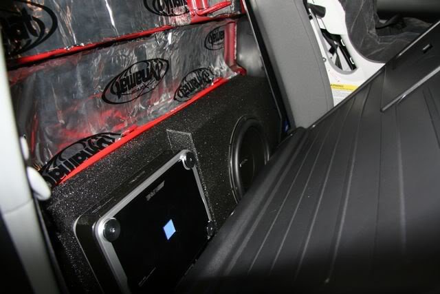

    Yes I do make an enclosure for that situation Cortland and it's actually one of my most popular designs.
    Below is the short version that fits below the child seat tethers keeping them usable and I can also build it the full height if needed for larger amps/more airspace.
    You can also see other designs on the thread below as well as at the photobucket link in my signature.

    Awesome! What do you charge for the short one and the tall one? How much airspace does each one have? Also, I was curious to know how much you charge for 6.5" speaker mounts for the front and rear?

    I build each one for the specific amplifier/subwoofer so the airspace varies (I use the back side of the amp rack for additional airspace) and the cost varies accordingly. If you are not sure what gear you will be using and need help deciding just let me know as I have numerous lines of car audio gear available as well (if I don't have what works best for you I'm sure I can direct you to someone reputable who does)

    Building the enclosure with the proper airspace for the MTX would not leave enough room for the amplifier (even with the tall version). The Pioneer shallow sub requires quite a bit less airspace so you could go with the short version "all in one" and have room for the amp as well (maybe not the bigger Pioneer amp you posted but for sure the smaller one or the MTX you have)

    How much airspace would you the short version "all in one" with the spot for either the MTX or Pioneer amp have? What is the mounting depth for this enclosure? and how deep is the amp rack? What would the pricing be for the short version?

    I usually go with Pioneers recommendation of .45 for the shallow 10 unless asked to build it another specific size. Sub mounting depth max is about 5.75" and is totally dependent on basket shape/size and magnet shape/diameter. The depth of the amp rack varies according to airspace needed, amplifier used and depth of sub with max amp height about 2 3/4".
