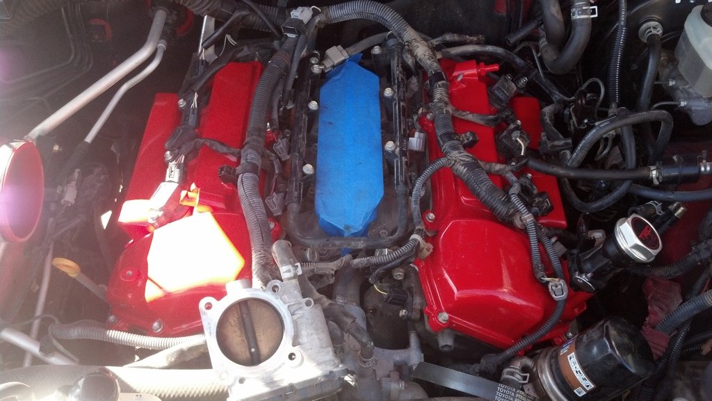

    u dont have to drain the coolant. just dont disconnect the hoses going to the throttle body
    good example right here. this was after removing supercharger but u can see the coolant lines are still connected to the throttle body and the fuel rail right there on top

    Thanks! I am running a can of seafoam through the tank right now. If that does not do it I might run one through the brake booster vacuum line. If Ihave to tear it down that far I am goibng to do all 6 injectors. The pic was very helpful. This is what I love about this forum.
