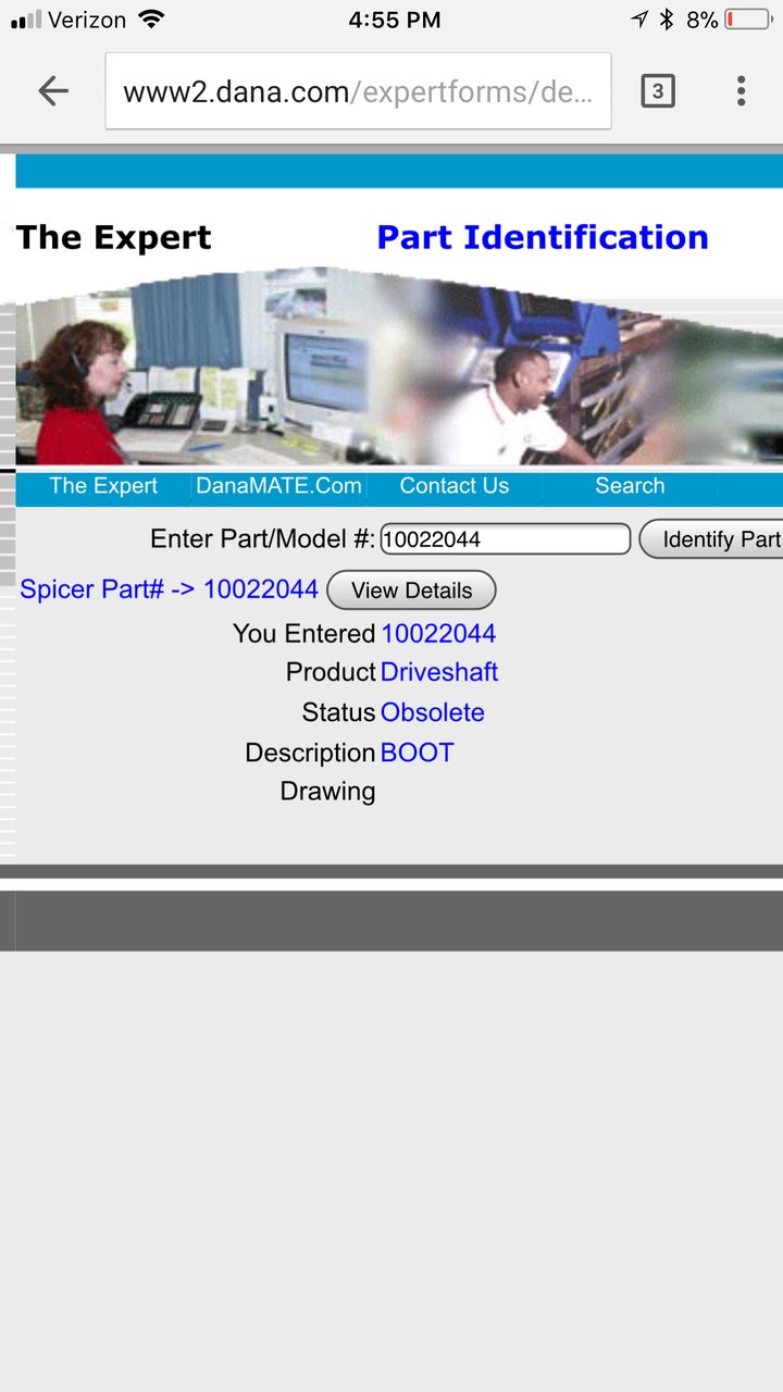

    Yeah thats what on the boot and it matches when I use the Dana Spicer website http://www2.dana.com/expertforms/departid.aspx
    It's weird because that is prob the part number for Dana Spicer and it shows obsolete when you put that number in on that website. I was told by my toyota dealership they can't order the boot separate and we have to replace that whole drive shaft.

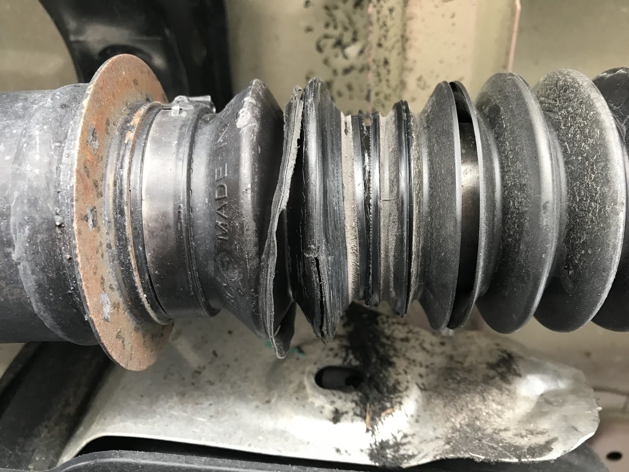

    Just noticed that this happened to me but I honestly don't know when it happened. There is grease splattered all over near the driveshaft that has attracted dirt so it could have happened a while ago.
    Is it bad to drive around like this? Does this need to be fixed and regreased?

    If you look in the original pic, there are witness marks on the fuel tank heat shield. It easily get bent backward and can tear the shaft boot. I recently caught mine just before damage occurred.
