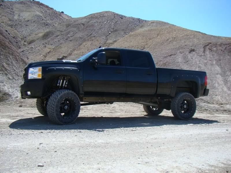

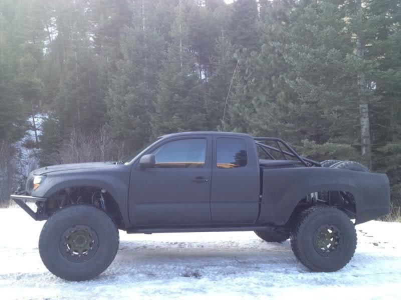

    I'm running 37's no problem on zero lift with a chaos long travel kit. Just have to trim a little. Drop bracket lifts will fold up like a lawn chair under a fat girl if you are hard on them, especially the way pro-comp and fabtec design them. You are also not gaining any wheel travel or performance whatsoever and really just getting the "look" with the added benefit of being easier to tip over than stock. That being said, my wifes chevy 2500HD has a DB lift (cognito, a very strong db kit designed correctly) and she loves it, but it's a disco truck and pretty much helpless in the dirt.

    Dare I say that, that is a sexy Chevy.

    I bet you don't say that after a couple miles of washboard road!

    username...I would bare your Tacomas children....just sayin' :laugh:

    Ok, that's just ridiculously sick! :bowdown:
