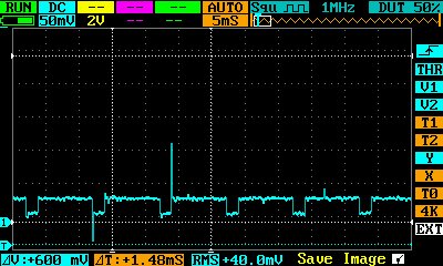

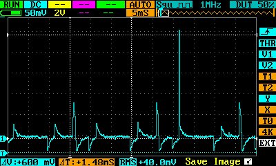

    I too want to know what the drl line exactly does. I realize this is not an engineering forum so I don't expect people to question how things work and just simply accept things as is. But I'm sure there are quite a few other curious minds out there.
    I need to borrow a 12 pin flasher to reverse engineer this.
    see my other thread
    http://www.tacomaworld.com/forum/technical-chat/322858-how-does-drl-signal-body-ecu-work.html
    I took your test one step further and used an oscilloscope. I only get really low voltage readings (I think these are just noise) when I examine the drl line.
    this is with headlights off
    this is with headlights on
    the voltage level is less than 0.5v, so I can't say for sure these are actual signals and not just noise.
