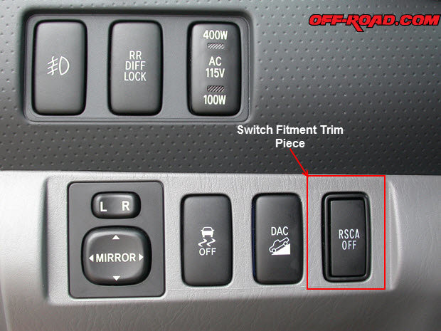

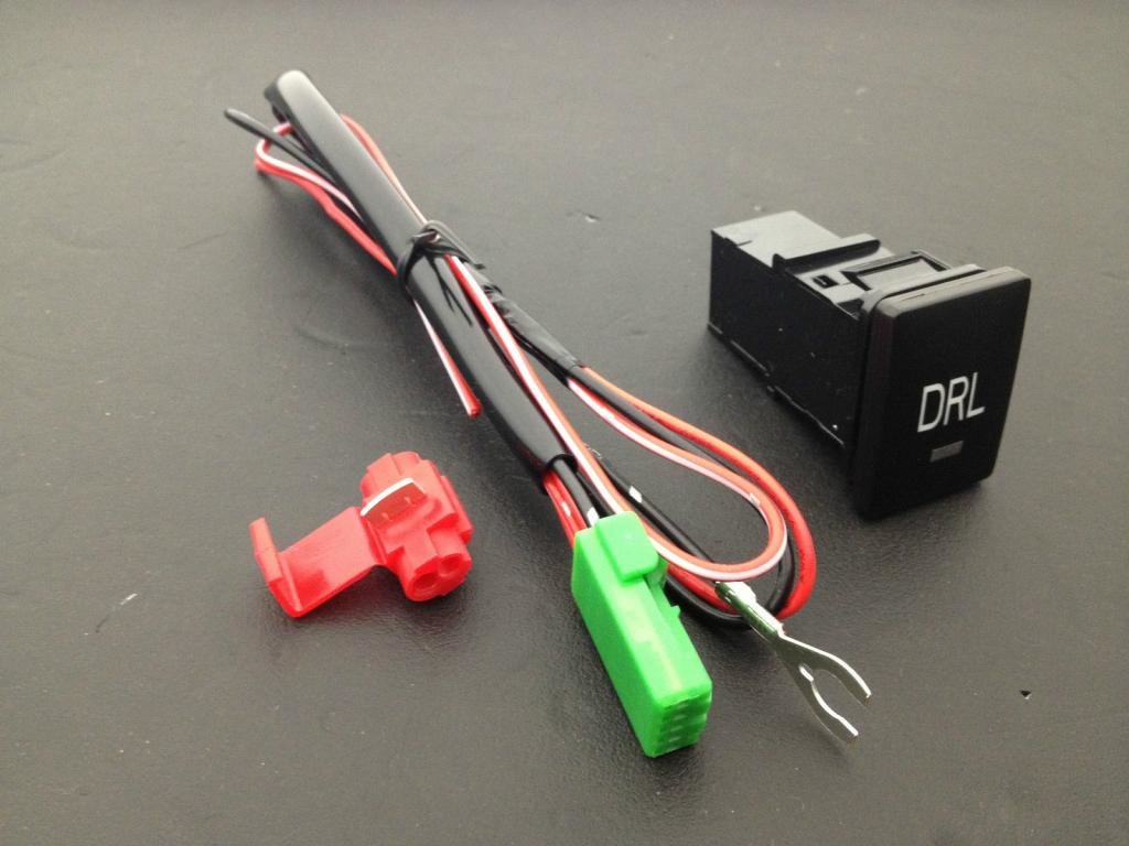

    Perhaps someone can help me out...
    I bought the following switch to perform this mod.
    However, the size is not a direct fitment to place in one of the OEM spots to the left of the steering wheel. It is smaller than the Tacoma switches.
    Is there a way to utilize this switch without any cutting or trimming? Or if so, perhaps take a blank switch cap, and use a dremel tool to insert this switch into that spot. Or maybe a trim piece such as the following... any help would be greatly appreciated.

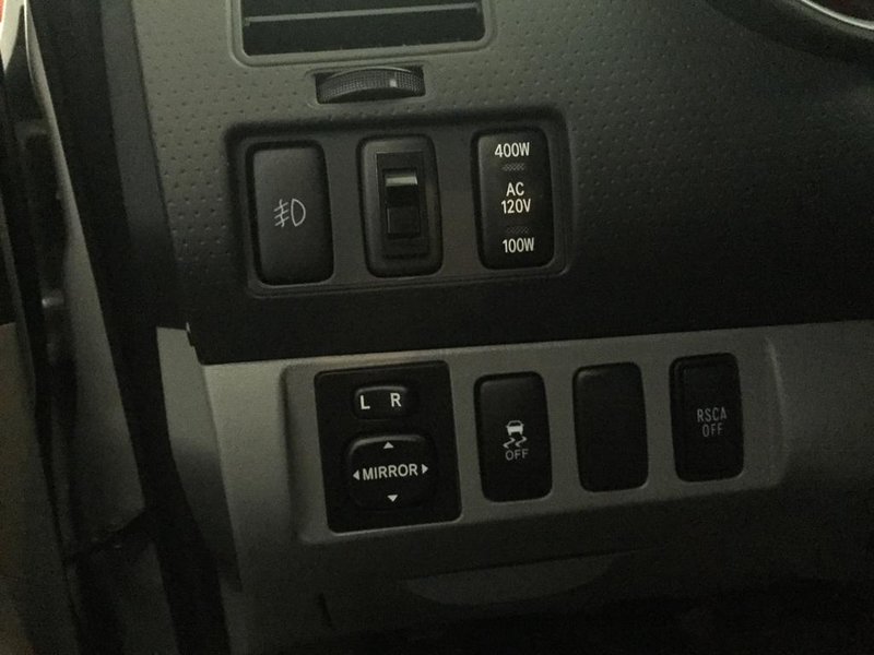

    Hated DRLs on all the time so I did the same thing to my 2012. I wanted the ability to turn them off as desired so I got an OEM Fog Light Switch. I had to cut a little inside the hole the switch goes in but after that, it fit perfectly.
    Once the switch was in and the wires in place, I found the Green/Red DRL wire and it was as described here but the other two wires were not red. Cutting the Green/Red wire disabled the DRLs but I can't get to it to splice in the switch.
    After I got the switch in and wrestled with the splices, I saw this thread that shows how to remove the fuse box and I should be able to get to the harness this way: LINK
    Parts needed:
    -OEM Toyota Fog Light Switch Part Number: 0050-35976
    -22-18 Splice Wire Connectors
    -22 AWG wire
    -12-10 AWG .250 Tab Vinyl FM. Disconnect
    -Wire Stripper
    The next day I FINALLY got the switch in, wired and working! Does the orange light come on when I press the switch? - No. Do I care? No. The DRLs can now be turned on or off as desired and that was the goal.
    Not really knowing the best way to do this, it was a royal pain. Once I figured out the best method, it was not that big a deal, you just have to really be flexible to get under the dash and have a lot of patience. Detailed instructions are in the linked threads but here is how I did it:
    -Remove the bottom dash
    -Remove the 3 bolts holding in the fuse box and unplug as much as you can
    -Position the fuse box so that you can remove the harness
    >Do NOT try to splice in the switch with the harness attached, trust me, it's almost impossible to get to.
    Once the harness is removed, you can EASILY cut and splice the Green/Red wire
    What I did to make things easy is splice 12" extensions onto the original Green/Red wire.
    This way, you can reassemble everything and leave the wires hanging out to work with.
    Once everything is reassembled, trim the wires and splice the switch into the harness. The wires can then be tucked into the fusebox. There may be more efficient ways of doing this but I'm not a pro and it's working now.
