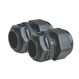

  12. Mar 11, 2019 at 1:14 PM
    #2352
    tacoma16
    tacoma16 Well-Known Member
    Mar 15, 2011
    #53109
    11,212
    Peter
    Ontario
    Double cab SR5 4x4
    I drilled a hole and used a big grommet from Home Depot like the one below.
    Used 1/0 all the way from the engine to the bed. I drilled through the composite bed.
    SR-71A and Manfred like this.
