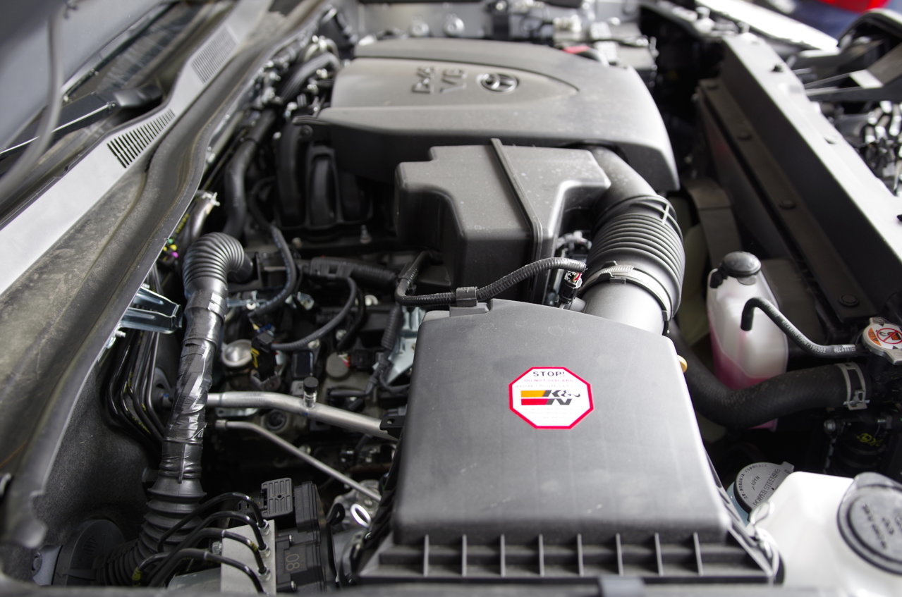

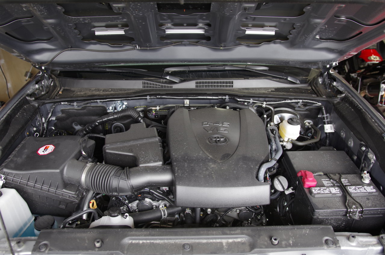

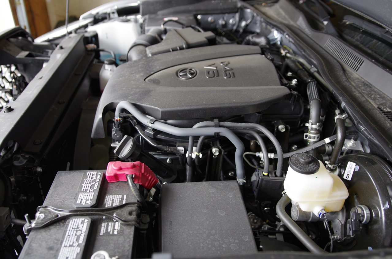

    He's got that extra doohickey in that spot next to the airbox which would prevent a battery from fitting there. My truck doesn't have that.

    Here ya go, from three angles, left/center/right:

    Its the ABS module thing.
