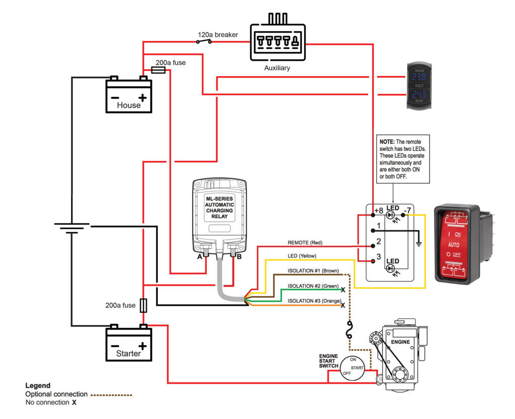

    Hoping to ask for some help checking my diagram. This is a foreign language to me and my brain struggles with it. Think I got a good draft but really could use some help. I'm unsure of the fuses and breaker pertaining to needing fuses and the correct amperage for each.
    Thank you!

    The layout looks right to me. Instead of fuses near the batteries, I went with these circuit brakers.
    https://www.bluesea.com/products/7149/187-Series_Circuit_Breaker_-_Surface_Mount_200A
